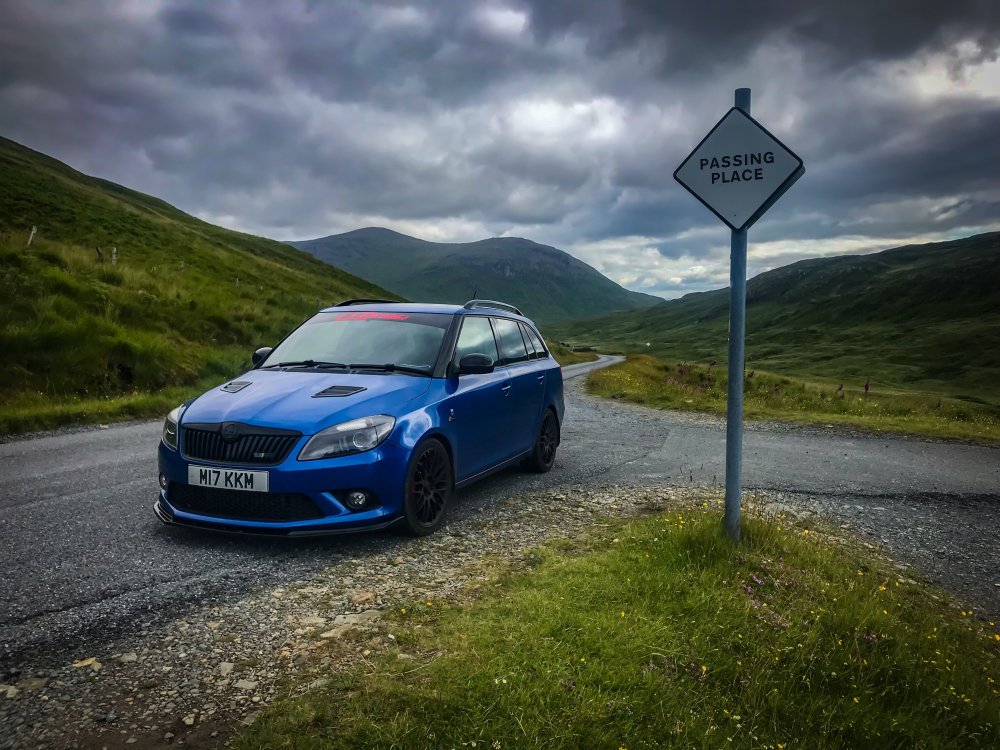

As said above, Mot history checks etc......The price of the MK2 FABIA VRS is almost laughable, I've seen 2012 models got for under 3.5k privately. The estate/combi suits me as its the best of both worlds, Only downside in my opinion  is the handling although that can be somewhat sorted but a new anti roll bar and lowering springs.
Don't expect a comfy ride as even standard they're pretty harsh, here's mine albeit a bit modded and mid life crisis.......
