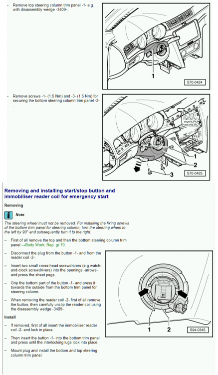

Hope the attached helps (you don't need to remove the reader coil, the button can be removed out of the unit through the reader coil).
The button slides out, towards the outside of the car (i.e. away from the steering column, not inwards towards the steering column).

Thanks Wokwon, much appreciated.  Will take a look over the weekend to find the screws to be removed and also try and source the part required.  When I get round to the job I will take a few pics and post them up.

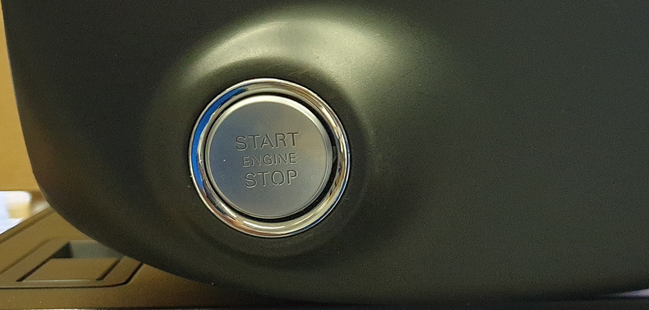

Hi TasMan - thank you for the detailed pics - my Superb is also being a bit sticky on the trigger - it doesn't have a problem with starting or turning off, its just the effort needed seems to be greater than

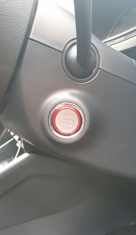

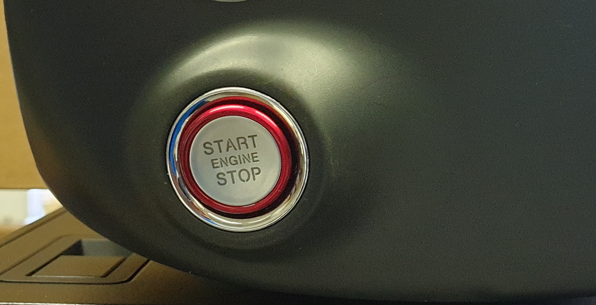

Hi Everyone,
Came across the post and was lucky enough to find a very cheap start stop button on ebay (£5 delivered) so thought I would give it a try.  Nothing was wrong with my original button and the reason I did the swap, was to see what a different button would look like and I thought I would share my findings.  Thanks again to TasMan for his detailed write up which made the decision to attempt the swap much easier.  The part I used was:- A Genuine Audi A4 8K B8 S-LINE Start & Stop Keyless Comfort Switch 8K0905217 which came with the silver cap.  I also purchased the red and silver cap from Ali Express, although you can purchase them from ebay for similar prices.  I have the black and red trim so thought I would see what the red and silver button looked like, you'll also notice the replaced button lights up in red and not the traditional green.  Here are the pictures:-
The only difference I've noticed so far, when depressing the button, you have a click which you didn't from my original.
Again any mods are carried out at the owners risks.

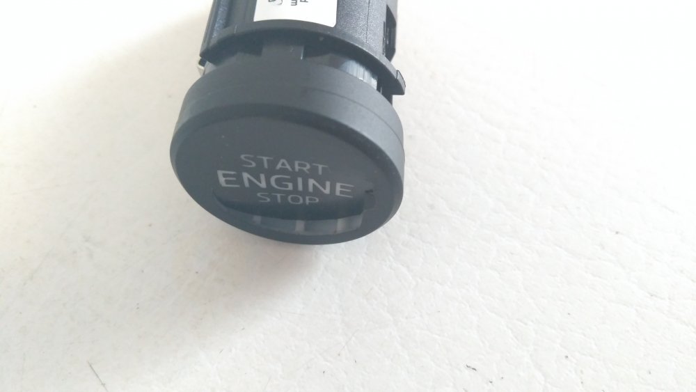

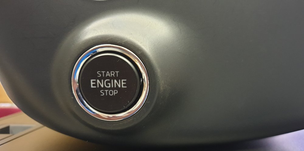

Mine was getting to the point where I pushed it too hard and the front disc started to tear (see photo).
So ordered two from the place in the Czech Republic (last one lasted 4 years hence an expectation that the new one will only last that long as well) and they arrived 3 days later.
They use a UK VAT number so nothing else to pay.
Just fitted it in about 90 mins, including looking for tools I forgot to take out, following the instructions on here.
The metal ring around the switch popped off the housing with the switch still on which made it a little easier.
When I tried to push down the silver side lugs I didnt manage it and one popped off but it looks like it was slotted on so if you are looking to repair the switch, it should slip back on OK.
All in all a reasonably easy repair and now the slightest touch starts the engine.
