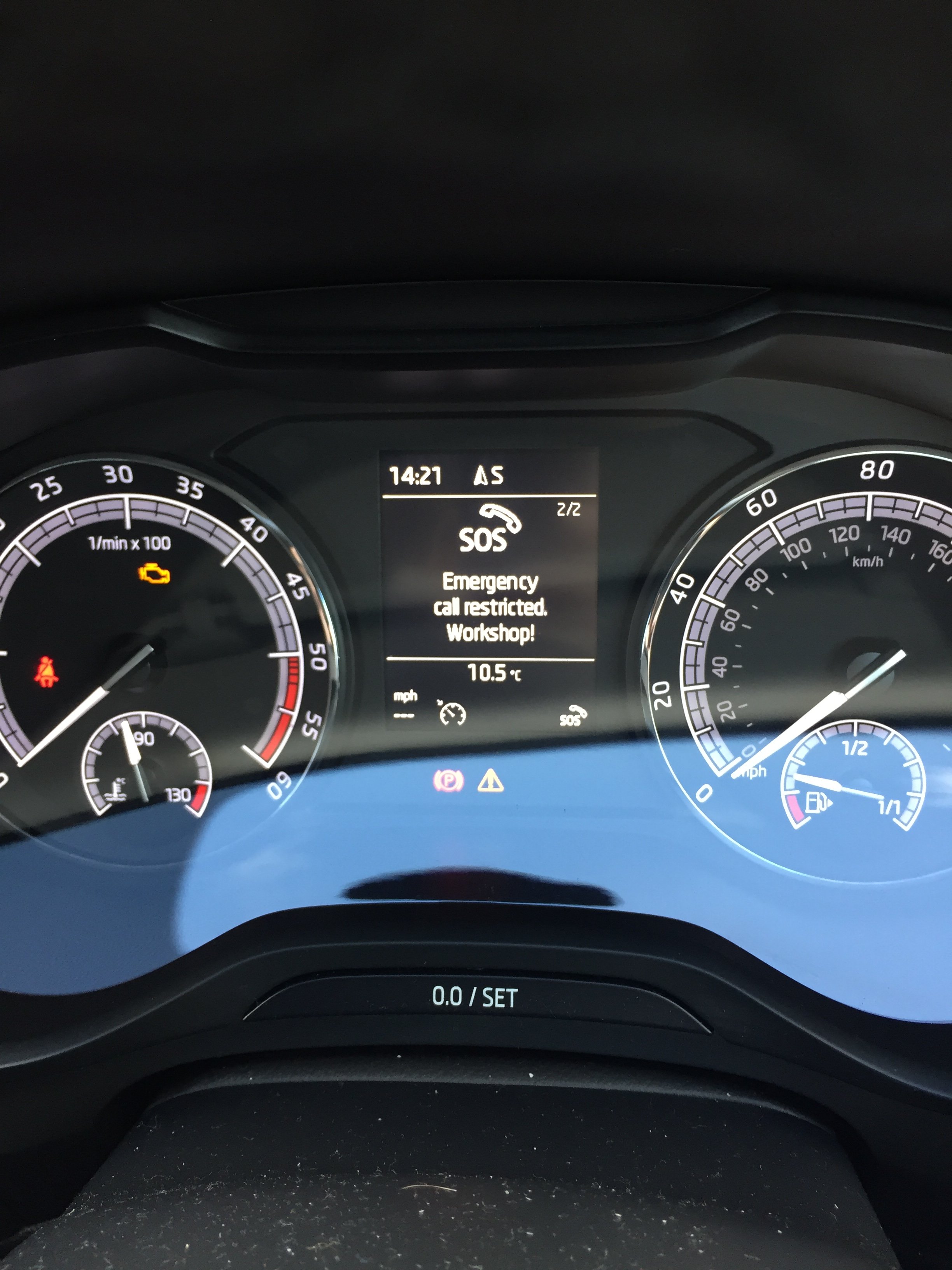

Error message has appeared on my Kodiaq dashboard saying Emergency Call Restricted Workshop and my connect app stopped at the same time.
i have it booked into the garage as it’s only 10months old.
anyone else had issues with this?

Skoda Connect and the SOS are two separate issues.
Skoda Connect is a complete waste of time, and has been since Skoda rolled out their half-baked, under invested, under maintained and under developed system. It is down more often than it is up.
To get the dedicated 'SOS Emergency Call' error on the central display, and to be asked to take the car to a dealer means there is a separate issue with the dedicated SOS hidden-SIM.
If the central SOS system was down we'd all be getting the same warning on the dashboard.
