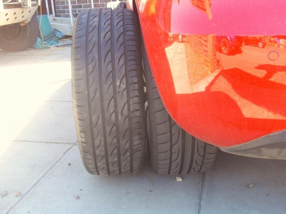

When you have 215's and 205's measure them, and compare side by side, some like a Pirelli Zero Nero 205/40 R17 can be a taller tyre than some other brands 215's, that Pirelli Zero Nero 205 can have less tread on the road than say a Dunlop Sport Maxx of the same size.

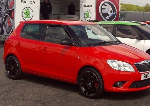

Pirelli Zero Nero 205's on the outside both pictures, 215's on the car on the front & 205's on rear.
