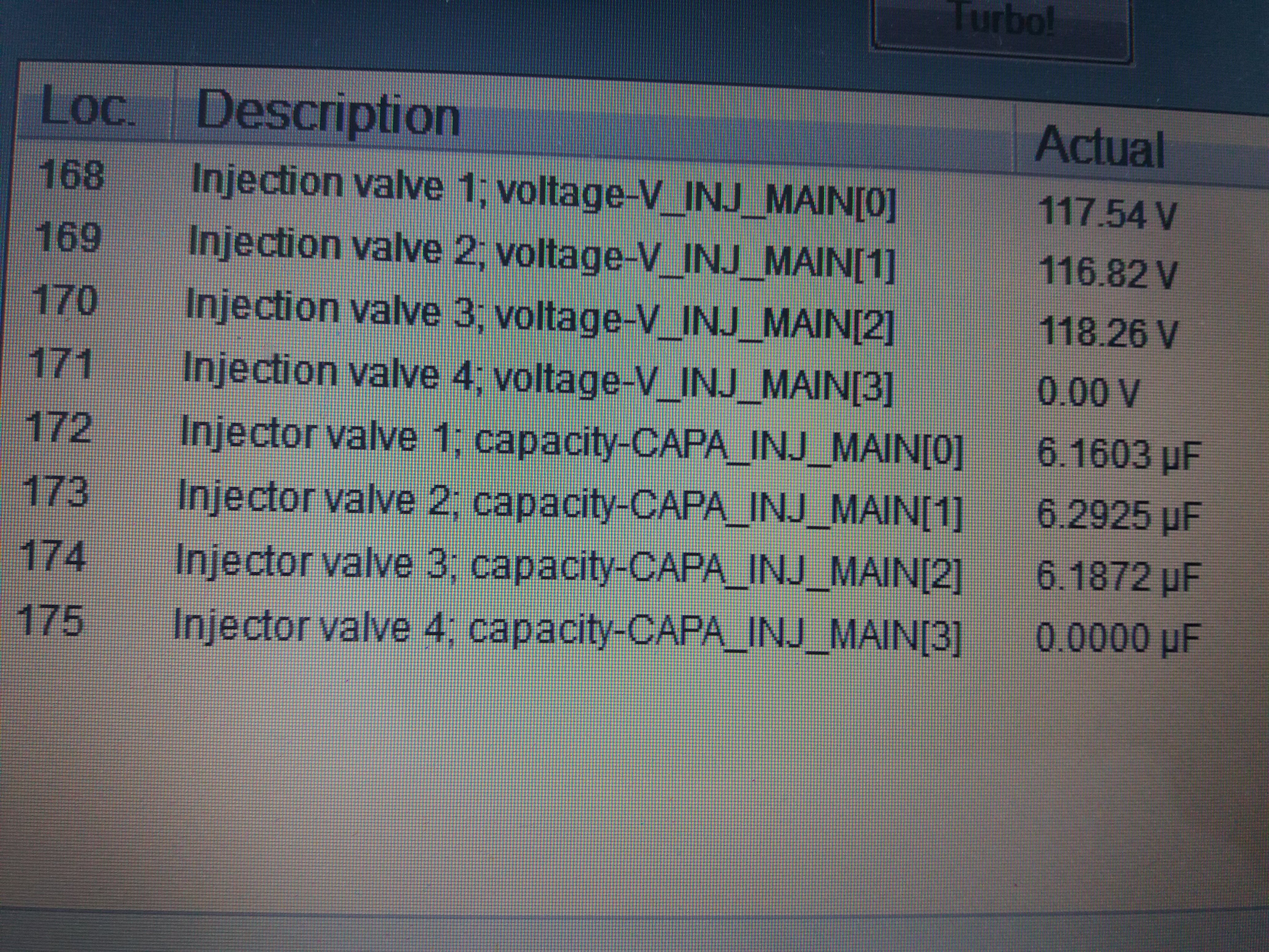

So a bit of a up date done a compression test and all 4 cylinders came out about the same 320psi ish plugged in the vag-com and got this
Also found a loose injector which would explain the fuel in oil,
