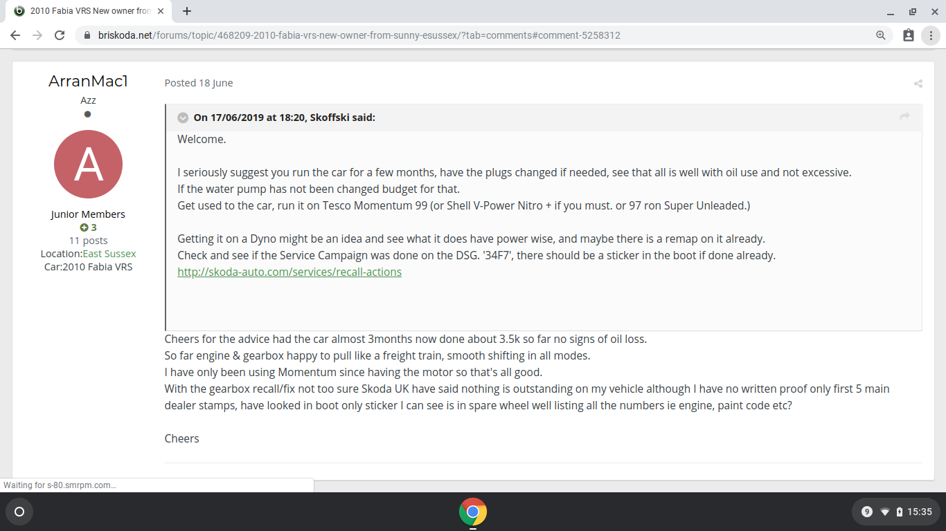

Maybe not much wrong.
So first off best check the Spark Plugs are all good, that is all 4.When were they last replaced?
You could check or have a check done for Fault Codes, but the misfires if you have them might not be logged.
You need it out of limp mode anyway.
How many miles on your car,
is it all standard,
any updates under warranty,
breather mod or software work ever done,
original engine etc etc ?
Has the water pump / supercharger magnetic clutch ever been replaced?
What you described can be the water pump and now the turbo is disabled.
EDIT,
Did the plugs get changed, and have you remapped it?
Edited by Roottootemoot
