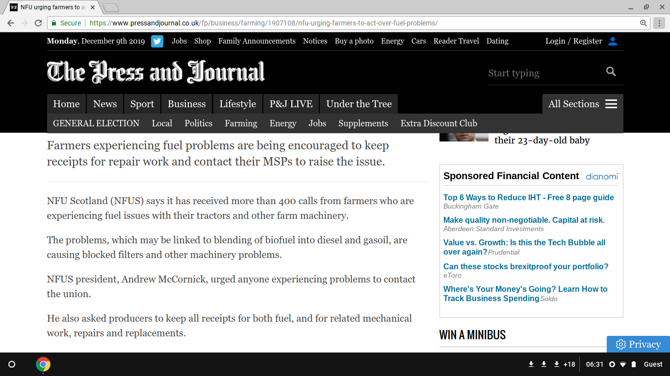

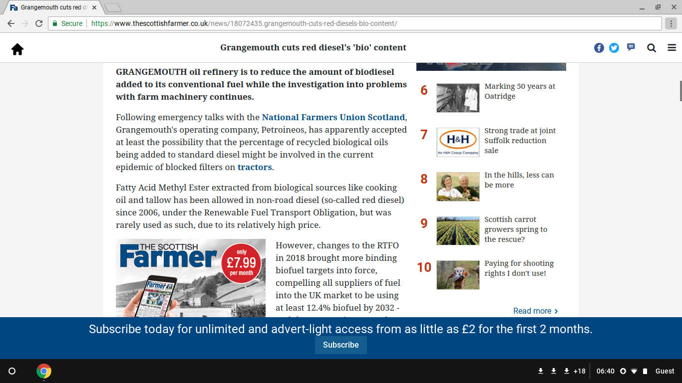

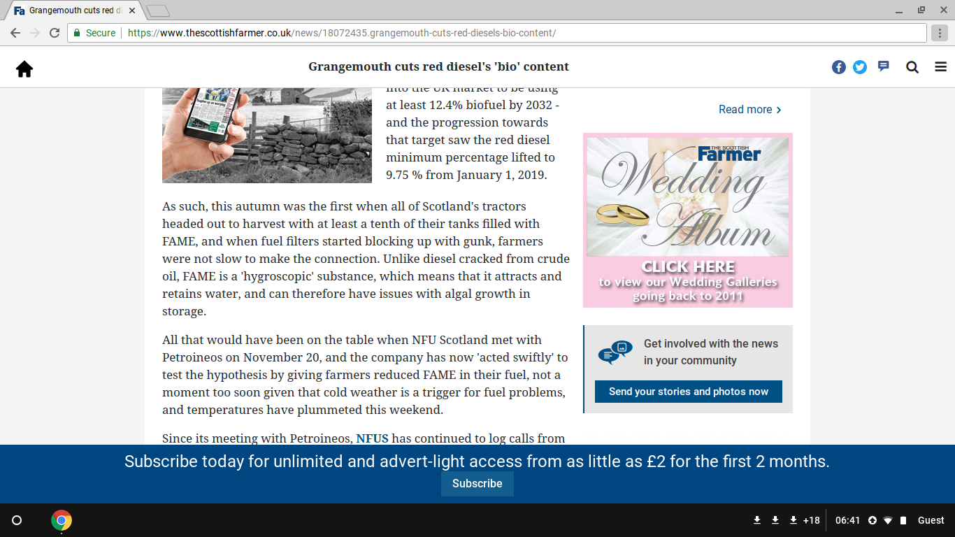

The increased percentage of Bio added to Red Diesel has been causing blockages with tractors and machines being used in low temperatures or just being used as normal..
Many have their Red Diesel supplies in and need to now get rid of it and get new in with less Bio in it.
Not only an issue on farms but where farmers are contracted to do gritting and snow clearing.
