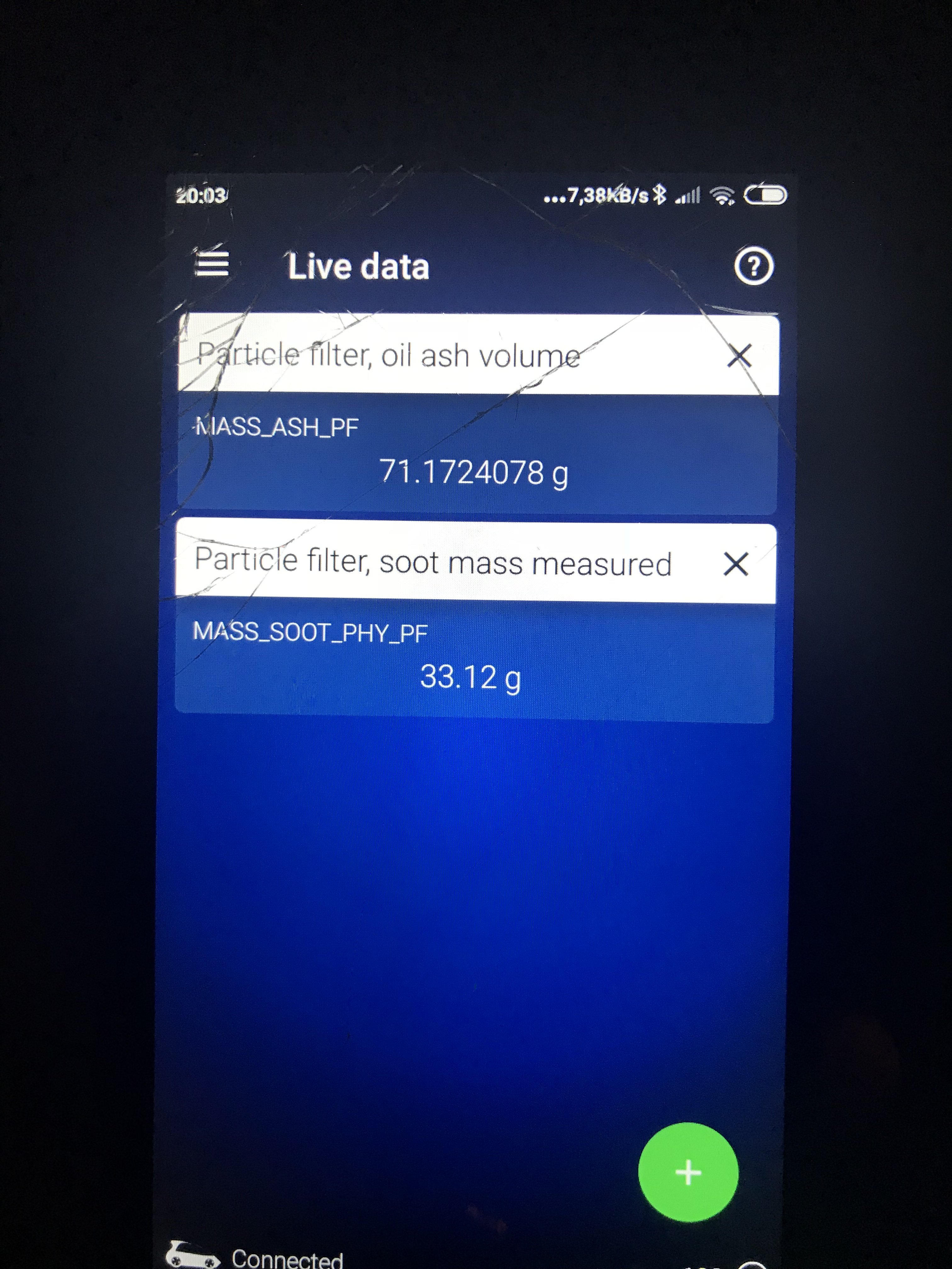

Hi All,
My old man’s yeti had the dpf light up along the with the eml light and flashing coil, i ran a scan with obdeleven and came up with the details below.
is it too late to take he’s motor to a garage for a forced regen?
i think i read somewhere that once the dpf is passed 95% full you need to replace it.
any help is appreciated.
