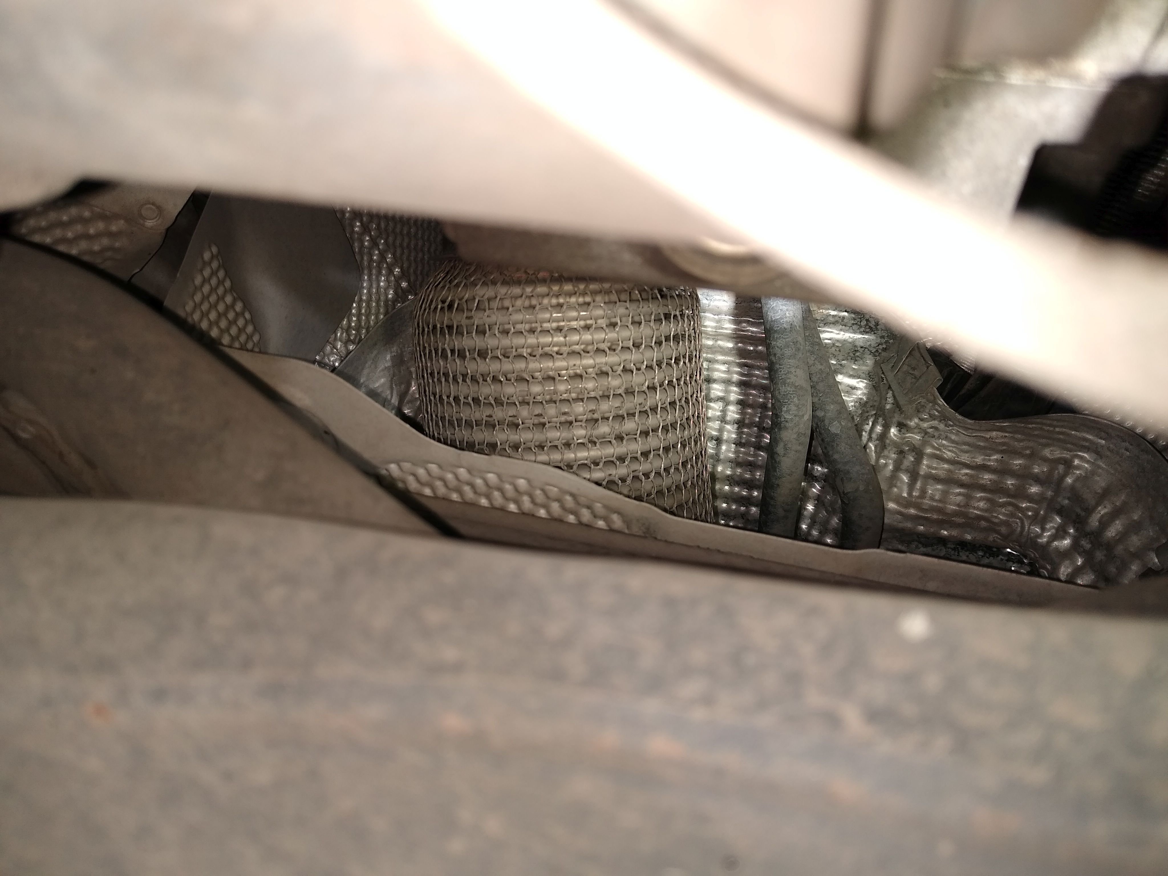

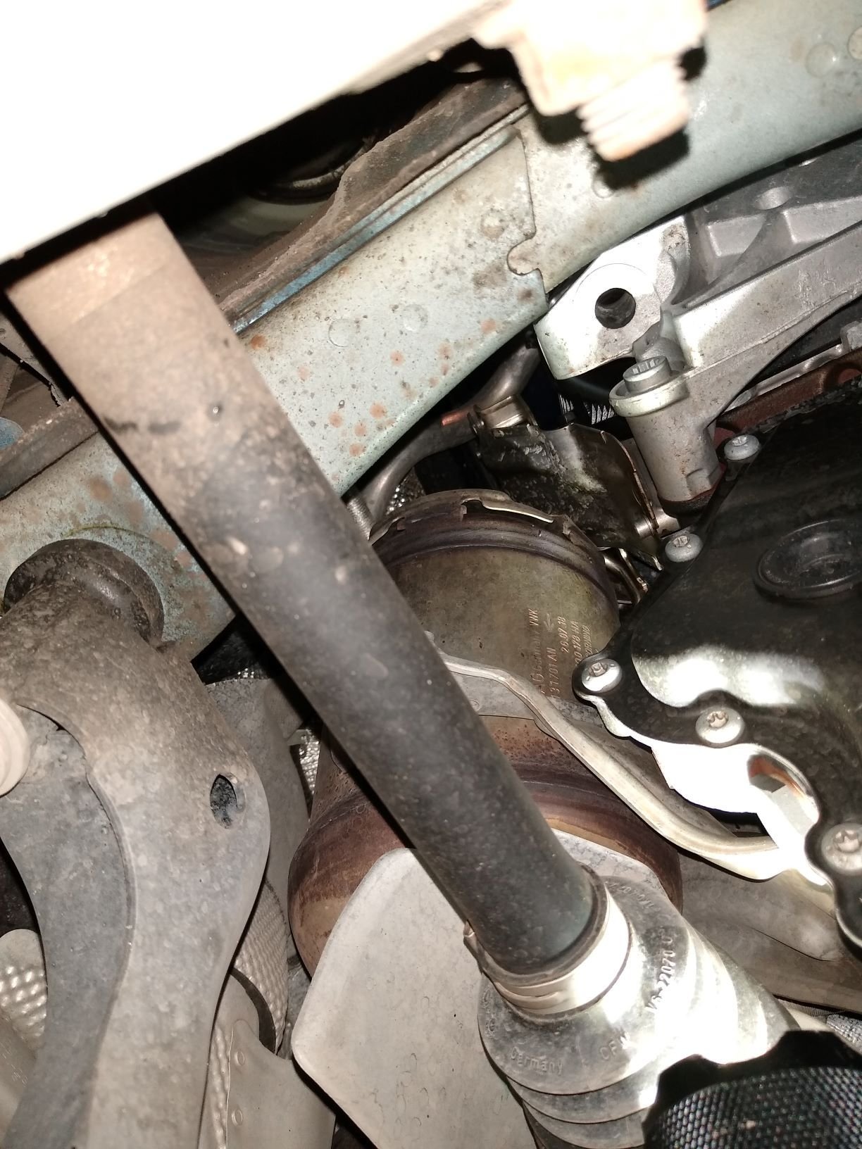

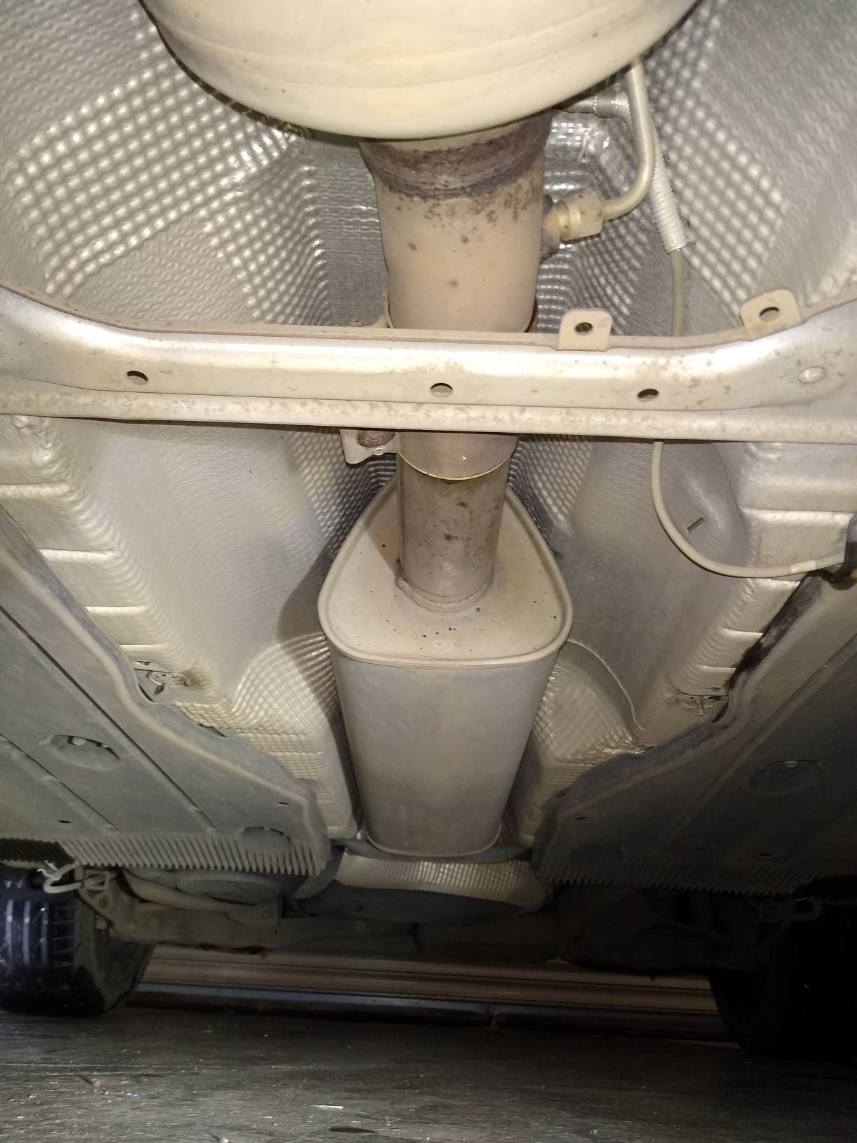

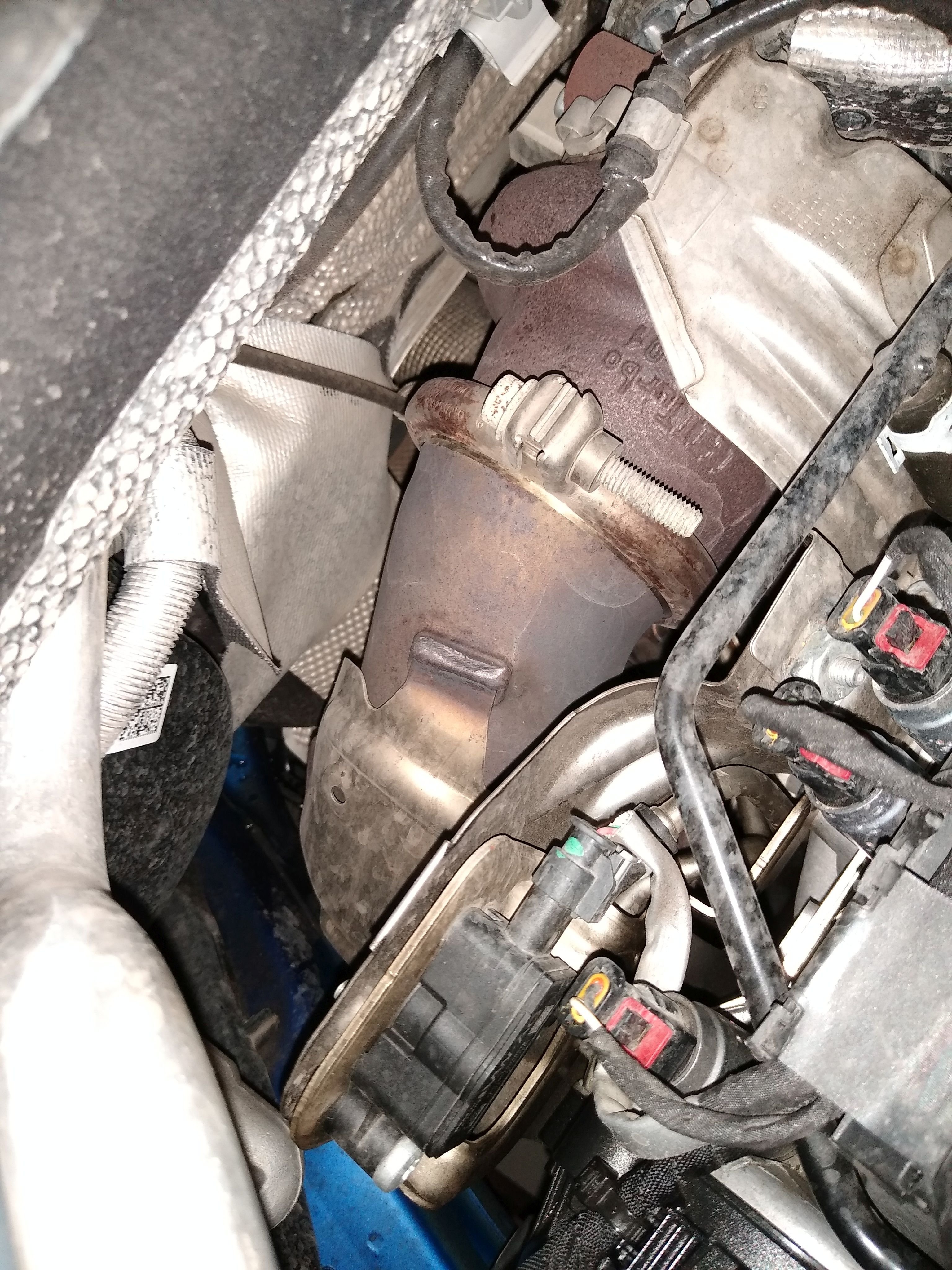

I've now looked at and under the car and taken pics. The first one is the turbo and the top of what could be a combined gpf+cat. The second is that same thing from underneath, it basically sits above the RHS drive shaft. Next comes a flexible coupling/bellows. Then a pot that could be another cat (or something else), it is roughly in the middle of the car. Then a "triangular" silencer. After that the pipe splits in two, and then there are the end pots just before the tailpipes - didn't bother taking pics of that.
This whole saga is triggered by the engine warning light having come on a few weeks back, and the Skoda garage saying it was the DPF. When I pointed out it is no diesel they stuttered something about a temperature sensor. At that time I hadn't even heard about a GPF. All I want to be able to understand is there a GPF on my car and could this "clog" and then trigger a code which lights up the engine management warning.
