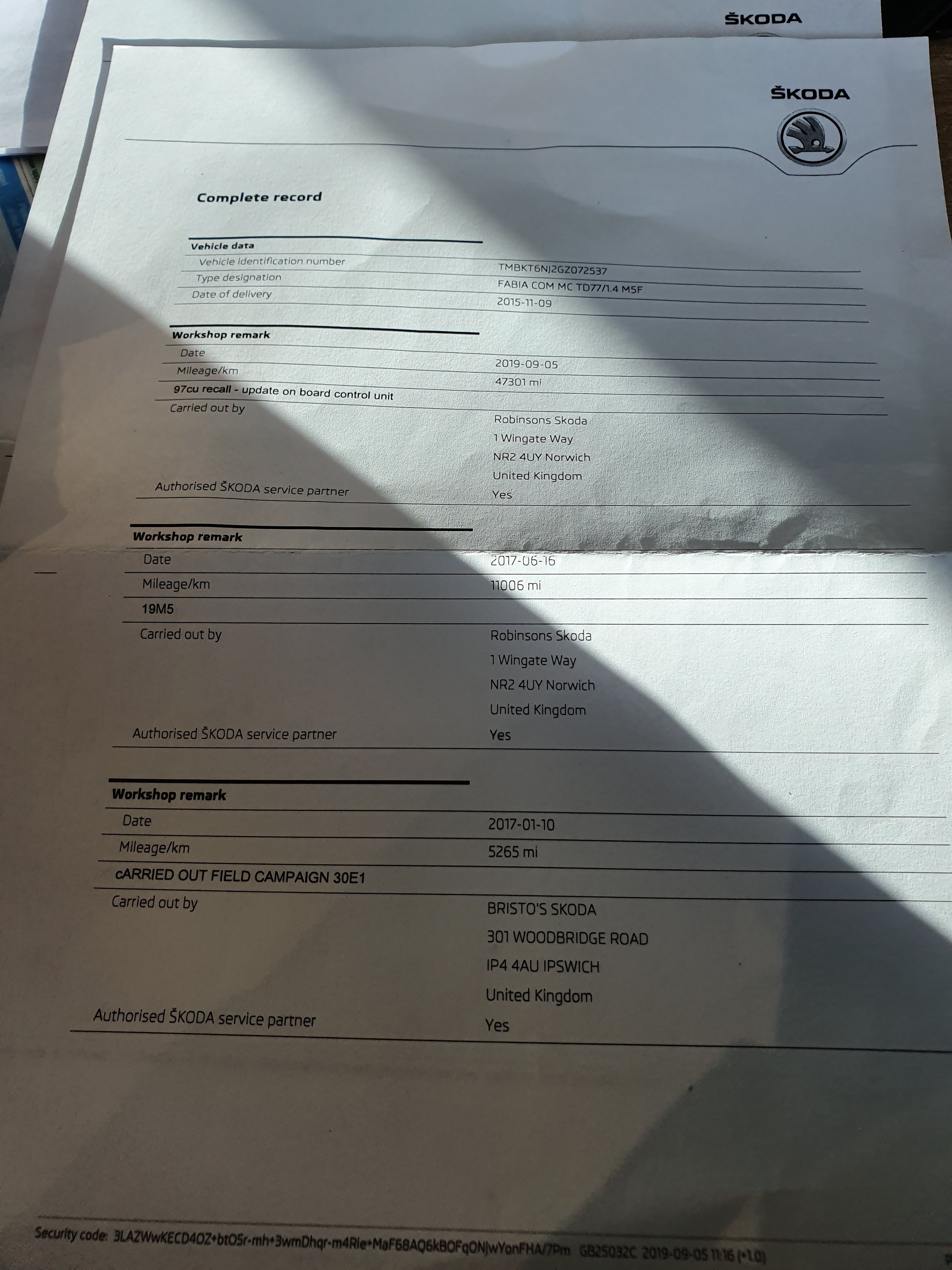

My wife has been rather taken by a 2015 Skoda Fabia Estate Mk3 2015 1.4tdi Monte Carlo which I believe has the CUTA engine code (see line 8 of attached). This is to replace her Suzuki Swift 2010 SZ4 as our 5 week old sons pram is too large for the boot meaning the carry cot needs to go on the back seat and it is simply not practical. I have a 2006 Mk1 Fabia VRS which I am smitten with and so rather like the idea of the Mrs also having a Fabia.

Can anyone do me a favour and tell me how many pages your service booklet has? We went back to see and test drive the car today and all seems fine but the service booklet only has 7 pages and I suspect that it has had pages removed for some reason. It has 4 services at an independent garage and the attached paperwork detailing recalls to Skoda:
- 97cu recall is fuel software
- 19m5 is coolant and an online chat with Skoda confirmed they replaced the coolant and not the pump
- 30e1 is clutch pipes
My 2014 Citigo service schedule book has 7 pages and the part no on the back cover is 1ST 012 720 SG covers all models and has the date 05.2014. This is almost certainly the same one as yours.
Edited by peter3197
I think this was changed when all servicing records were switched to on line records. A dealer can search the service history simply.
When I purchased my "previously owned" Fabia MC, it came with a printout of the service and recall history. I'd like to think this was done for the owners' conenience, but I can't help thinking it's to encourage us to use Skoda agents for all our servicing.
