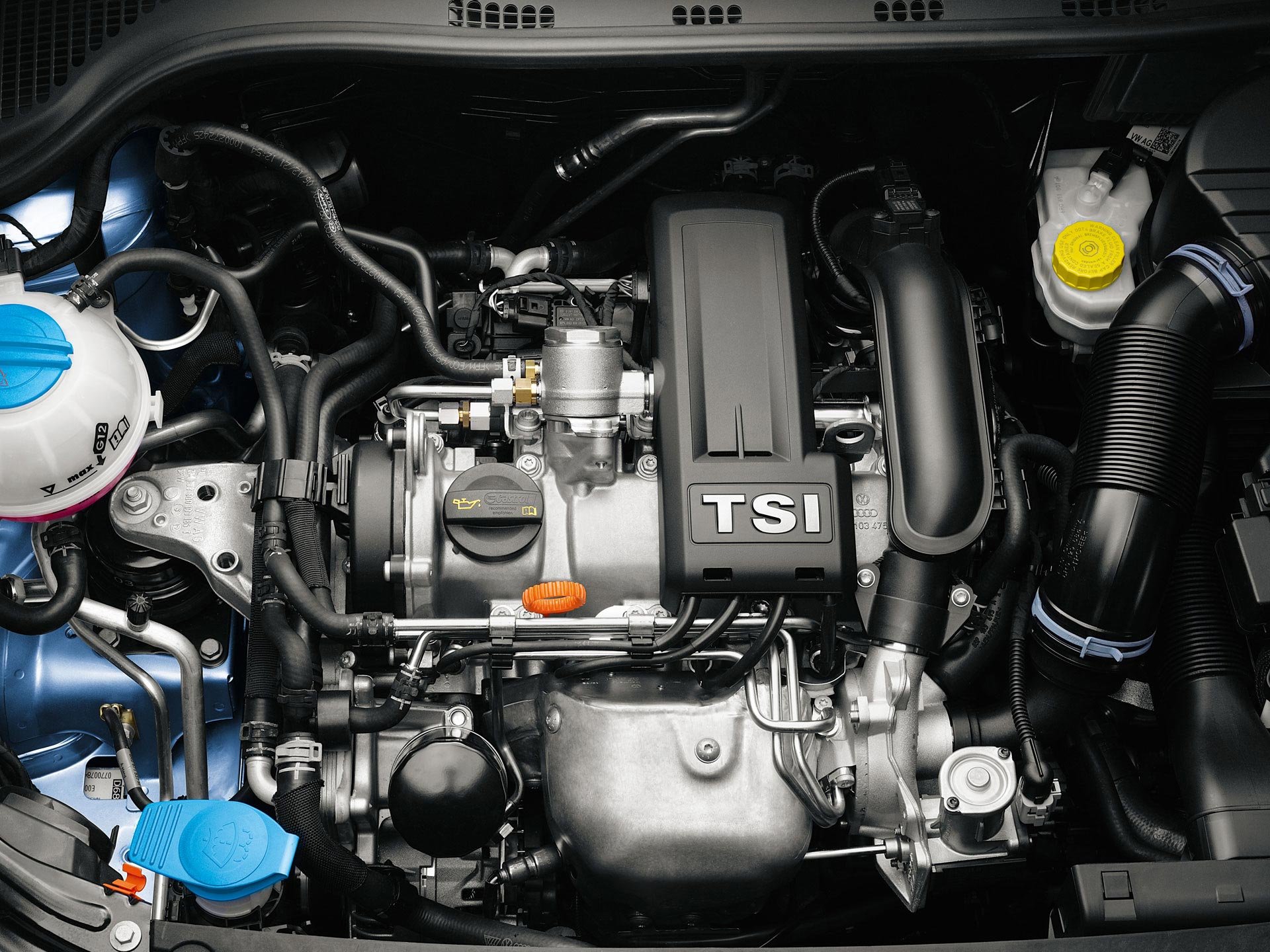

Can you post a photo of the front of the engine taken from just above the radiator?
Is it a 1.2 HTP or a 1.2 TSI?
If it's the 1.2tsi, it's likely an incorrectly fitted oil filter, old oil seal washer left behind

This is what a fabia 1.2tsi engine looks like. Yours may have a silver oil filter opposed to the black one shown here at the front left of centre.
