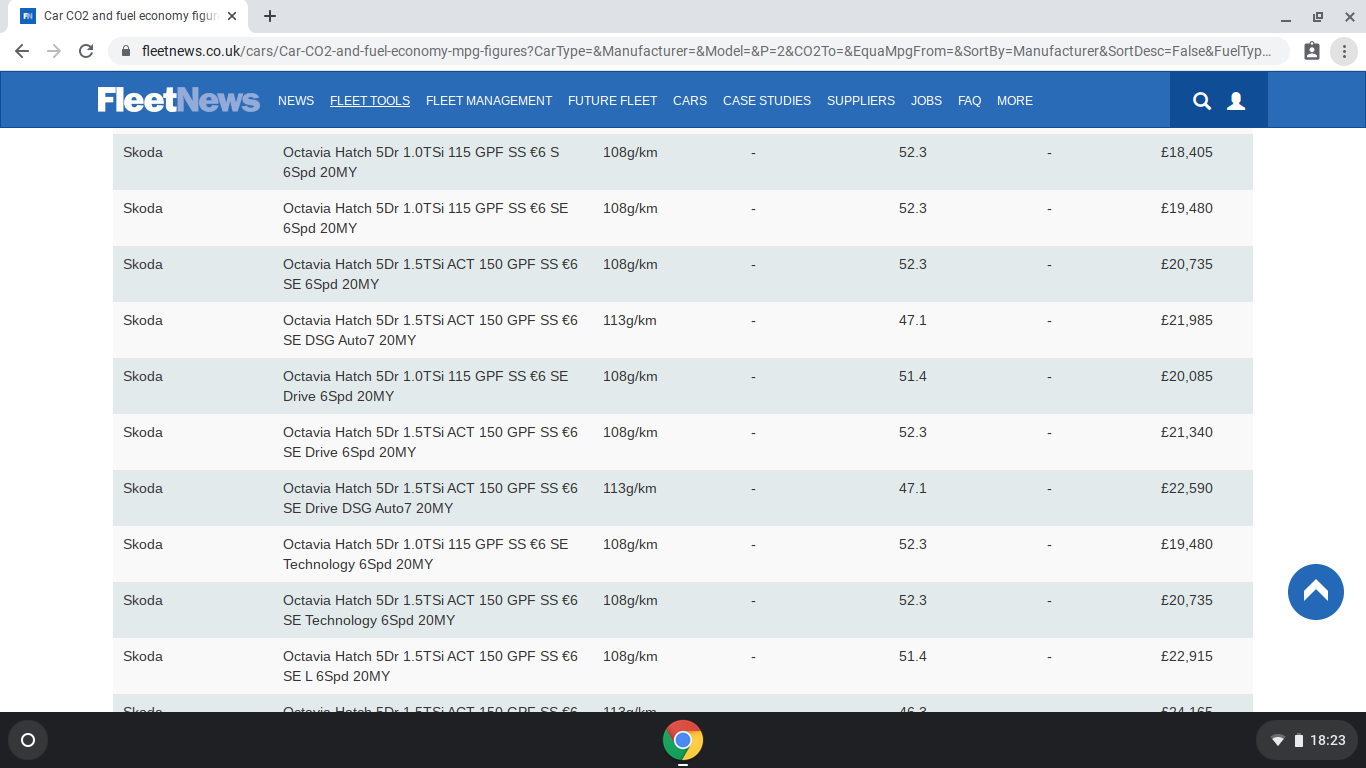

3 minutes ago, Roottootemblowinootsoot said:
@Kental
I would ask Skoda Customer Services again in writing and ask if they are checking with the Technical Department or Factory on the information they are giving you.
The guy took my details, chassis number and confirmed the exact spec of the car including the model year.  He was away for over 5 mins before he came back confirming I didn't have one.
What is your model year MY20 ?

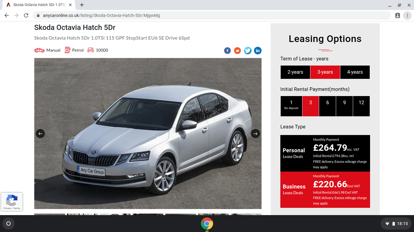

Yes, to my knowledge, build date 11.10.19

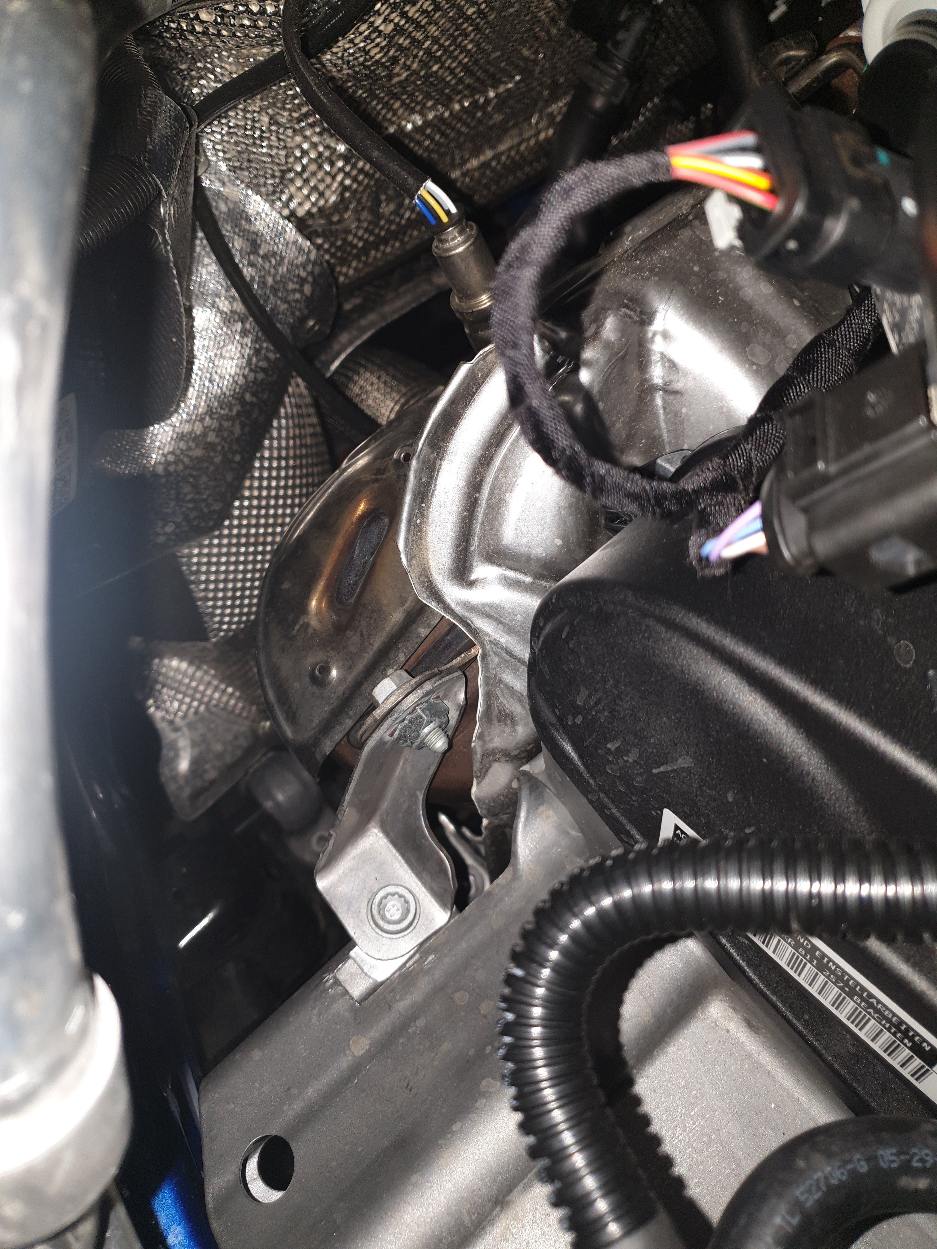

Morning, ive had a look round mine and I can see the gpf on mine, it's not a great picture but it's at back of engine underneath a heat shield. It looks like a cylinder and when you fire car up after 20 seconds it's already red hot so can presume it is that.
Are you sure the isn't the Cat.  Silly me for trusting what Skoda UK told me
Edited by Kental
One call handler / receptionist asking another call handler receptionist about cars is not a great thing.
They really might not even know what a GPF is.

If you watch that skoda video earlier in thread you can see it's the gpf and the cat is further down system but it all acts as a three way system

I recontacted Skoda CS & they said the Octavia 1.0 does not have a GPF, the 1.5 does & the 1.0 in other applications also does.  They said the tank to the rear of the engine is the Cat.  This was confirmed with technical.
