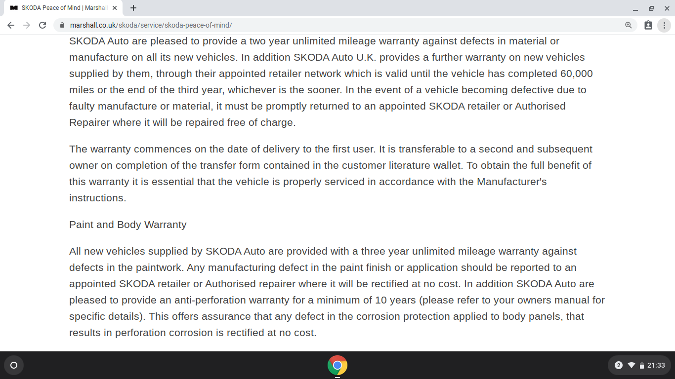

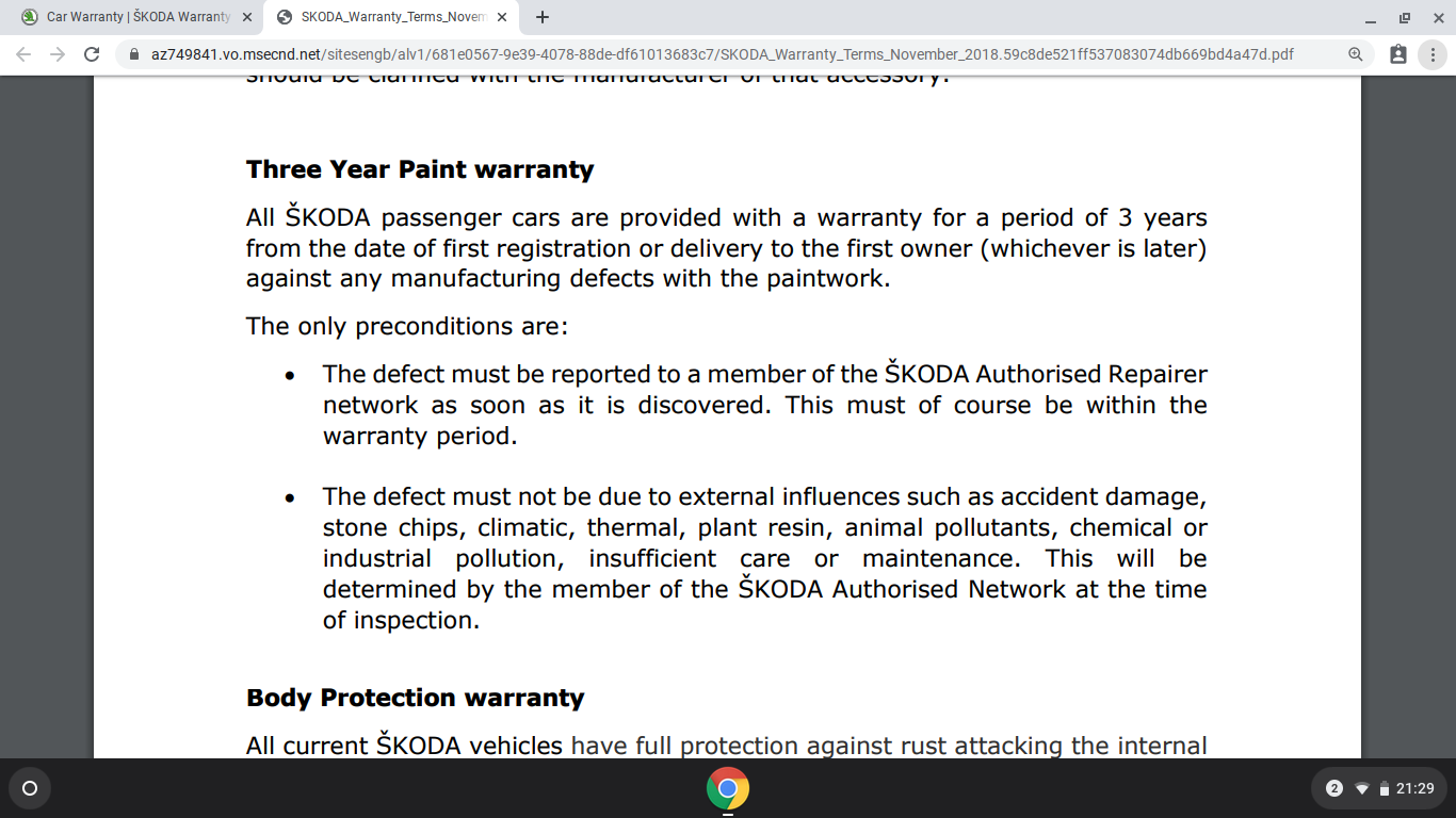

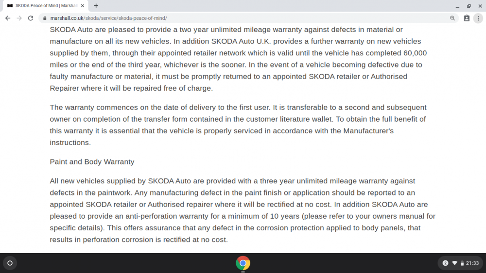

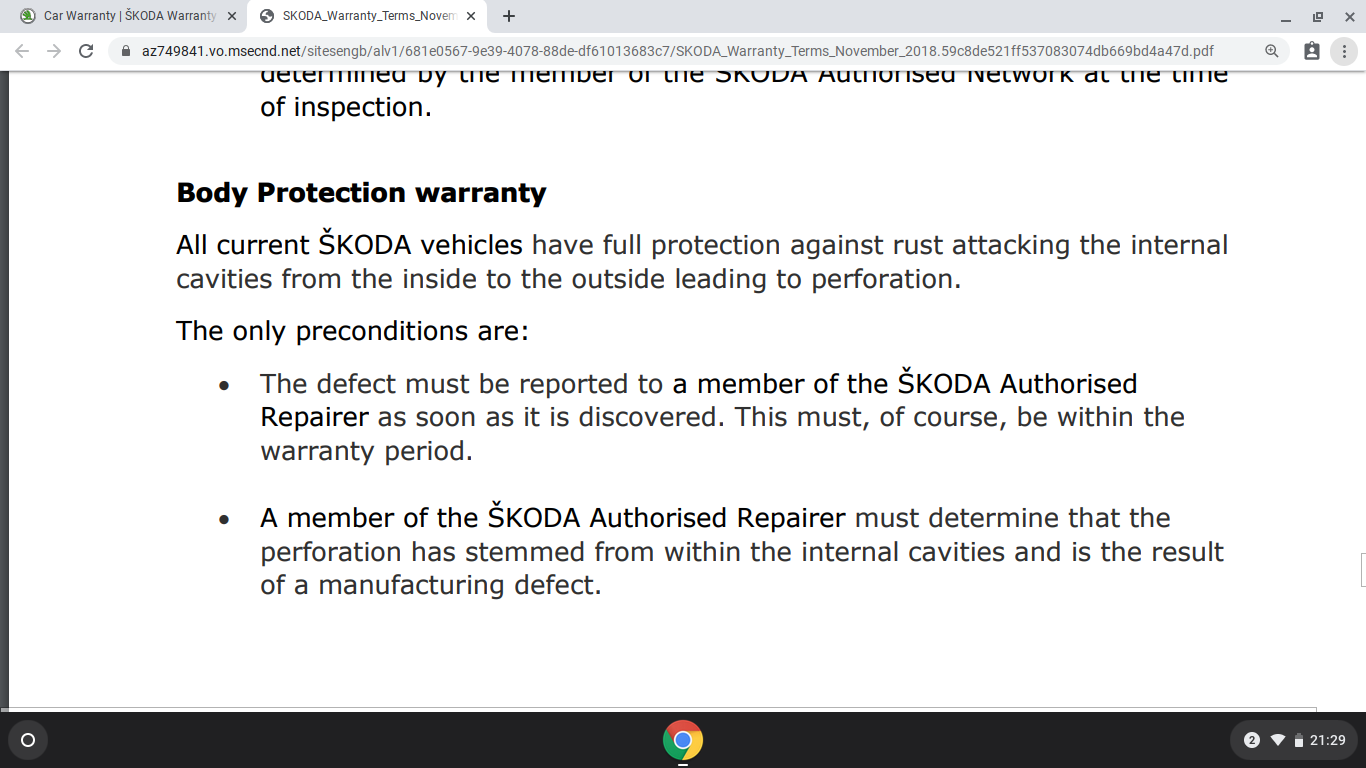

The bodywork warranty is 12 years. I'd take it to a main dealer and let them inspect it. This must not be at a cost to the owner.
Colin
The corrosion / perforation warranty is on rust coming through panels and the zinc inclusion is on the surface.
(That is a paint preparation failure, so a fundamental manufacturing or materials failure.)
The paint warranty should have had the work done to the factory spec, that was not the faulty factory spec though.
The panels should have been replaced with Zinc Inclusion then finished to the correct spec, not just a cheap paint refinish job.
That has been well covered on this forum and in this section for years now.
The owners of the car originally maybe let Skoda off too easy, or the car was punted and then buyers of the used cars did.
