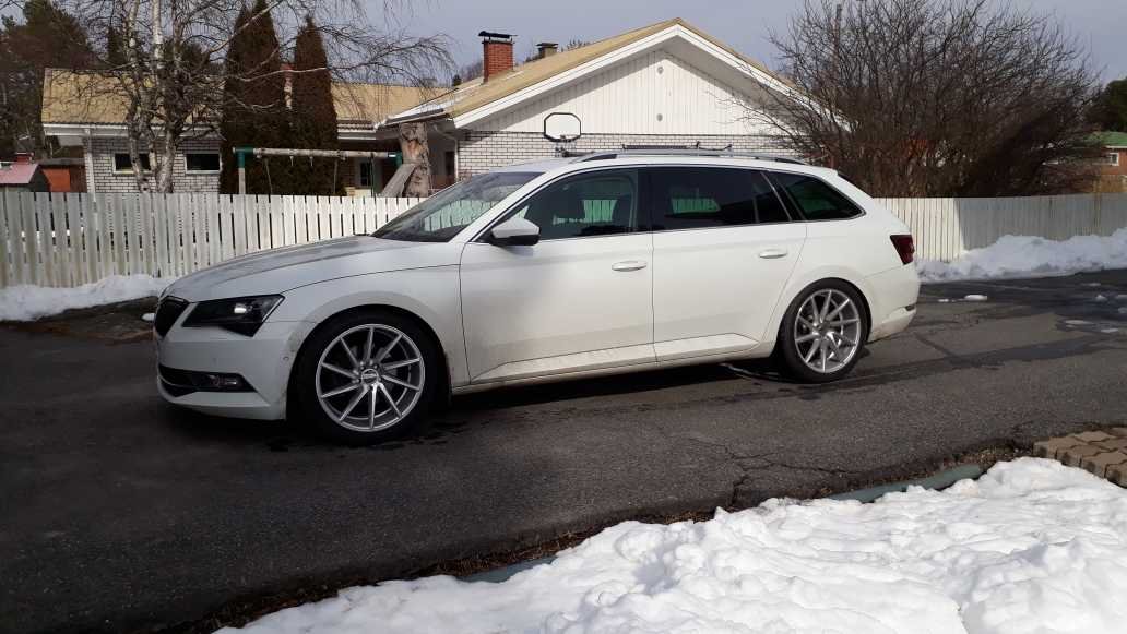

  • Now new set is in place. Size is 245/40R19. ET35.   Car needs wash&wax.

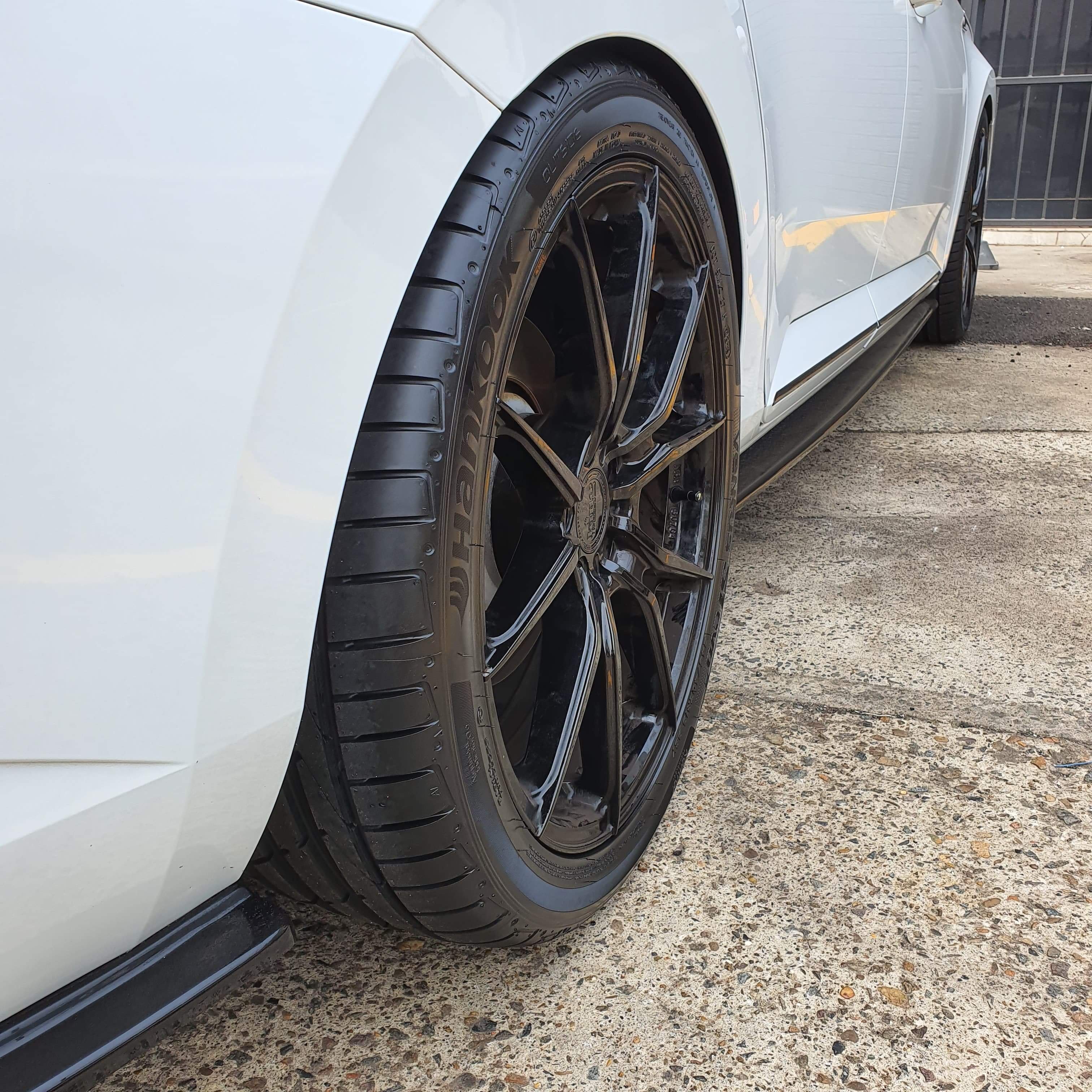

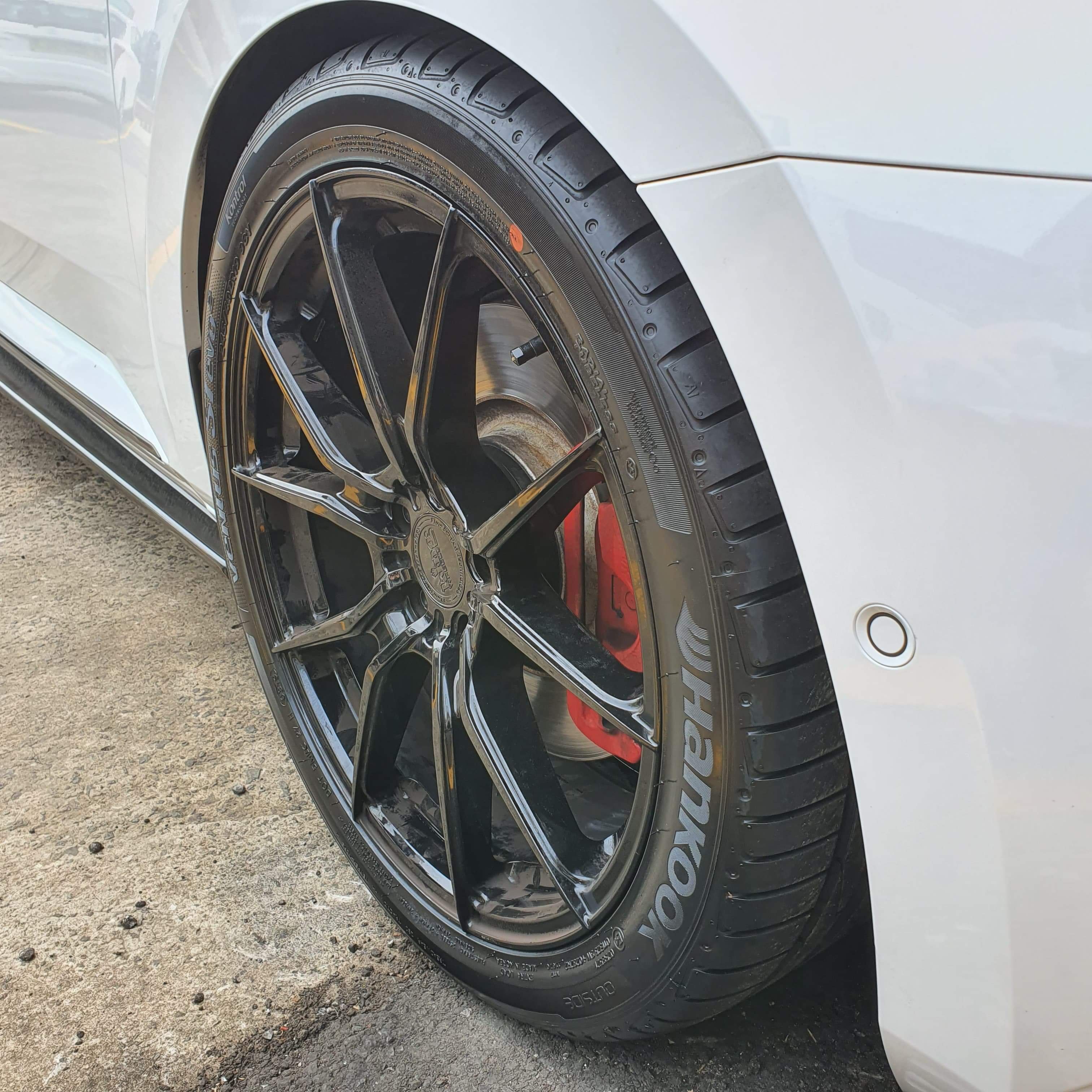

Many Superb owners here in Oz have made the switch from 235/40/19 to 245/40/19 with no issues, even with lowering springs.
It's cheaper n a more popular size.
I'll b making the switch too from 235 to 245 once my factory P7s r end of life.
With regards to 20" rims, u can do 255/30/20 on the 280 Superb.
But comfort will b severely compromised.

Some pics below of a mate's car with 245/40/19 and lowered springs.

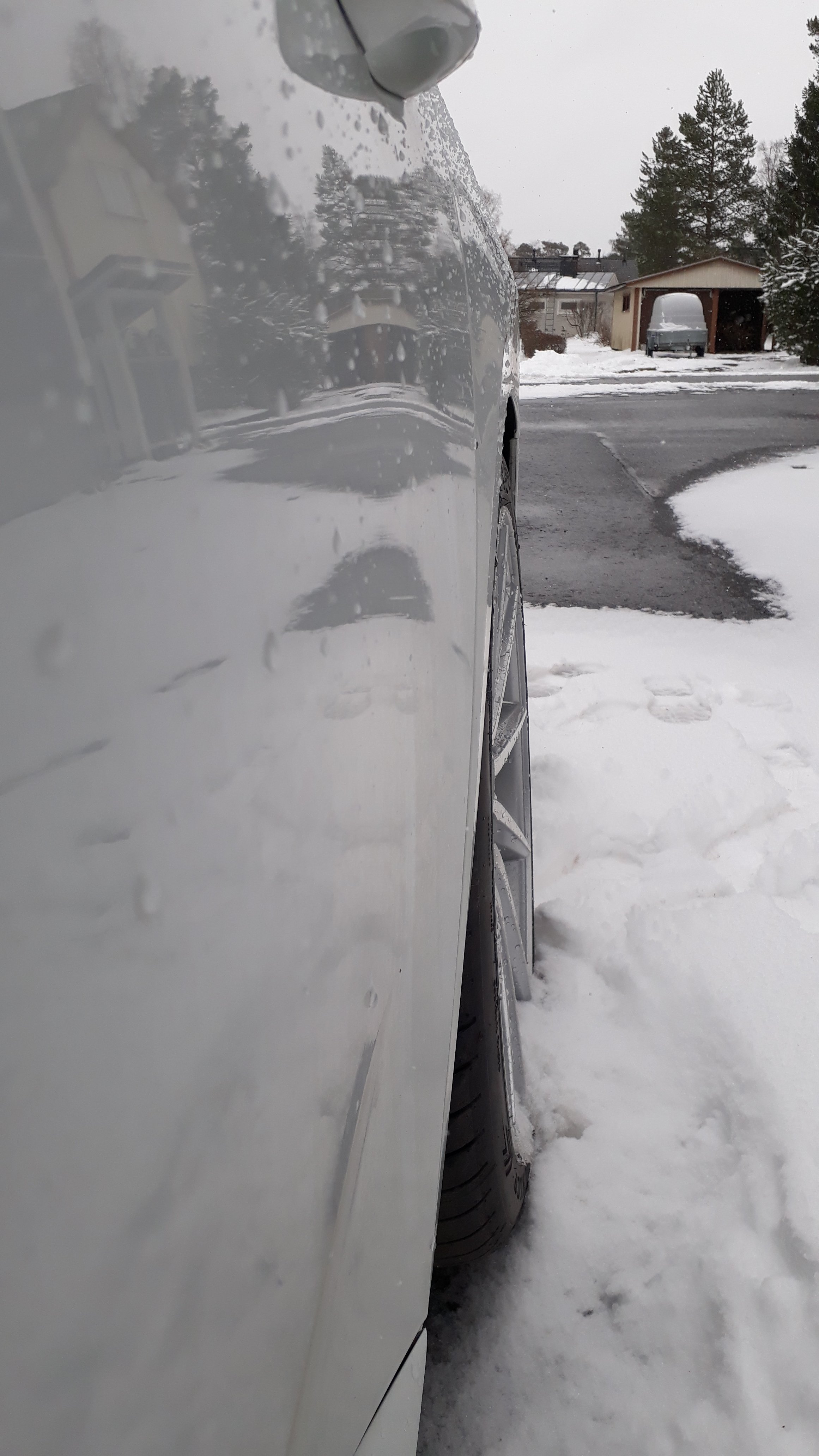

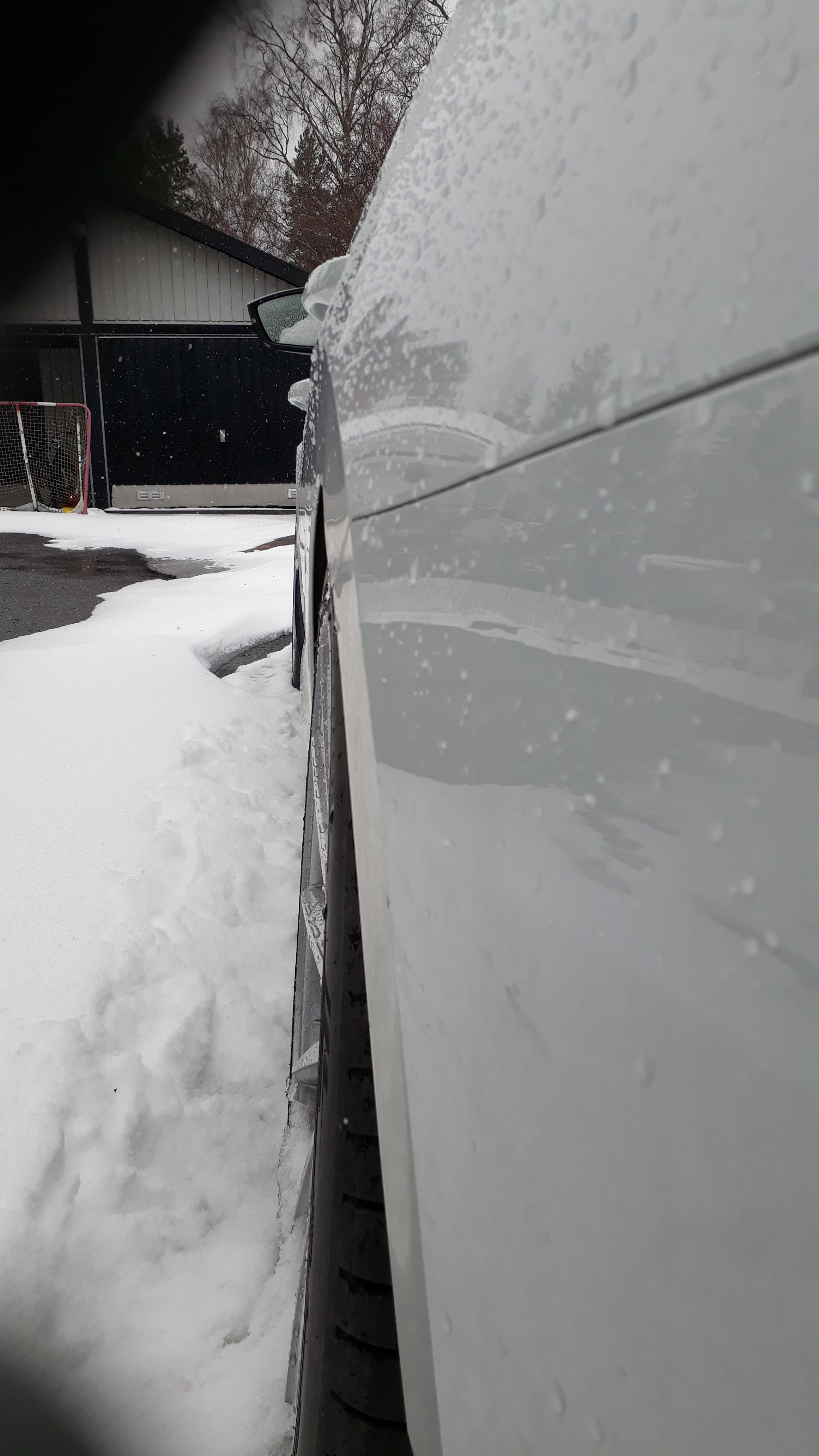

Rims are 19x8,5 ET35. I would say it will be quite a tight fit in the back with 9,5" ET35 at least if you try to keep the rim inside the fender. I can take better pics how close these are to give you better view.
Thank you that would be really helpful.
Couple pics. Hope these helps.

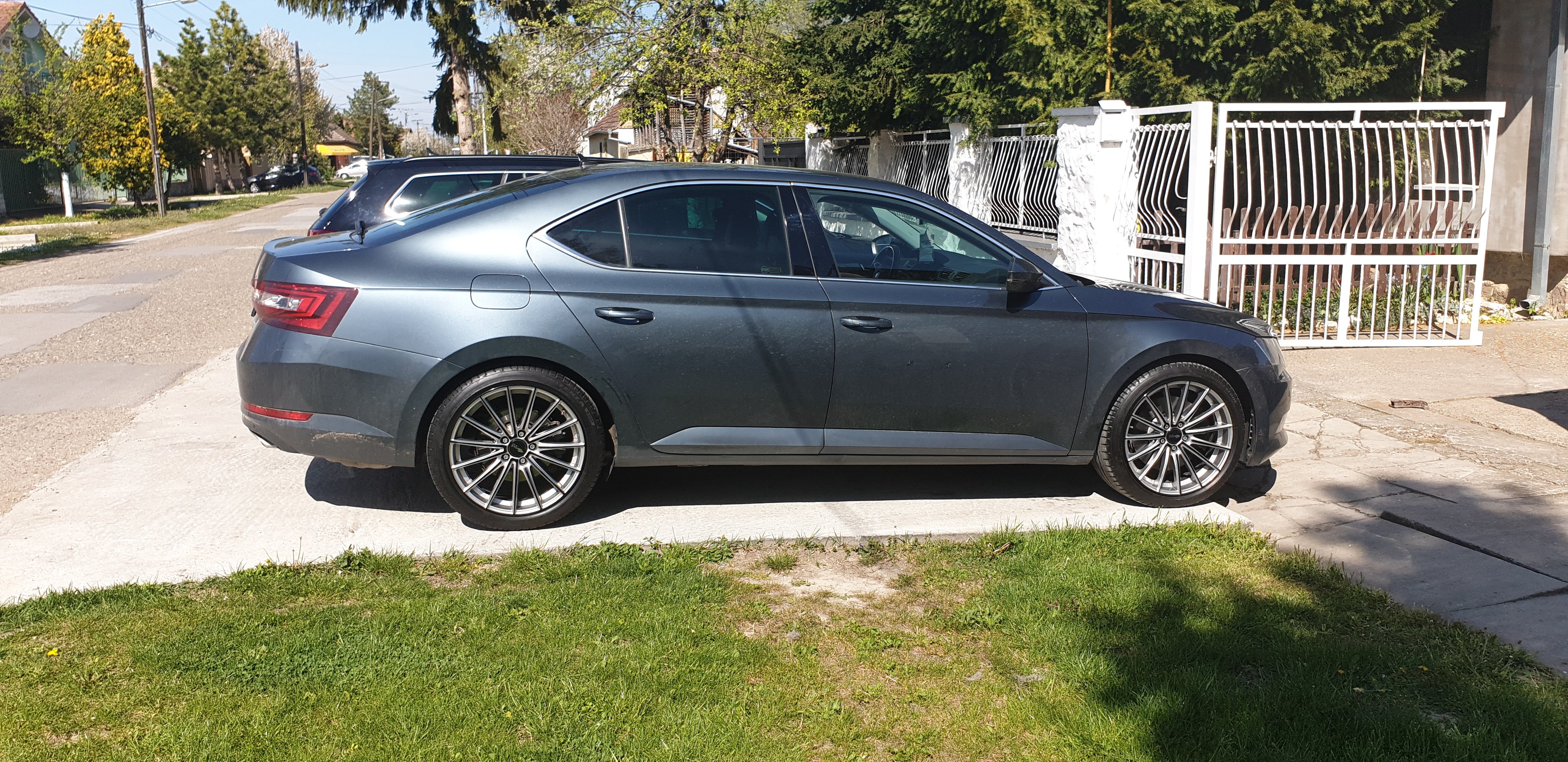

Wanted to share pictures of my new (used) wheels on Superb III with DCC.
They are Brock B36 wheels R19 8.5J ET45 and 235/40 tyres.
Will see in following days difference in comfort and handling. Tyres are used, but should be better compared to winter ones.
Unfortunately outer ring on rims is black, so wheels look smaller than they are.
Nice. I was thinking, those don't look like 40 profile tires :)
