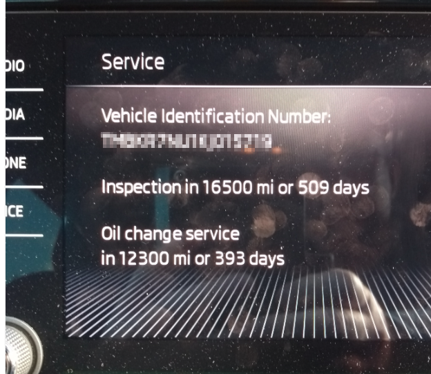

Just got around to looking at the service indicator on my July 2019 Karoq 1.5TSI SEL DSG (with 3400 miles on the clock) and it is indicating:
"Inspection in 16500 miles or 509 days"
"Oil change Service in 12300 miles or 393 days"
I have assumed that this means it is on the variable service regime and must have been set this way by Skoda UK (Original owner of the car).

What confused me completely is that the 1st Oil change service is indicated in 393 days from now then (if I am reading the data right) an inspection service at 509 days from now.  The gap between the oil service and the inspection service is only 116 days (less than 4 months later).
Doesn't make sense to me.   The 509 days - that would make it 2 years from 1st registration for the Inspection service - I kind of get that but I don't really get the 393 days to the oil change though (making it around 645 days from 1st registration)
Paul
Oil service will be the first one due at 15,700 miles according to your car, then dealer should reset it and your next service will then be an Inspection service probably around 31,000 miles in your case.:thumbup:

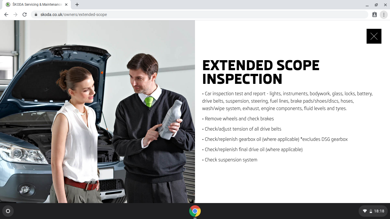

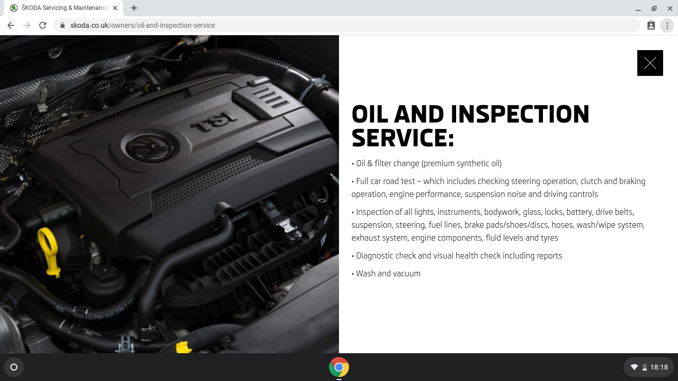

They are calling them Oil Service / Inspection Services and then adding Extended Scope.
So basically All are Oil & Filter service.  Be that on Fixed Servicing and every 9,600 miles / 372 days, or on Variable / Flexible, 18,000-20,000 / 24 months or sooner.
At each service the body inspection should be done.  There are not really 'Inspection Services' without the Oil & Filter change.

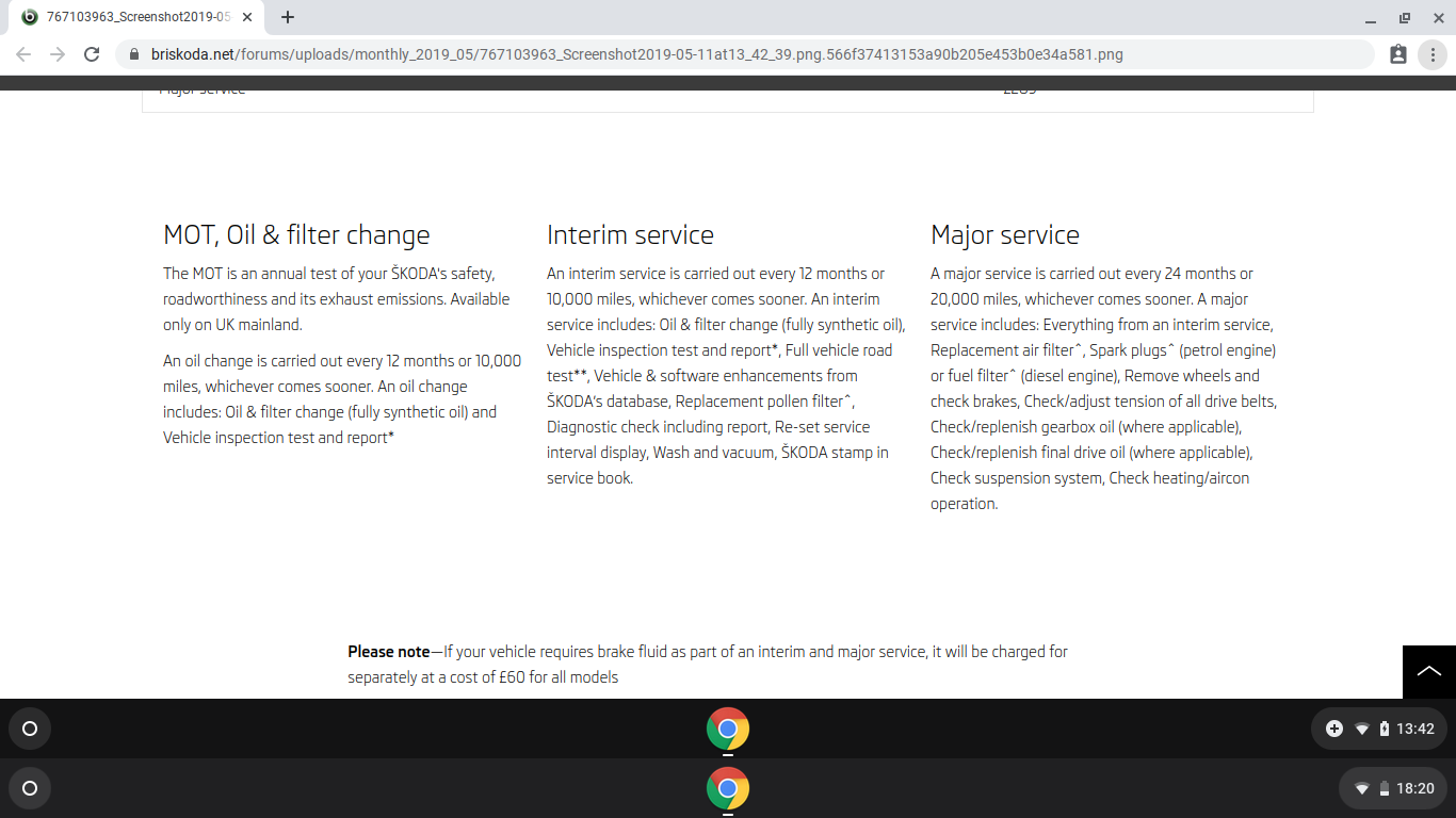

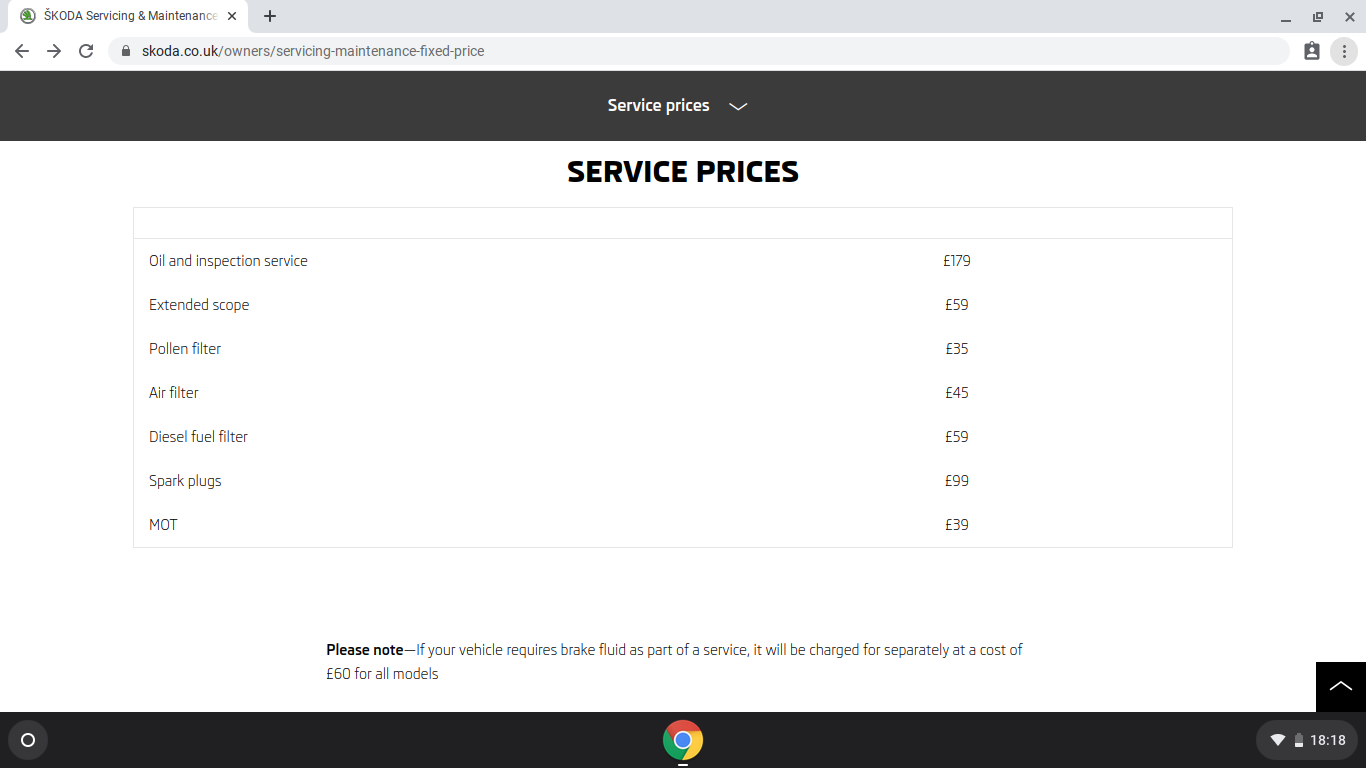

http://volkswagen.co.uk/owners/servicing/regimes

But this still doesn't really tell me why an oil change is due in 393 days from today and then an inspection is due 509 days from today. If the inspection also includes an oil change then that is two complete oil changes in 116 days (less than 4 months).  Unless there is an inspection due that does not include oil.
Is this telling me to go onto annual fixed as it will work out cheaper perhaps (for someone who covers 8000 mile per year)?

After the first service whenever it is carried out the computer will be reset and these days that you see now will alter to new numbers showing a maximum of 2 years from the first oil service until the inspection service is due. Agree your mileage is so low it will be time based servicing.
Ahhh   Now I understand better.  So I will get the car done in 393 days (oil service) and the 509 days figure will then reset to 730 at that point - Is that correct?  Don't really get why they have two numbers in that case.  In the Tig it was just one number (730) - mind you that was 10 year old and things have progressed regressed since then I guess.
Yes I know it makes no sense unless you are aware which service is due next. For example for a high mileage driver.
1st oil service at 18,500 miles.
1st Inspection service at 37,000 miles.
2nd oil service at 55,500 miles.
2nd Inspection service at 74,000 miles.
Yes, system is bit stupid showing an inspection service, when a full service is due earlier, it’s a bit like someone offering you a refill of drink, before the initial cup has been poured.
Only logical to display both when the lighter service is earlier
Most dealers would agree, that is why the majority of them advise owners to ignore the 'inspection service' reminders.
They are just that, a visual inspection and a largely pointless exercise.
