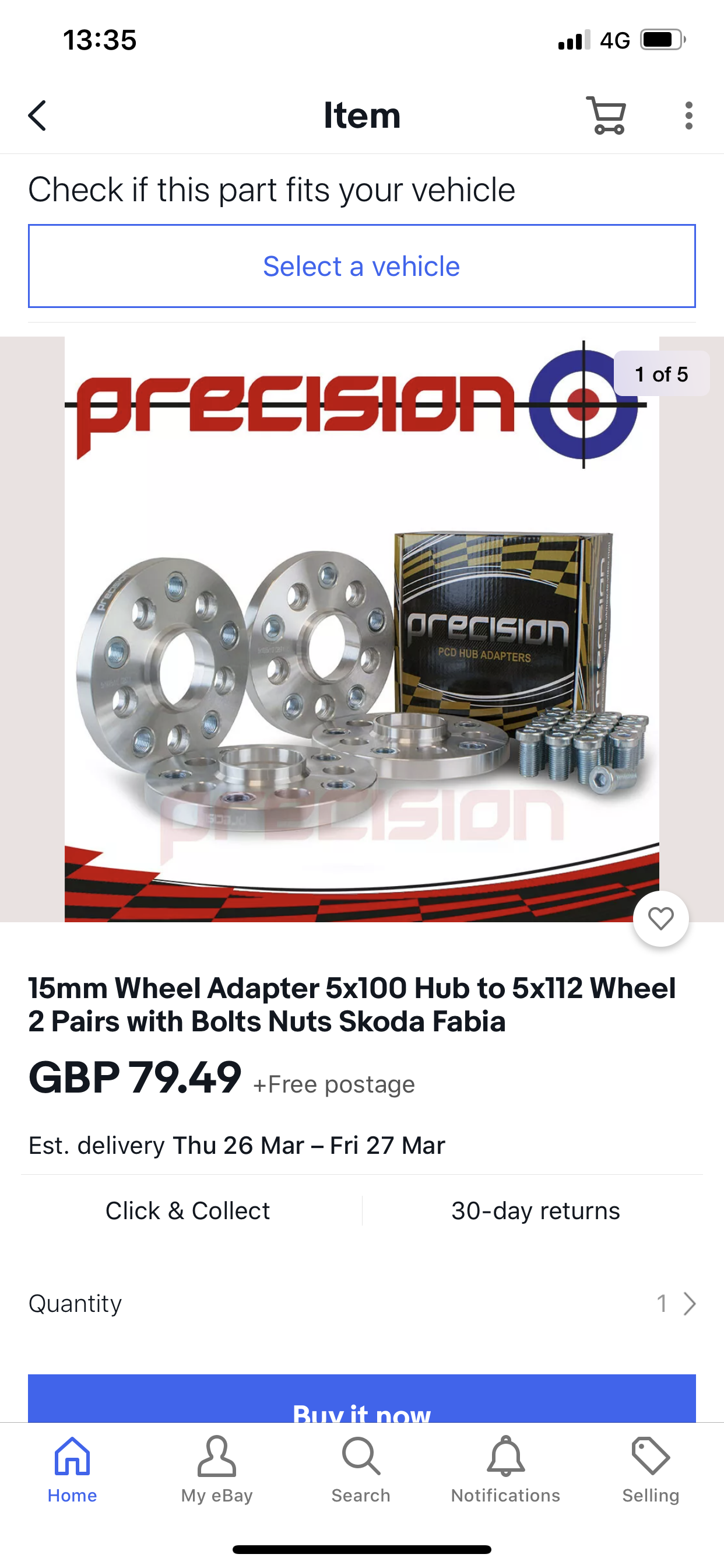

What’s the center bore of the fabia? Can I get some spacers today rectify the issue?
The holes for the bolts are in the wrong place, spacers won't help.

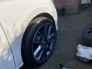

Wheels fit kind of, anyone know where I can buy shorter wheel bolts?
Do the standard bolts bottom out in your new spacers and not allow the wheels to tighten? The wheel bolts are fairly standard across the VAG. Don't think there are any shorter ones.

Exactly that, the bolts catch the disc as they bottom out, gona put this down to a bad idea and cut my loses, the wheels are for sale so I will either sell and buy fabia / rapid wheels or swap / exchange for the right wheel.  Contact if anyone interested

Slight word of warning, as per my previous post. These wheels have a total diameter of roughly 637mm, that's 6% more than the standard of 600mm, and is enough that the speedo will now read slightly under your actual speed.
It may be advisable to try obtain some wheel bearing/hub assemblies from an octavia, that way the wheels won't poke so far out. They look like they could rub quite horribly when steering hard (or even just at full lock when doing low-speed parking maneuvres).

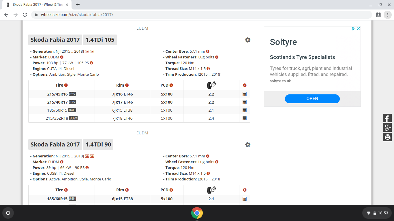

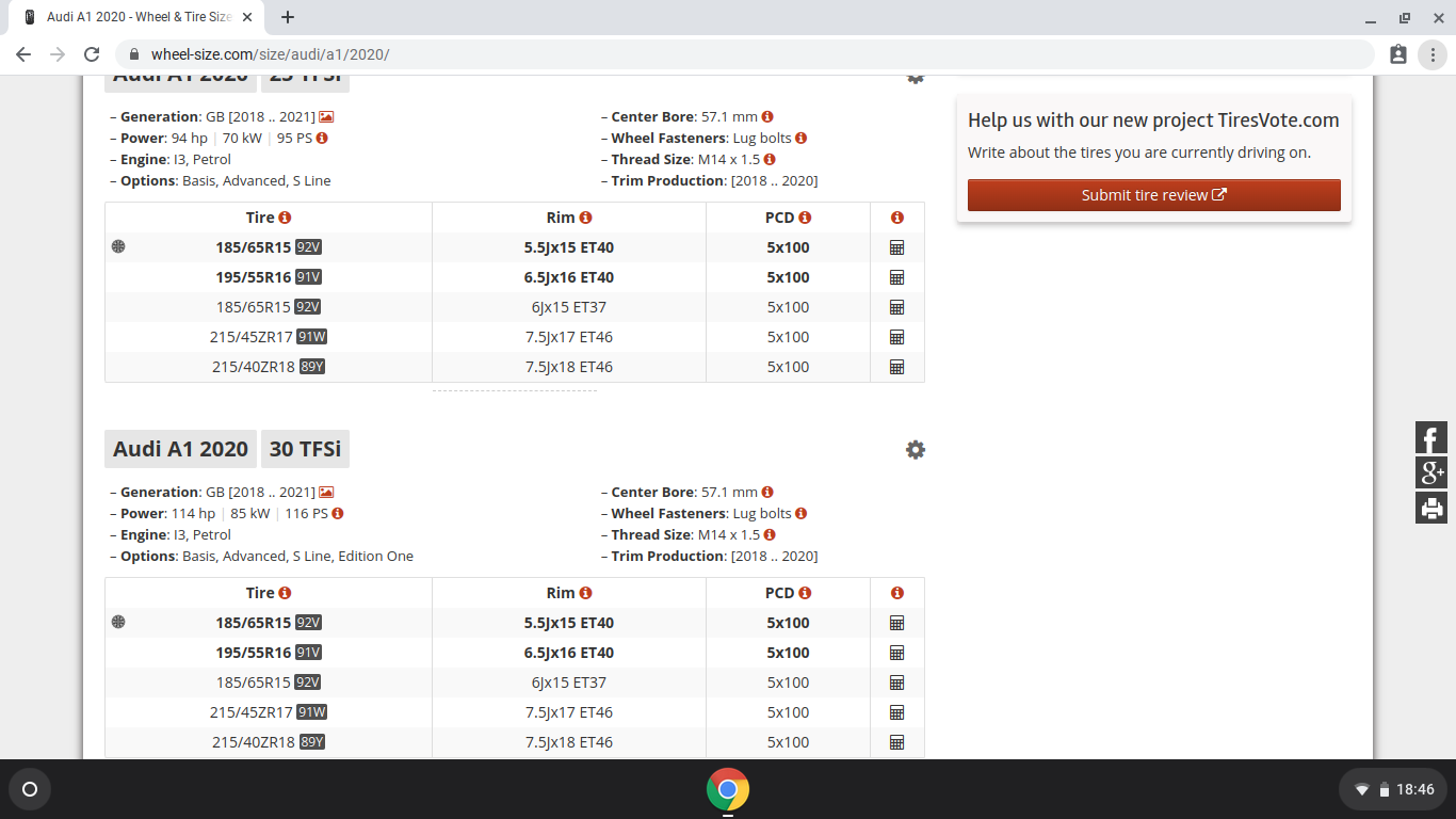

They don't quite match the Fabia MK3, so beware :)
Believe me, i was looking round absolutely everywhere before i found the 17" Rapid wheels that i put on mine.
Edited by FabiaGonzales
The difference were that the Fabia Mk3 18" are 7 J not 7.5 J and both are the ET46.
