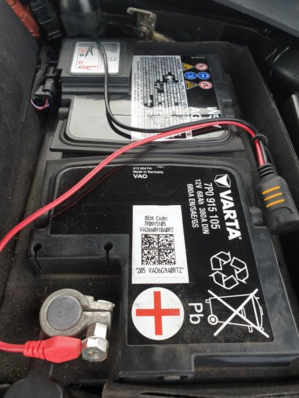

  • I have used the eyelets. I have an AGM battery. Like others, I read that I shouldn't attach the negative terminal on the lead to the negative terminal of the battery. It took some time to find an atta

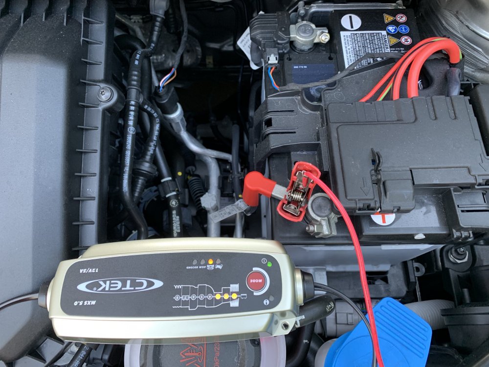

I have the Ctek 3.8 and use that to trickle charge. I think it came with a short cable to affix permanently using two eyelets though I use the spring clamps instead. Not sure whether the negative point on the Mk III has a screw to fasten it to.

 Just connect the negative eyelet to the body and the positive eyelet to the battery post. I hope I’m correct before I get bawled at again by a “senior member”.

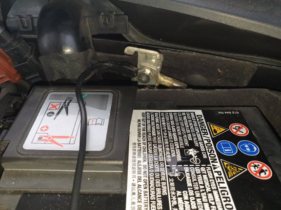

I have used the eyelets. I have an AGM battery. Like others, I read that I shouldn't attach the negative terminal on the lead to the negative terminal of the battery. It took some time to find an attachment point for the negative eyelet. Finally I spotted the negative attachment tab for the negative terminal on a jump lead (should one ever need to use them). It is attached to the bulkhead a few inches from the battery. I was able to attach the negative eyelet to the end of a bolt sticking out just below the tab and secure it with a nut. The positive eyelet I attached to the end of the bolt securing the positive clamp on the battery; securing it with a nut. I have used the arrangement and it works. Photographs attached.
That's the spot where I use the crocodile clips. Seems I should have looked harder then I'd have seen the bolt as well :giggle:

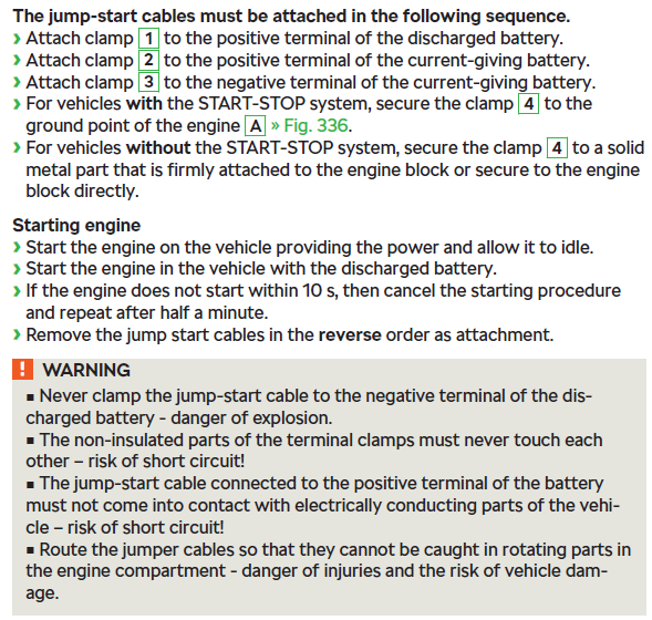

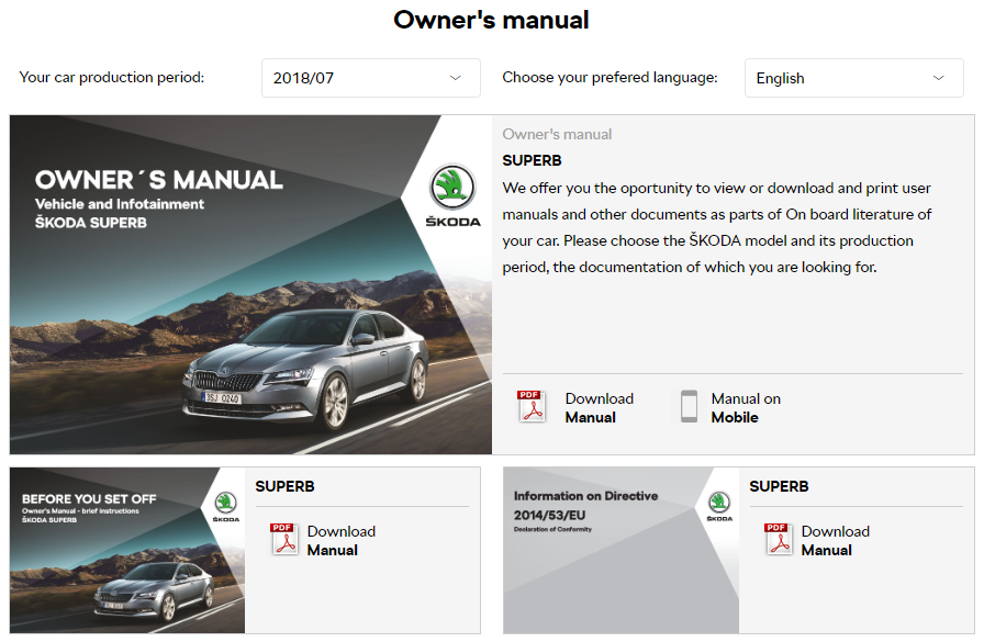

Given that we're all housebound I imagine we'll all be falling over ourselves at the excitement of finally getting around to reading the owner's manual from cover to cover! :D
You don't even have to go out to the car...
https://manual.skoda-auto.com/004/en-com/Model/Superb_3V/07-2018/en
Edited by silver1011

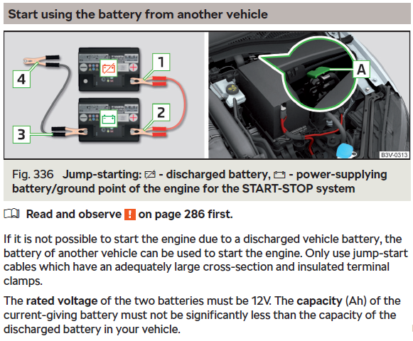

Surely this is a bit misleading because if you are jump starting from another AGM battery you will need to go from ground point to ground point?

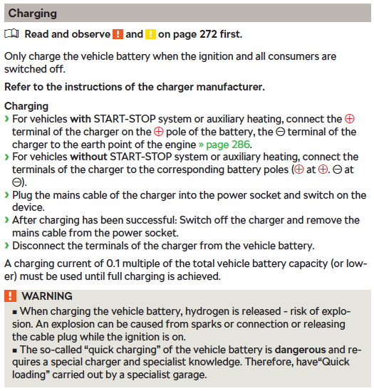

@silver1011 is there a bit on charging, rather than jump starting???
I've tried to research this re negative connection, and some sites (RAC, Varta) only mention disconnecting negative cable, therefore having to connect charger to battery negative.
Edited by Tilt

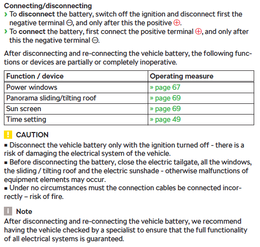

I just noticed there is a separate section on charging, quite why it isn't closer to the jumpstarting section I'm not sure...
^^^^ Thanks, the first two points under the charging section confirm what I wanted to know.
