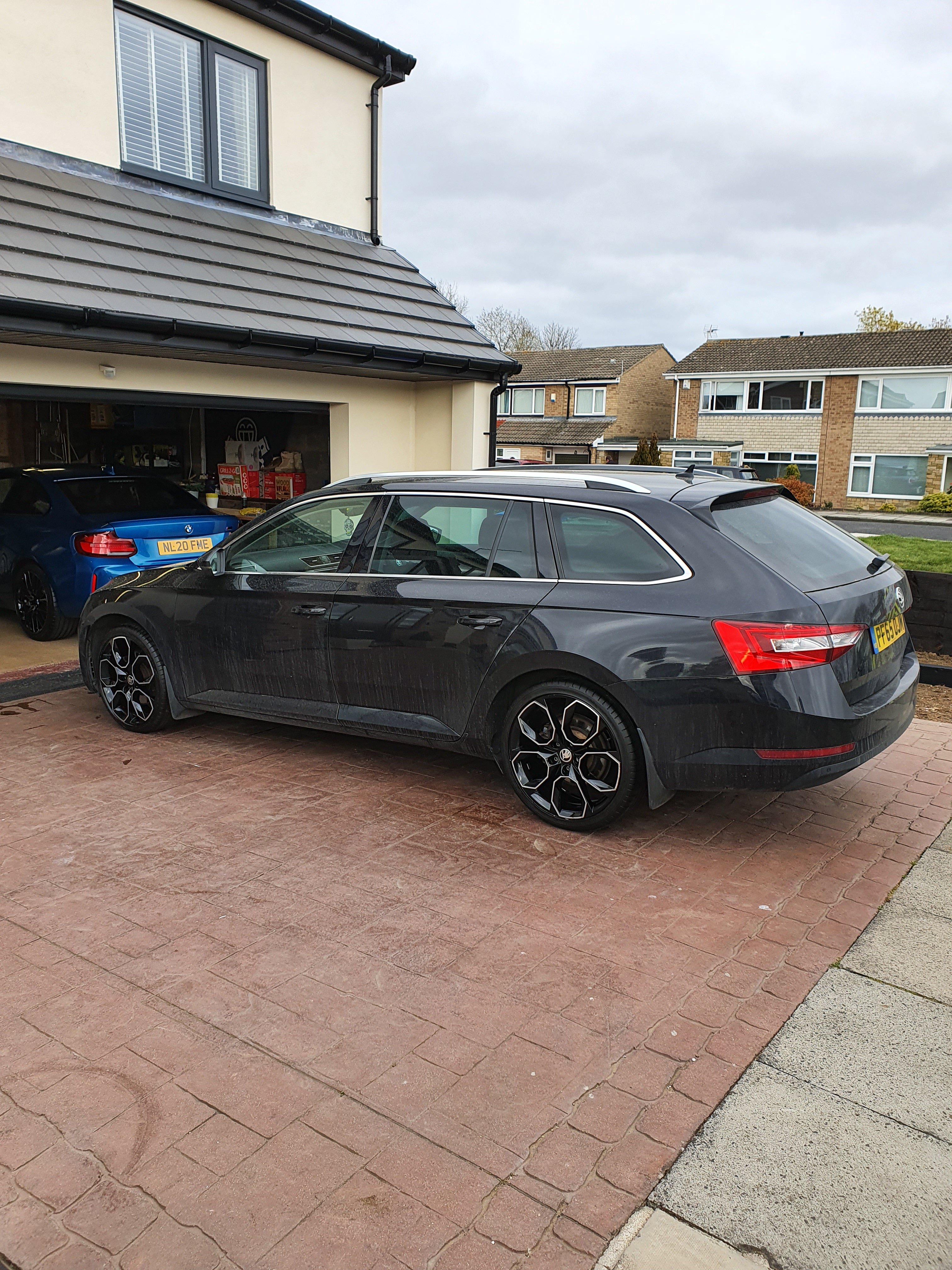

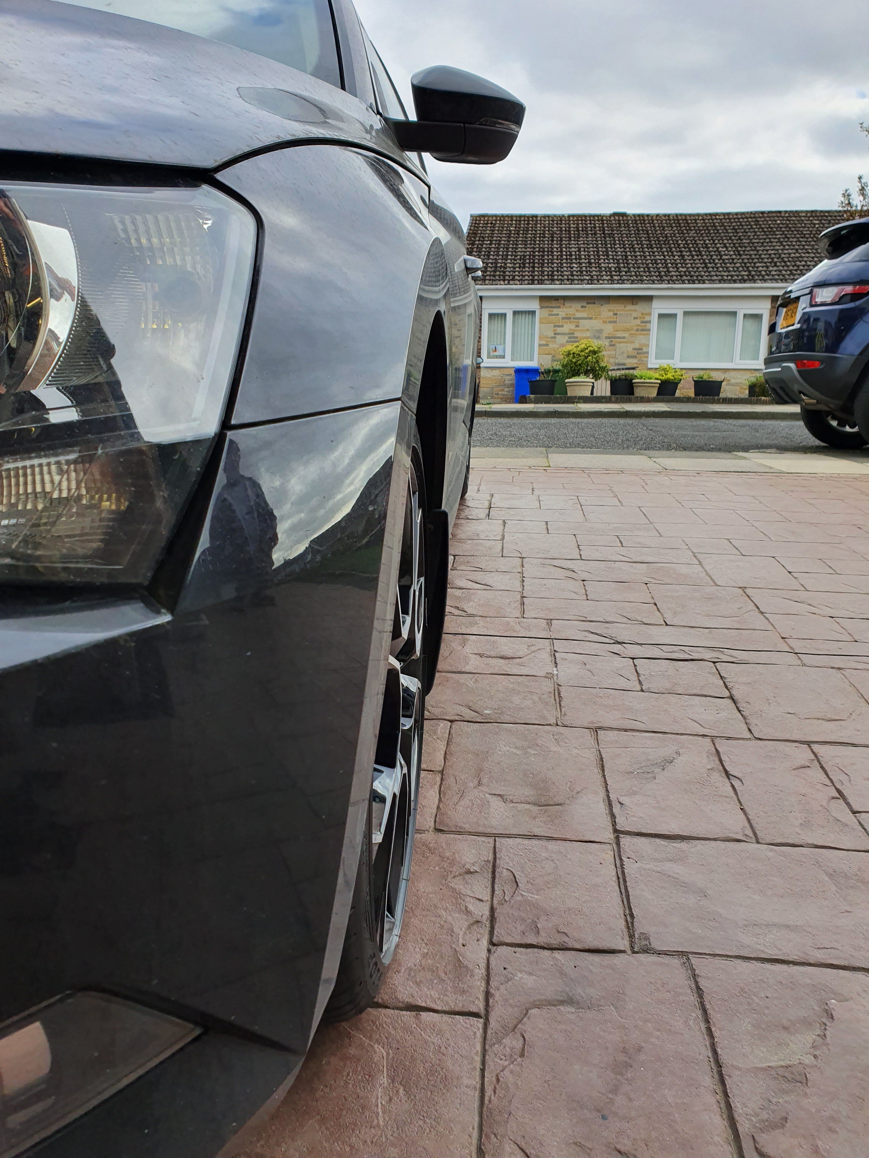

I've fitted 19''s off a Kodiaq and they're lost in the arches. Whats the best size of spacer to run to push these out?
the 19s on the Kodiaq have a narrower rim width and a different offset - that's why u've lost ur wheels in there!!!
ur gonna need some thick azz spacers to bring them back out!!
Superb - 8Jx19 ET44
Kodiaq - 7Jx19 ET43

The Kodiaq wheels are the same fitment as Octavia ones, its been done before. I'll go with 20mm spacers all round and see how that looks

It sits well on the 20mm spacers, perfect really considering its standard ride height and I'm not going for the hella flush look. I wouldn't mind another 5mm on the rear
