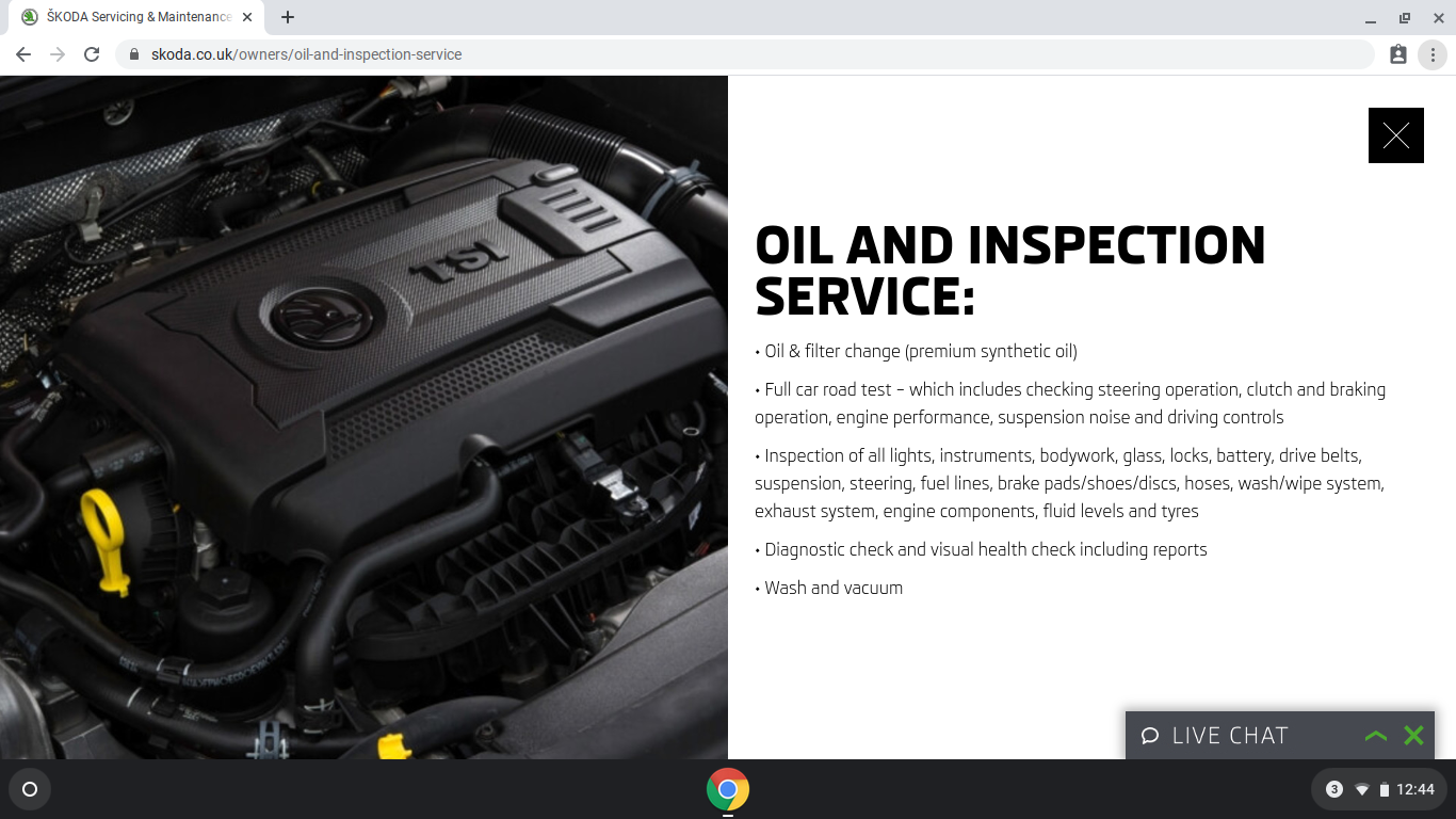

Changed now to the 'Fixed Menu choices'   You pay for the Service and extra for parts over and above.
Oil & Inspection Service,  and then the 'Extended Scope' that is offered. so like a 'Major Service'..
