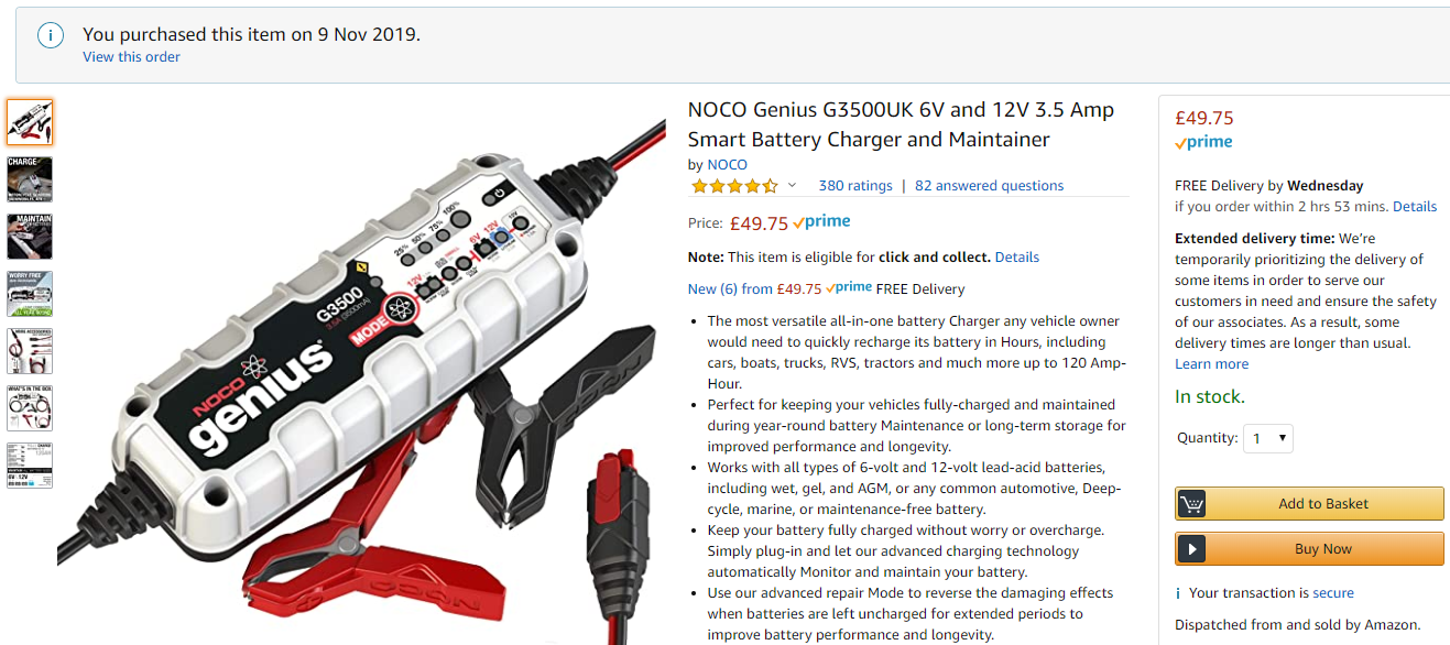

I bought one of these late last year, and really rate it...
A lot of people also have good experiences with the CTEK range of chargers (although I've heard their quality has taken a dive of late, hence me buying the NOCO).
