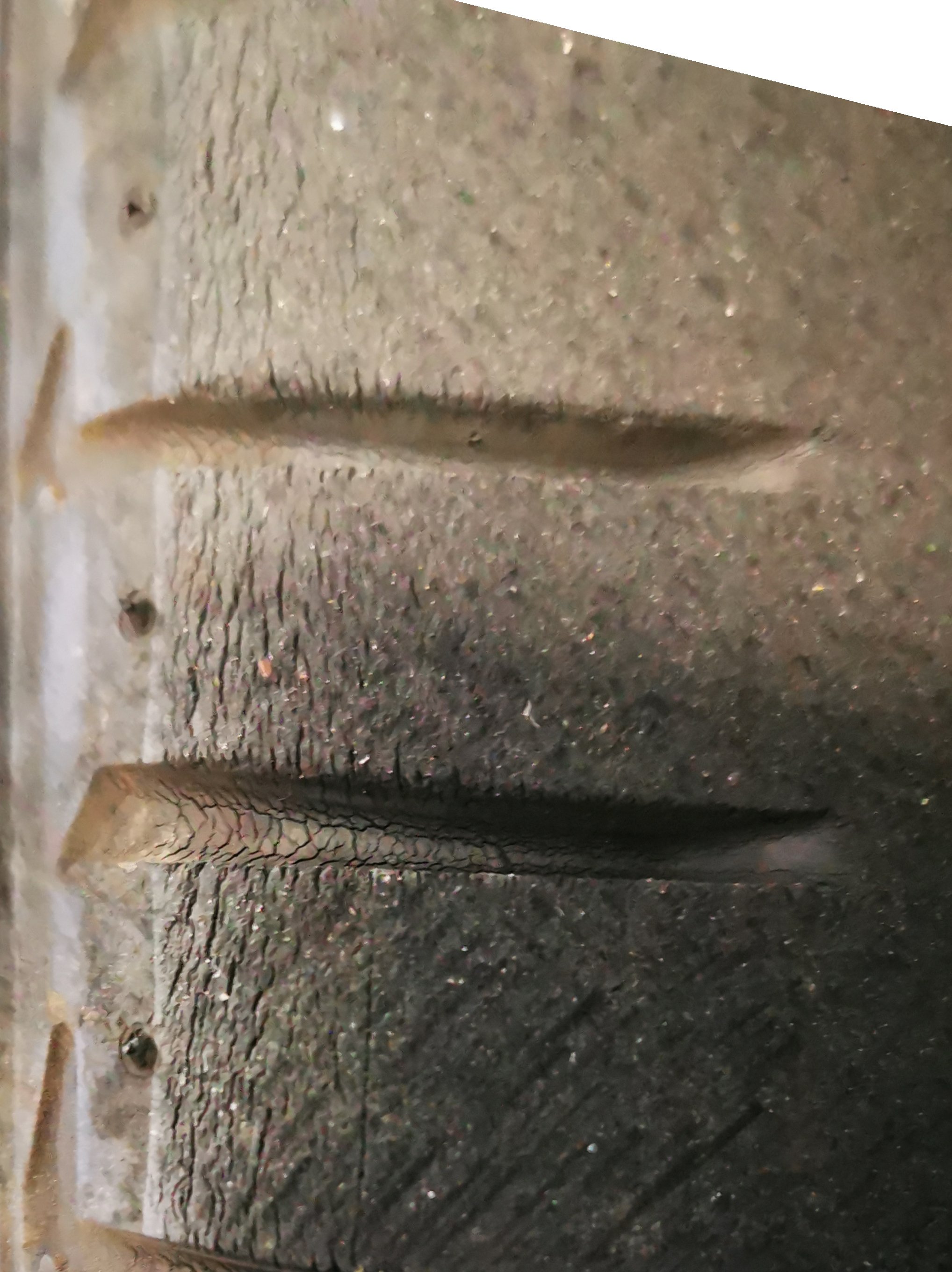

Tyres cracking on 280
So had my superb almost 2 years and where this isn't completely new issue ( first noticed probably year or so ago)
With this lockdown it seem its getting slightly worse as car is constantly sat on car park sheltered.
Tyres are Bridgestone S001 made in second week of 2018 and have approx 5-6mm left on them.
Obviously it won't get any better but will it last say another 6+ months?
Anyone else with this problem?
I've seen a few reports of S001's seemingly degrading/cracking prematurely.   They look like tyres that are much older or have been exposed to some serious weathering.
Seems like a good reason to buy yourself some Michelin PS4's, just in time for Summer 😃

I used to run a tyre shop for last 5 years until this non sense started and have to say lot of people were not happy about Potenzas due to them being quite hard...they apparently need a lot of heat to make last longer...on other hand car has always been kept indoors ...i had Conti Sport 5s on my old Vrs and after 2 years they were worn more with 4mm left but not as sign of cracking...new tyres obviously need to wait as I'm currently unemployed....

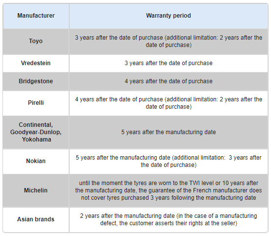

13 hours ago, silver1011 said:
The tyres are two years old and under warranty...
Contact Bridgestone and tell them you'd like to make a claim under their warranty...
https://www.bridgestone.co.uk/contact-us
I've successfully claimed from two tyre manufacturers for defective tyres now, Dunlop and Nokian.

So been in touch with Bridgestone and this is what they replied:
Hello and thank you for the email and accompanying images of the tyres.
Based on the images provided we can confirm that you have nothing to worry about.  The tyres visual surface rubber crazing is not concerning and is a natural ageing process of the tyres when they are exposed to certain operation elements.
In their present condition they pose no detriment to safety or vehicle performance.
If the tyres are well looked (i.e. correct tyre inflation air pressure used, visual health checks carried out) they will complete a good service like without any further issues.
