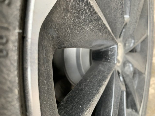

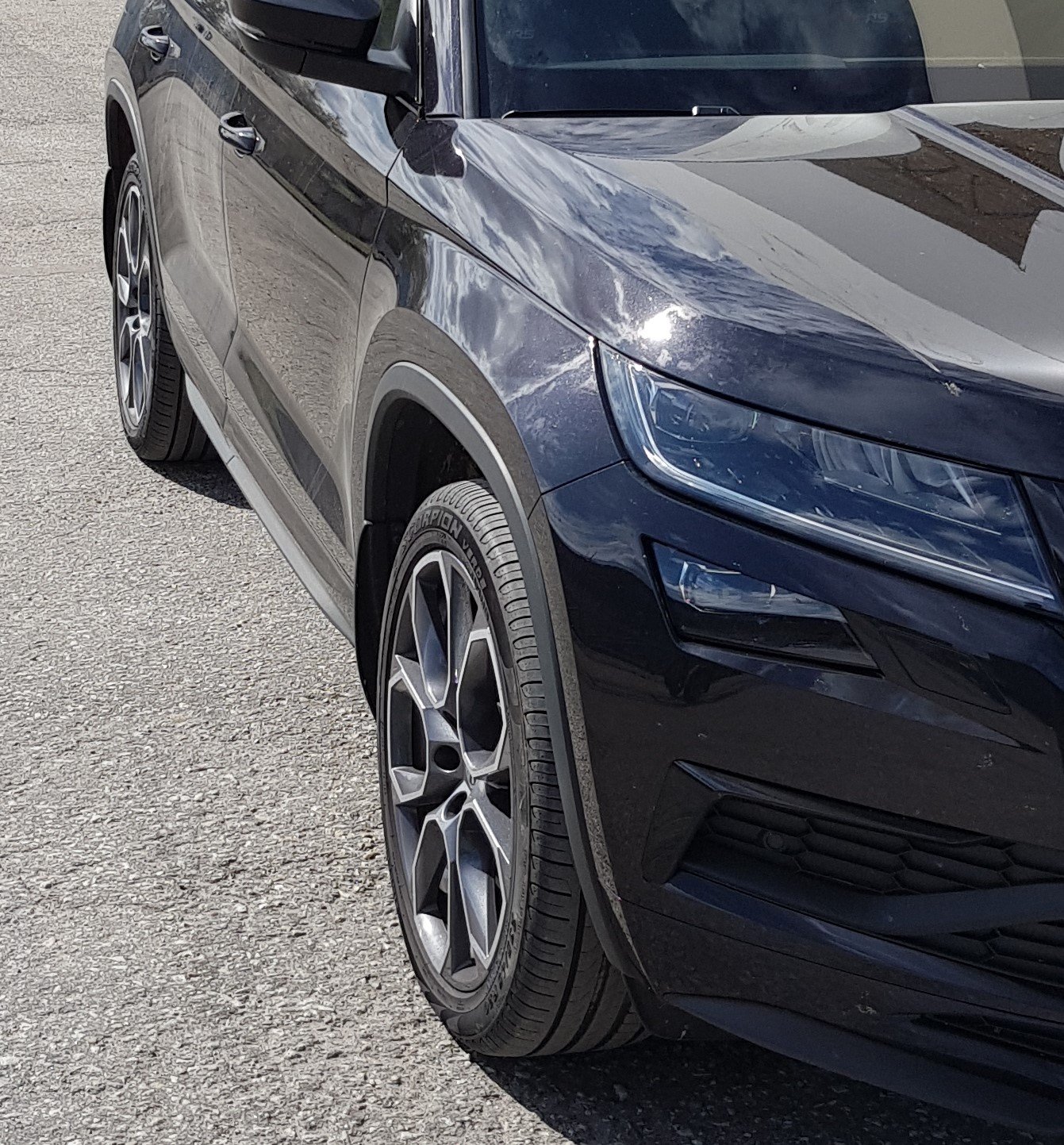

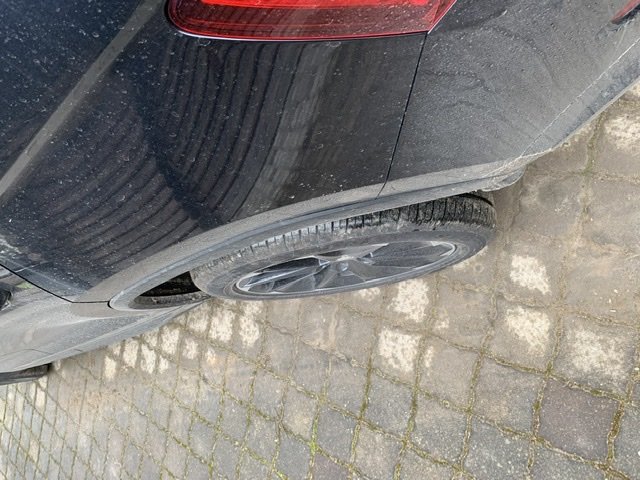

Hi all, looking to add some wheel spacers to my 2018 kodiaq sportline, running 20" wheels, as I think they look way to far tucked in.
Has anyone added spacers to theirs? If so what width did you install and what make?
Think I'd get 20mm to fit?
Photo attached (not a great one to show the gap in the wheel arch)

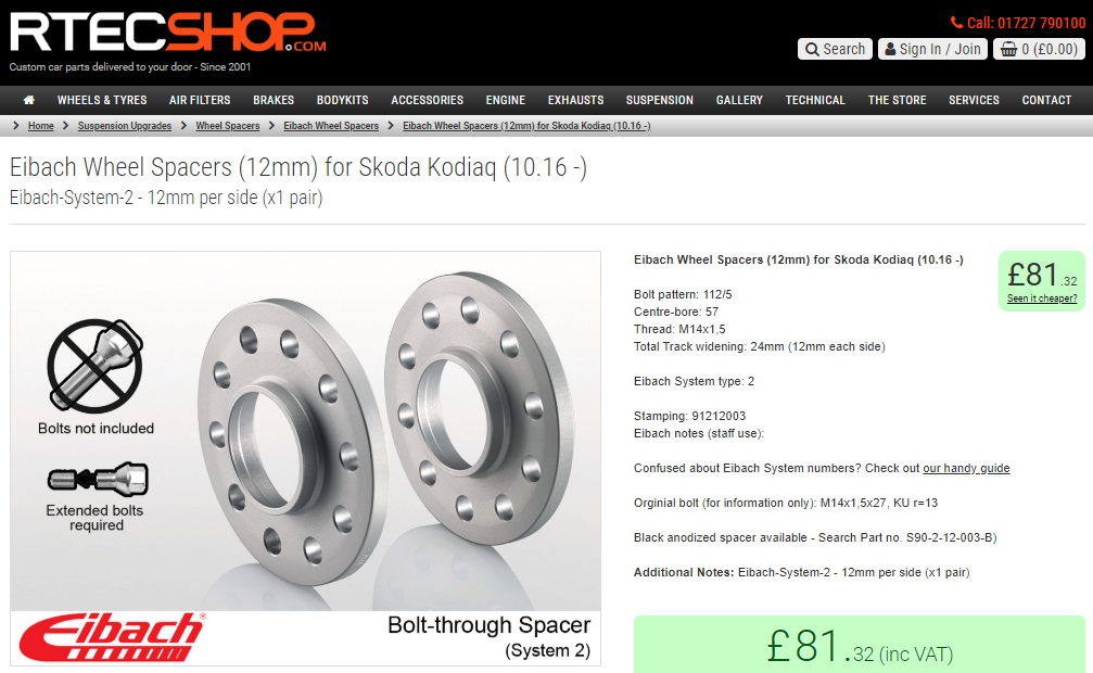

    Eibach are a reputable company and VAG use them for a lot of their suspension components...   https://www.rtecshop.co.uk/eibach-wheel-spacers-12mm-for-skoda-kodiaq-10-16/prod_476073.html
OK great stuff thanks, will check these out
I agree buying branded spacers is going to be a better option than buying cheap knock ups from eBay.
Hub centric spacers that bolt on to the hubs are a far better and safer option than using the type that use extended wheel bolts.

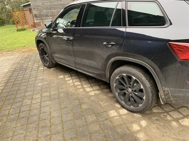

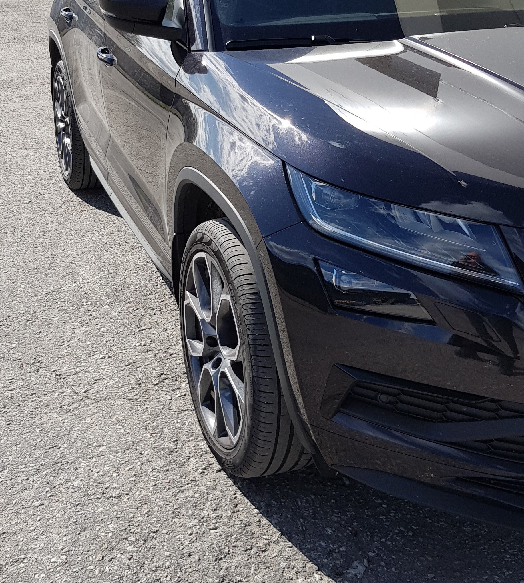

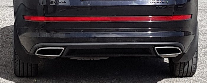

Here they are... Installation was free of charge...

That is true. Only installation was free... not spacers itself. I dont see why they shall decline installation over there, but never mind, every country has them own wierdnesses. If they decline, then it is anyway 15 min. installation by itself...

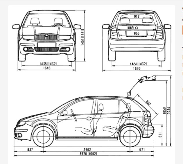

The RS & sportline version are wider from the other Kodiaqs already as stock - done by spacers or its just the 20" tyres?? + this is the Eibach enhancement
Are they?
I don't think the SportLine is any wider than the other non-vRS versions of the Kodiaq.
Appears there is a difference.

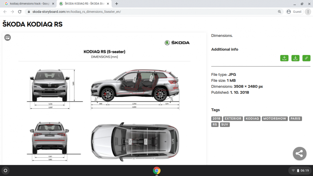

Kodiaq has front/rear track 1575 / 1565 mm, except RS, which has 1579 / 1567.
But 4 / 2 mm do not make any difference
But not the SportLine?
