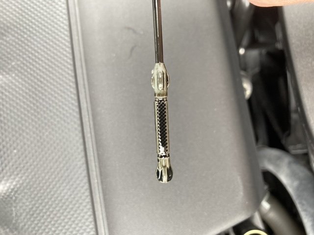

I ask as my oil after 7k miles (and almost 12 months since it’s last flexible service) looks fairly dark, I was expecting it to have more of an amber hue to it.
Also looks a little on the high side. Took the reading after a 20 min trip out, left to cool for 5 mins and stood on a flat surface.
Edit: apologies for the image, I couldn’t rotate it the correct way when uploading it.
Edited by CookieMonster87
It looks where it should be when checked at 'Normal Operating temperature' as you have done.  In Area A.
(Check it when stone cold and see where it is showing.)

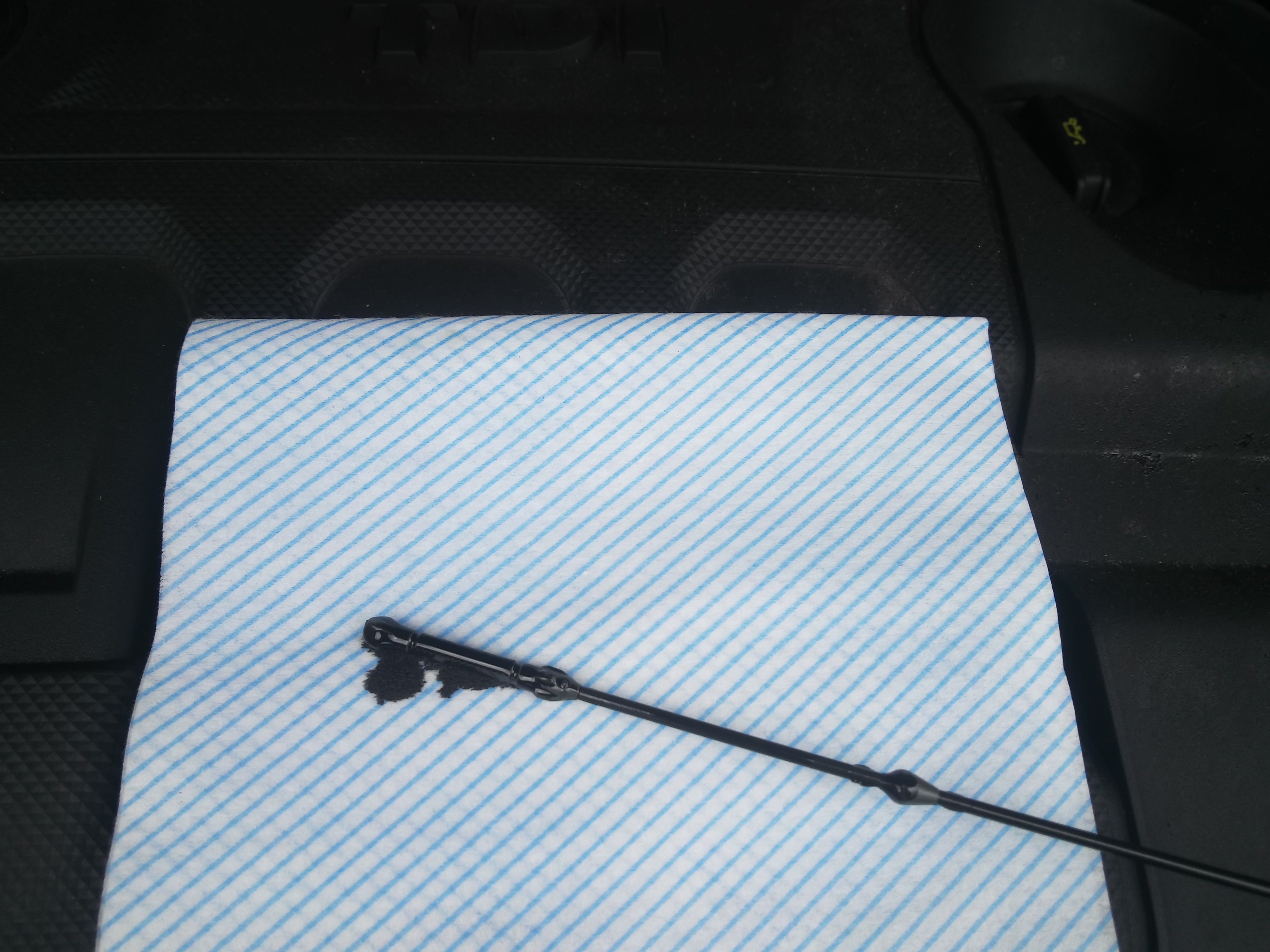

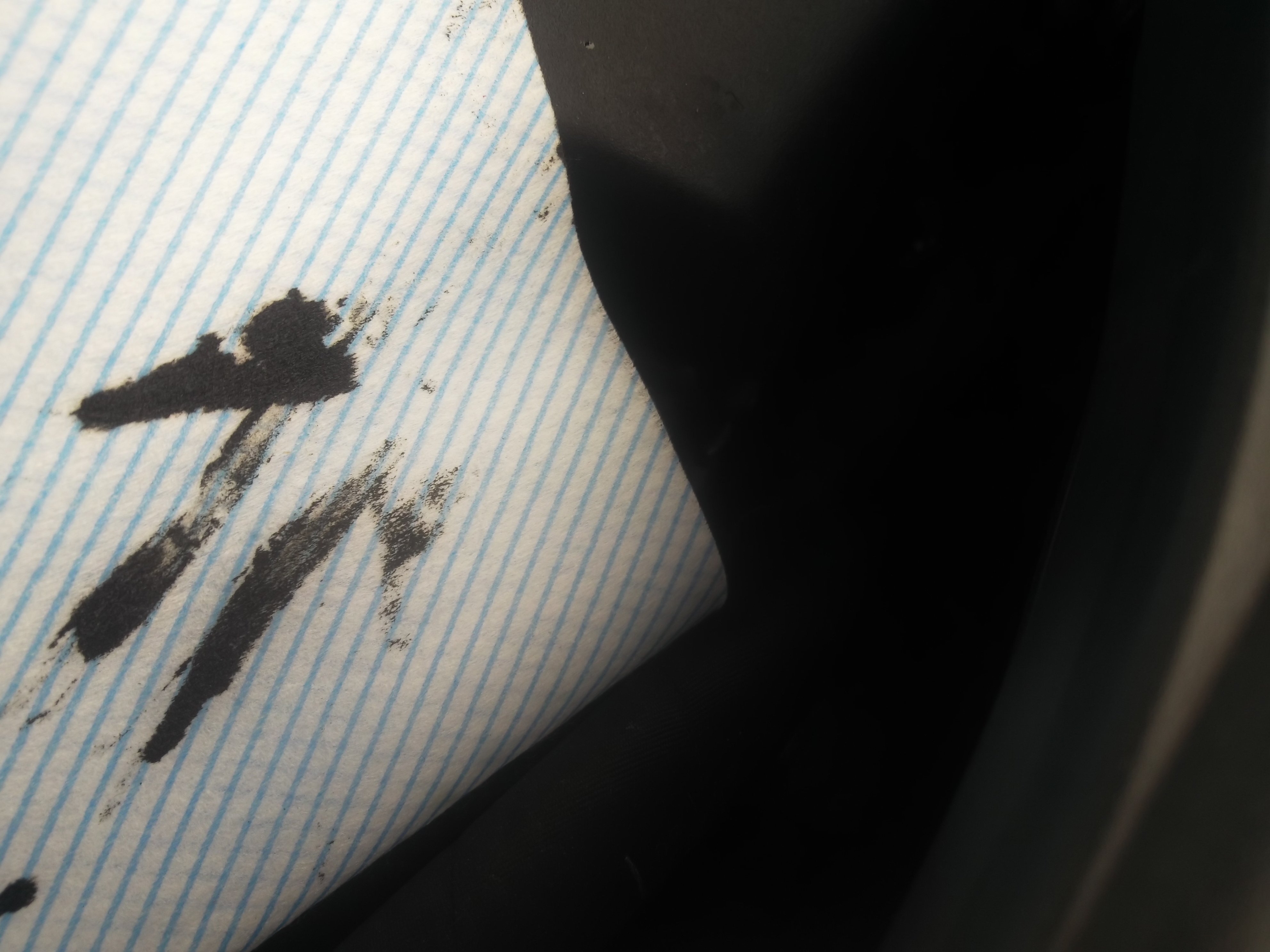

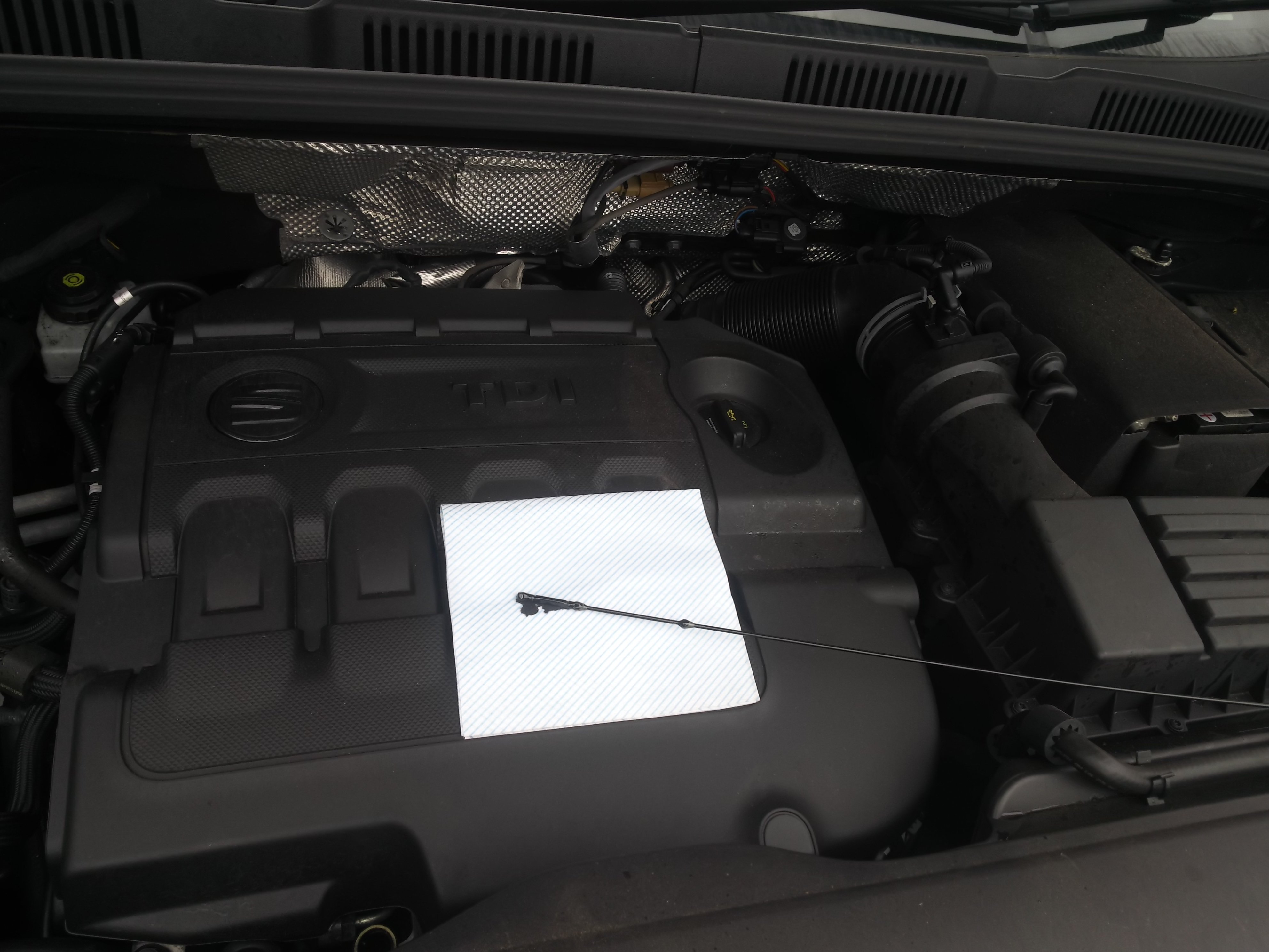

A TDI's VW507 (5w 30 FS III usually) Oil can be dark in only a few miles after an oil and filter change.
Below is what i had at 19,000 plus miles on Flexible Servicing and unable to get the Motability car in for it's service.
That was after over 2 litres of oil added over that miles.
Actually like clotted by the time it did get the Oil & Filter done.
Looked black as the ace of spades by the time i had driven it for 20 miles after the service.
(Car is for Sale at Arnold Clark, they bought it at BCA,
3 1/2 year old now & i would not touch it with a barge pole, i know how it was driven...)
Know what was advisories on the MOT @ 2 months before 3 years old and know that work was not done.

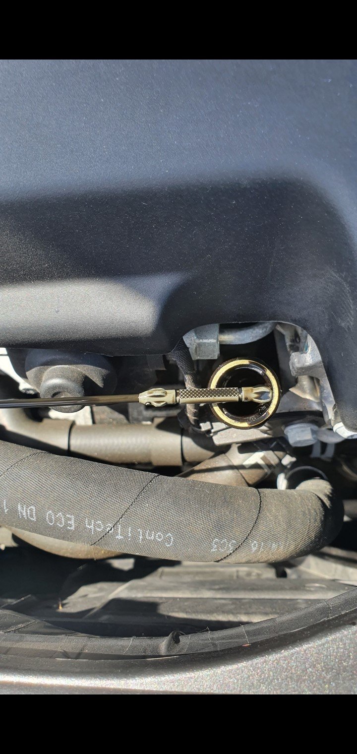

@CookieMonster87 this is what mine looks like after 7 months and about 6000 miles
@tunedude  Is that a new car with factory oil after 7 months / about 6,000 miles with VW509 so 0w 20 FS IV,
or a car that was serviced / oil and filter change 7 months / about 6,000 miles ago?
serviced 7 months ago. Car's got just shy of 20k on the clock
Edited by tunedude
@tunedude are you on a fixed or variable service plan?
I'm on a fixed one now because they messed it up in the first place. I'm more a cautious 'change the oil every year whether it needs it or not' kinda guy. The oil has always been the same.
They said my mileage is on the border of either but for the sake of an extra few quid, sooner get them to do it each year. The first time it went in for a service, they said it doesn't need the oil changing and didn't understand me reasoning for wanting it doing. That's when they took me off Q16 variable and and put me on Q14  10k miles fixed.
