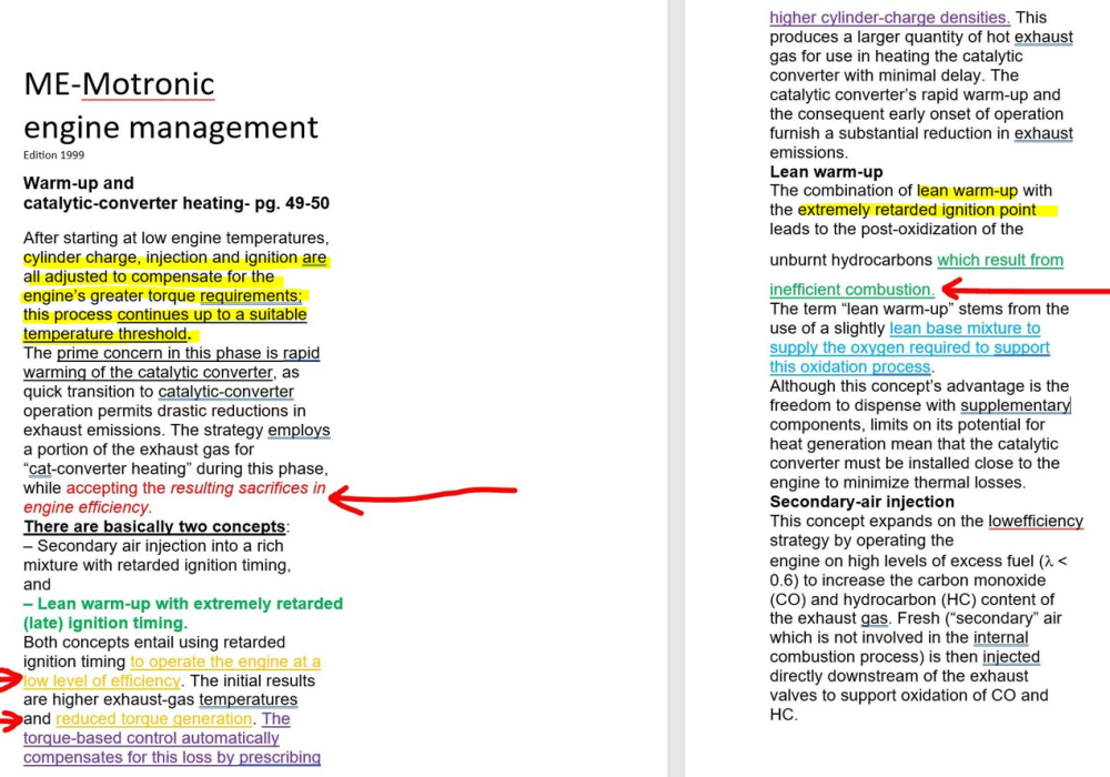

Obviously the 1.5TSI EVO (ACT) was produced to have good qualities and get the lower emissions that the 1.4TSI or 1.4 TSI ACT / 1.4TFSI COD
could not produce under testing.  When testing was not going to easily be cheated.
Then the WLTP / RDE stuffed that up and there had to be Engine Management / Software changes, and that co-cked up some at some point.
Hence issues with some produced, and then software updayes so that the cars could run better, but no new WLRP Certification required.

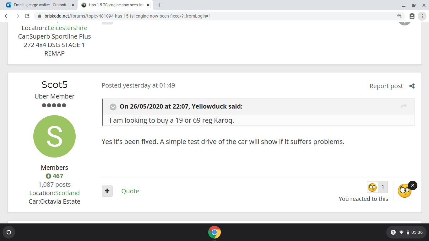

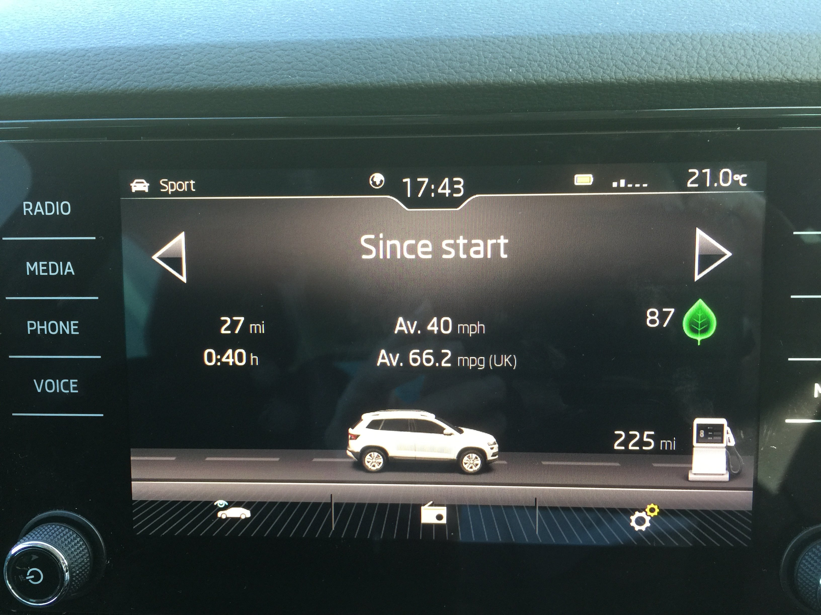

This must be the maximum an owner of a 148bhp  SUV can expect with a petrol engine.

No; I'm very confident that an average speed in excess of 40mph is achievable. :)
