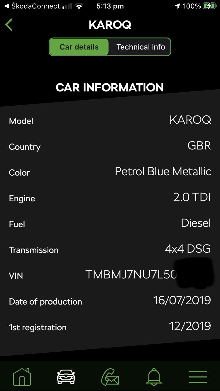

I took delivery of the car in June 2020.
Check on the MySkoda app and it will give you the build date.
.35DC44E9-9C6D-4563-A11D-854D991C47EC.thumb.jpeg.4280bfc281ec59946735772079bd4204.jpeg
