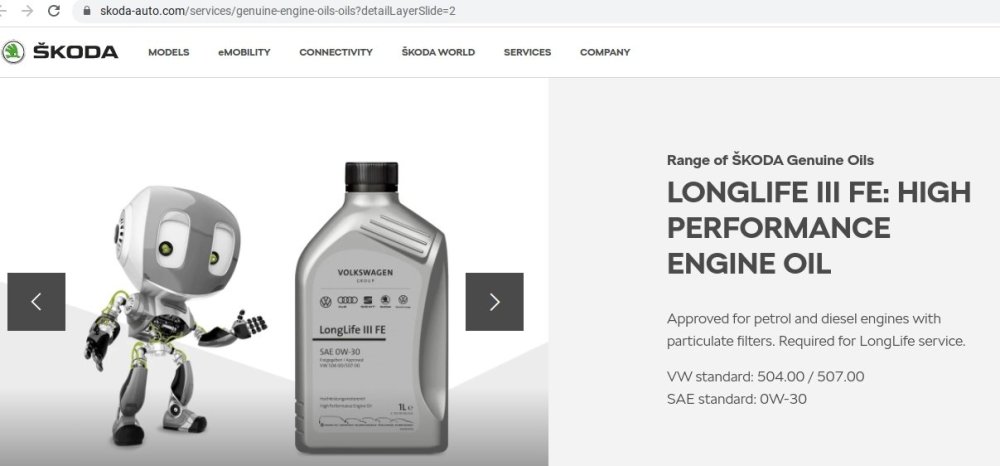

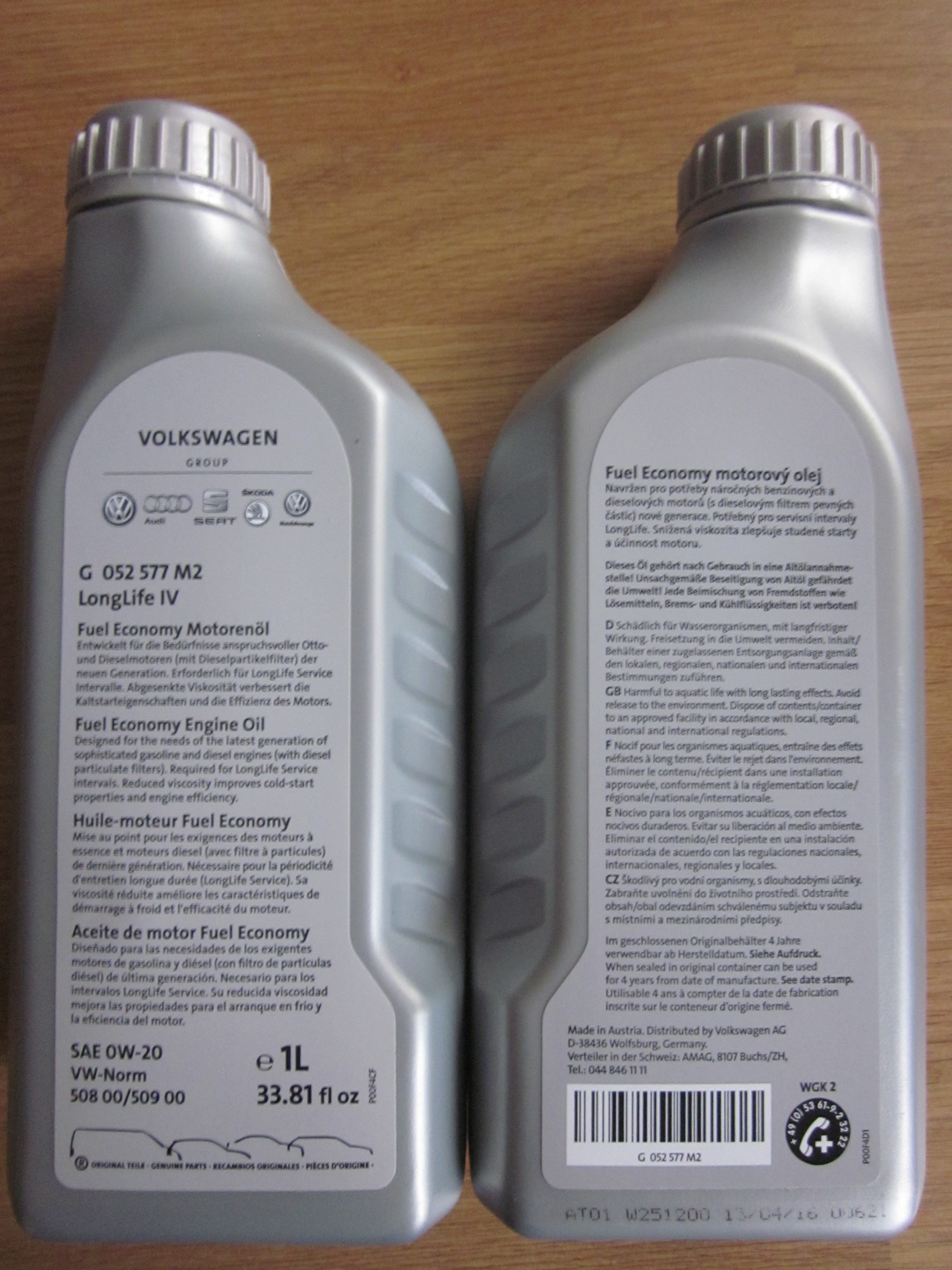

Unless they have 0w 30 FS IV to VW508/509 for the servicing.
http://buycarparts.co.uk/motor-oil/vw-508-00
The car left the factory with 0w 20 FS IV.  To VW 508
*It was 2018 that they started using VW508 /509, before the WLTP Certification started.*

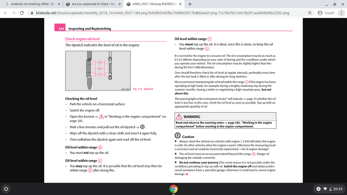

166593407_Screenshot_20180414-061447.png.ad6ebc941f71f4e7a77cecf5e55307c4(1).png.5cf0e7c5b4488b1f7cacf2e7a6b1f09d.png.6551daf97f9b6fe94dc24c57228a218f (1).png
Probably never filled correctly to begin with, I've seen this in a few TSIs. The oil level on my 272 barely moved the first year, I could probably have added 200-300ml after 10,000km but it was about to get an oil change in January so I let it be, hasn't moved since.
These engines in general are not drinking oil unless you have a really wrong one (doubt it).
I think it will be fine

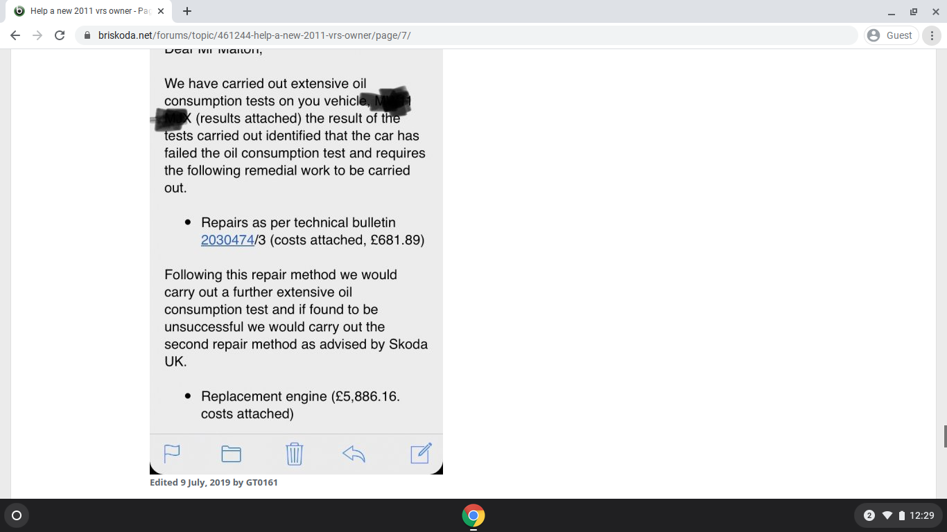

Skoda UK thinks so when a Expert Engineer does an Independent report on an engine and the owner is prepared to take legal action.
They try claiming 0.5 litres / 1,000 km is within tolerances.
Too many have let them away with it once cars are out of manufacturers warranty, so you just make sure you do not let them try it on when the warranty is valid.

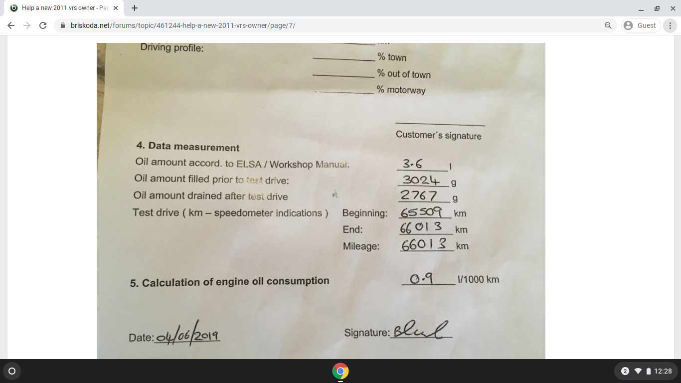

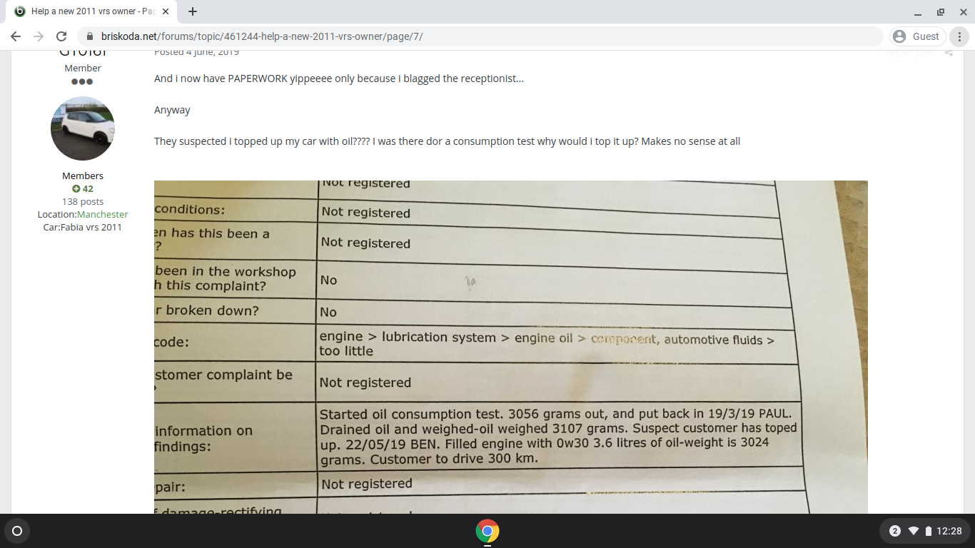

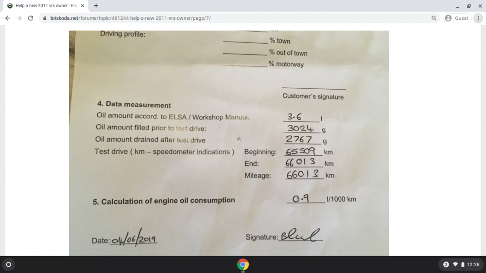

1 litres of oil for Official Oil consumption tests is 857 grams,.
not as some muppets @ dealerships doing the weighing and tests think at 1,000 grams
. (First report an example of that. The car did get a new engine once to obvious error pointed out.)

So VW Group went 0w 20 FS IV for the WLTP / RDE & now RDE2, and also fitted GPF's.

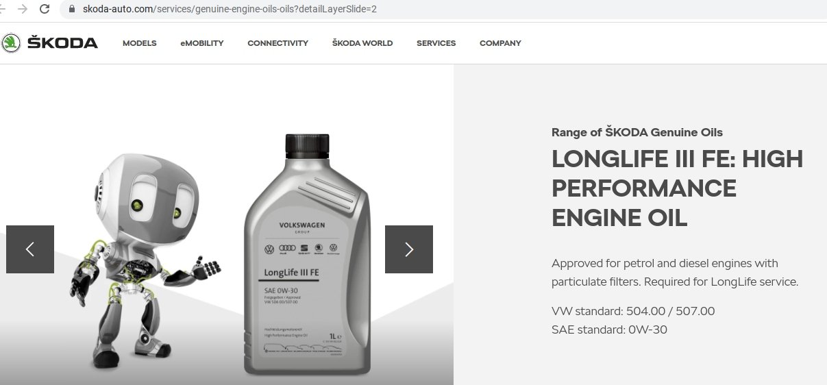

and is it VW507 00   0w 30 FS III oil that is the correct one for your engine, fixed or variable servicing?
