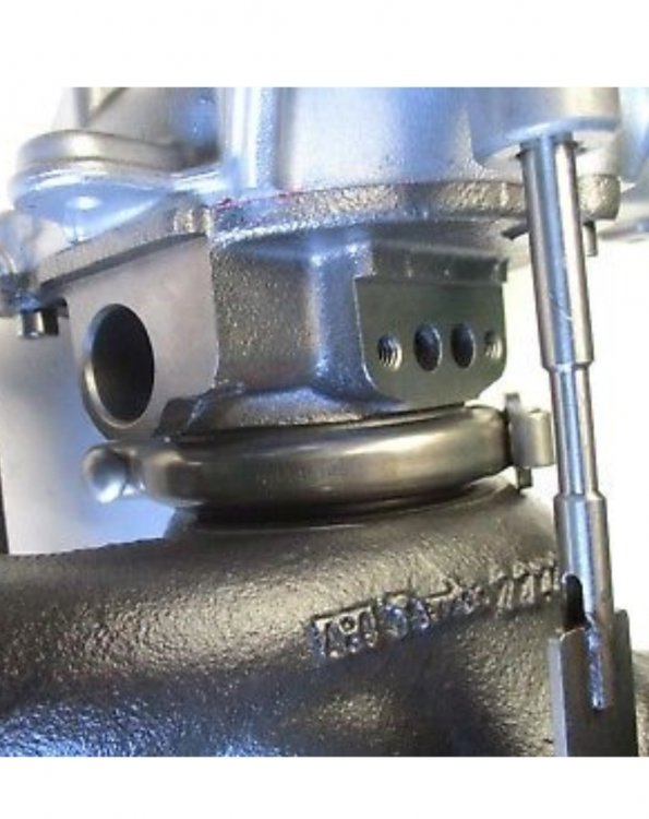

1.4 TSI Small Turbos - Avoid - Same size as the 1.2 TSI but with different shaped exhaust housing, you won't see any gains with these.
04E 145 721 E
04E 145 721 R
04E 145 713 N
04E 145 704 F
04E 145 704 R
1.4 TSI Large Turbos - Avoid - Has an additional sensor on the exhaust housing, stay away unless someone confirms it's removable and fits.
04E 145 721 C
04E 145 721 G
1.4 TSI Large Turbos - Avoid - These have a different type of Wastegate actuator, stay away unless someone confirms it works.
04E 145 722 G
04E 145 721 P
04E 145 715 B
04E 145 715 D
04E 145 715 E
04E 145 715 F
1.4 TSI Large Turbos - Best Choice - Matching Wastegate and confirmed working by myself and others.
04E 145 721 B
04E 145 721 F
04E 145 704 C
04E 145 704 P
04E 145 722 G
04E 145 721 P
04E 145 715 B
04E 145 715 D
04E 145 715 E
04E 145 715 F
04E 145 722 G this P/N Fits perfectly, thanks again for your help 👍🏻

One weird thing I saw these days during my search for info about the larger turbo is regarding the wastegate actuator; the rod doesn.t have any adjustments, is just one stiff piece of metal.
What were you referring when you said "Adaptation is advised but not necessarily required for the wastegate (I didn't do it on mine and it's been fine)." ?
You mean adaptation with vcds? But it seems no mechanical adjustment is possible for the wastegate actuator rod......
Adaptation is via VCDS, i didn't do it on mine and i've never had a problem.
