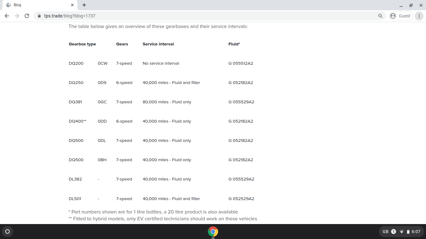

DQ381 service intervals
80k miles, who'd have thought that
Wasn't a popular 'opinion' when I first mentioned it, though I think people are starting to accept that VW/Skoda do actually schedule these boxes at 80k.
DQ381  in title of this thread.
The other thread as mentioned has DQ380 in it.
Maybe someone coming across the thread from a search is interested in the DQ380 and another the DQ381.

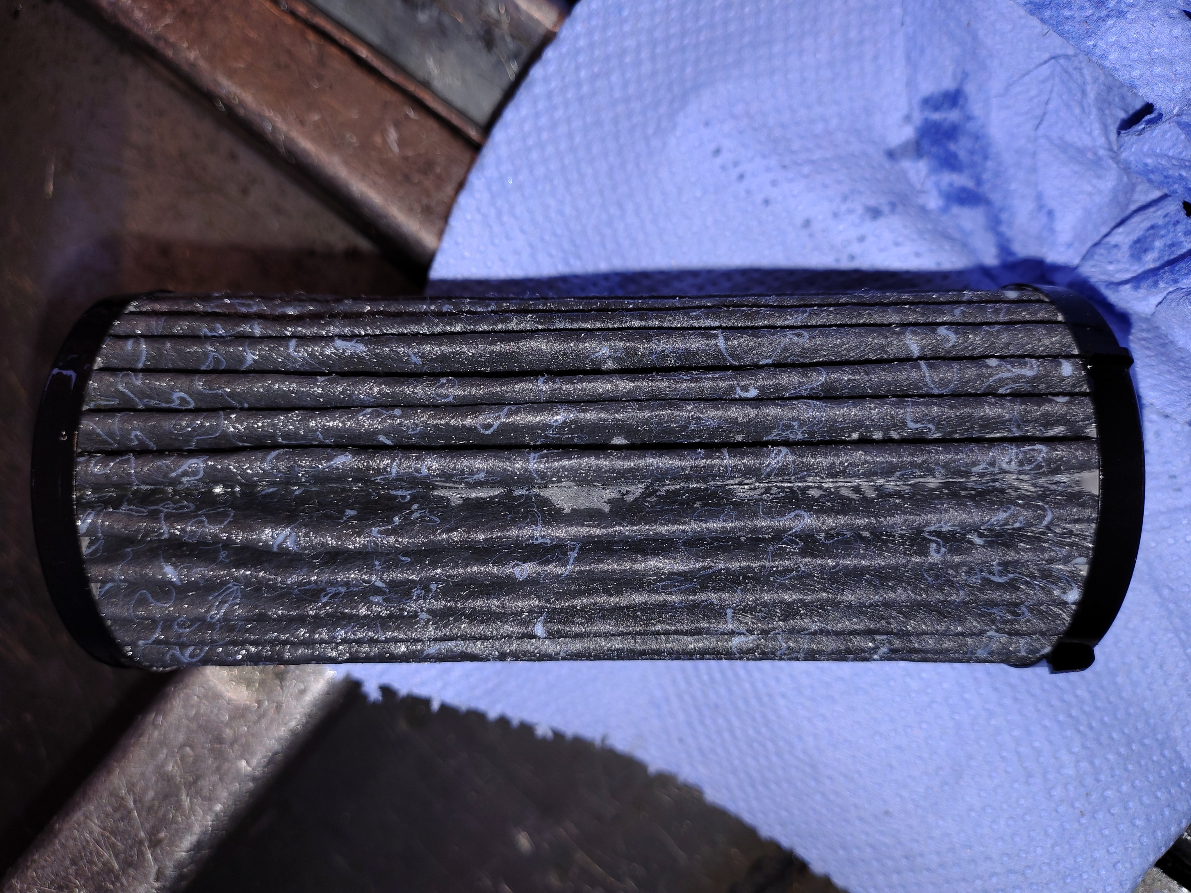

I had my DQ381 serviced at 6 years and 25400 miles.
My gearbox was serviced by Transmission Technology (UK) Ltd.
Ken, who runs TTUK, has over 50 years experience working on gearboxes and was a very interesting and knowledgeable gent to talk to.
The cost of my DSG service was £177.36
DSG Oil: £63.00
Filter: £24.80
Labour: £60.00
VAT: £29.56
Having watched Ken perform the service, it appears very DIY-able, if you fancy tackling it, though I'll mention my local VAG specialist told me to go to Transmission Technology when I enquired about a DSG service there. Having watched the service being done, this seems slightly surprising, though it may be that there's more to the DSG service than meets my eye.
The process was mostly as the videos show, and was as follows as I watched it:
1) Remove DSG filter housing and filter. (This was the most awkward part of the job as the filter housing was difficult to remove. Access was from under bonnet above engine.) The filter was clear of debris, as far as I could see. (See pic. The replacement filter was a plain white filter. )
2) Clean filter housing interior.
3) Fit new filter & replace housing.
4) Raise car to allow access underneath.
5) Remove level plug from DSG level aperture.
6) Remove drain plug from DSG and let oil drain. As I watched it drain, the old oil was light-gold in colour and appeared very clean, whereas the replacement oil was slightly darker. (I questioned this and was assured it is normal.)
7) Replace drain plug.
8) Attach replacement oil pump kit.
9) Start engine, and with engine idling, pump new oil into gearbox.
10) When correct quantity of oil has been pumped in, remove pump kit and, allowing oil to drain from level aperture to correct level, replace level plug.
Note: I suspect this is where you will need some expertise in judging precisely how much oil is in the gearbox, and it is quite possible that there is more to it than simply letting the oil drain until it no longer comes out of the level hole.
For a simple oil change on a DQ381, Ken told me you don't need to worry about checking oil temperatures, that is only needed when the gearbox has been disassembled in some way, where oil may not have reached all the nooks and crannies in the system and greater care is needed to ensure that there is the correct amount of oil in the gearbox.
Additionally, Ken told me that the recommended service interval on a DQ381 is 45K miles, not 80K.
If you disagree with that, I suggest you argue it out with Ken, I'm just reporting what he told me.
Incidentally, I asked Ken about my practice of always putting the gearbox into idle at junctions, as I could feel that the clutch is not completely disengaged when in drive with the brake pressed.
He confirmed that the clutch is indeed NOT disengaged when the car is in Drive with the brake pressed. He added that it wasn't a problem to leave the car in Drive with the footbrake on for short periods, but for traffic jams, putting it in Neutral was recommended. He also said that putting the DSG into Neutral at every junction would extend the life of the clutch pack. (Which I had already worked out, but it's nice to have an expert confirm it.)
Judging by his experience, Ken is pretty much peerless (certainly around my area) when it comes to transmission work, and is able to resolve just about any gearbox issue on any vehicle. He does full gearbox rebuilds, sorts out mechatronic issues and will take on gearbox repair jobs that other garages will insist can only be solved with a new gearbox. The phrase, "What he doesn't know about gearboxes isn't worth knowing.", springs to mind. He talked about how much time he spends keeping himself up to date on gearbox tech and he's a man who has clearly devoted his life to vehicle transmissions.
Downsides? For the patient person, none. However, Ken has been working since the 60's, and sometimes he can be hard to get hold of. My first appointment with him didn't happen because he took the day off for personal reasons. (When I got there at the agreed time, the place was shut and there was no way to get hold of him.) I turned up on spec on another random weekday, just to meet the guy and size him up after the first failed appointment, and again the place was shut, despite it being during normal working hours. Still third time lucky, though I did make sure to phone him up before setting off. 😄 I laugh, but it wasn't a good start, and had Transmission Technology not been recommended by my trusted garage, I'd have been tempted to go elsewhere for my DSG service because I don't like unreliable people.
I note the reviews of Transmission Technology are a mix of delighted customers (the majority) and people who failed to get hold of him (a very grumpy minority, which I nearly joined). Ken's an elderly gent who he has skills that can't easily be found elsewhere. I suspect he's got to that stage in life where he works as and when he wants to, rather than because he has to.
If you have a gearbox problem, if no one else can help, and if you can find him, maybe you can hire Ken.

A couple of points I'd make on Ken's advice.
VAG make the boxes and VAG say 80k miles so the service schedule is 80k miles. Others may advise to change early, and I agree with them, but that doesn't change the schedule. Personally I'll do a 40k or 4 years having owned 12 DSG's. That's what I feel comfortable with and the same reason I don't do variable servicing.
Wet Clutch boxes do have a slight drag in Drive, that's how they are designed, this is mainly hydraulic drag as the plates are lubricated, the plates are not grinding away on a flywheel. On the dry clutch box the plates are clear in D at idle. Other independents and some respected tuners and rebuilders have monitored fluid temp rise at idle in D and concluded even for a few minutes there's no significant rise. I've also seen it suggested that worn out clutches are extremely rare in the DQ381, they will reliably handle torque way above the gearboxes rating but mechatronic failure is far more common. Perhaps switching between D and N constantly is placing far more operations on the Mechatronic?
I suppose it's down to which you feel more comfortable doing? Potentially saving a little wear on the clutch by adding wear on the mechatronic?
And running the car as designed with stop/start enabled leaving the car in D with the engine off there's zero wear and zero temp increase. I suppose even more so if you have autohold.
I agree with @EnterName and the mechanic Ken - that 80k miles is waayyy to long for a box service. About 40-50k miles seems more prudent; however we all have differing views. Some of us are old-school and prefer to make sure that the lubrication and filters are kept clean and well maintained - on the principle of trying to keep the vehicles going for as long as possible whilst keeping our carbon footprint to a minimum. Others have the opposite views and do only the bare-minimum or exactly what is required only when absolutely necessary.

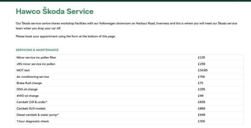

Ken is very very cheap servicing a DQ381 if he can do it for as low a cost as that.
If anyone has a Manufacturers Warranty on their car with a DQ381 as long as it is serviced with the correct parts / fluids by a VAT registered person in the UK then hopefully they will accept that and not try invalidating any claims.

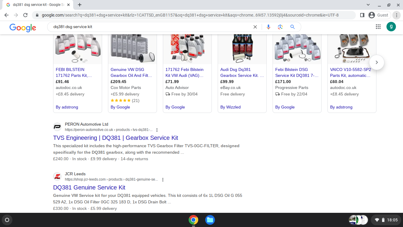

For VW in Europe/UK (so, Audi, VW, SEAT, Cupra, Skoda) the interval for the DQ381 is 80,000 miles, with the filter to be replaced every second service (aka 160,000 miles and 320,000 miles, should it make it there).
Technically the filter is not a serviceable part, but the three dealers that I spoke to all said they do the filter at 80,000 miles regardless.
Either way, my car is just about to cross 40k and I've got it booked in to have the oil and filter changed. This is purely preventative maintenance, for my own peace of mind, done with VW oil and filter. Sure, the FB and Millers kits are likely just as good, but if a job is worth doing...
I'm personally a bit skeptical that every single other DSG box is 40,000 (wet or dry clutch, aside from the knackered for life) but yet the DQ381 is somehow 80,000. I drive mine quite hard, so doing it early won't hurt anything. Frankly, I'm more interested in the age rather than the mileage - 80k could be done in two years, but it could also take a decade or so. That's a long time for oil.
Sources - three Skoda dealers (one SEAT/Cupra/Skoda), TVS Engineering and three independent VAG places.

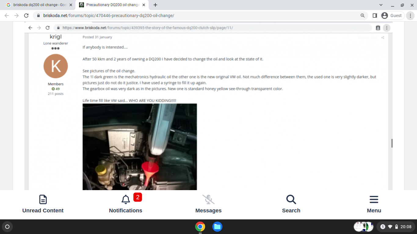

The change was from Synthetic to mineral. '34F5'. started 2014 in the UK on ones 2009-2012.
Late 2012 not done. then 2013 with synthetic '34H5' was started in 2017, a software update.
Plenty pics of oil changes in DQ200,s on this forum.
Yes the colour changes, and there is lots of mess around the Dry Clutches.
Plenty couple of hundred thousand mile DQ200,s about.
The failure rate was bad, but nothing near the DQ381,s.
Different though, 2009-2012, selector forks, clutch packs, fuses etc. the 2013 on the actuator & MCU being the common issue. and the 'Famous DQ200 Clutch Slip.' thread in the Fabia Mk3 section.
