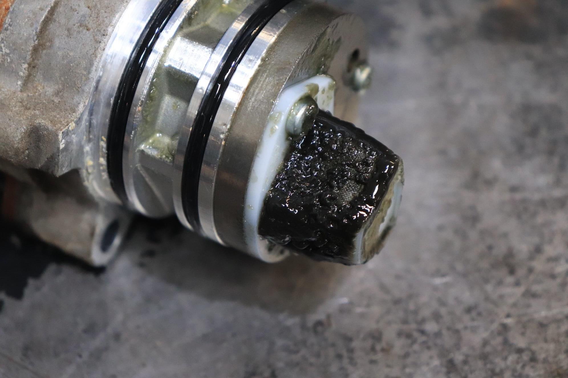

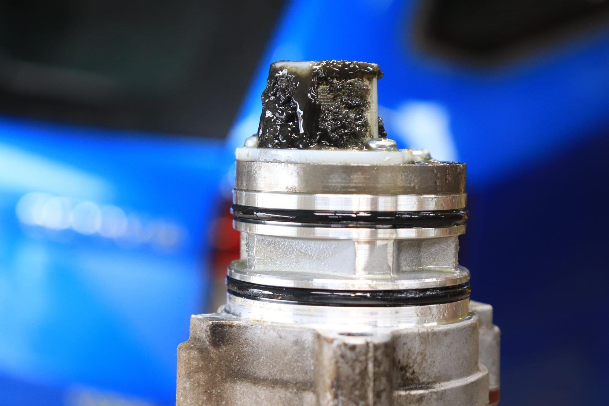

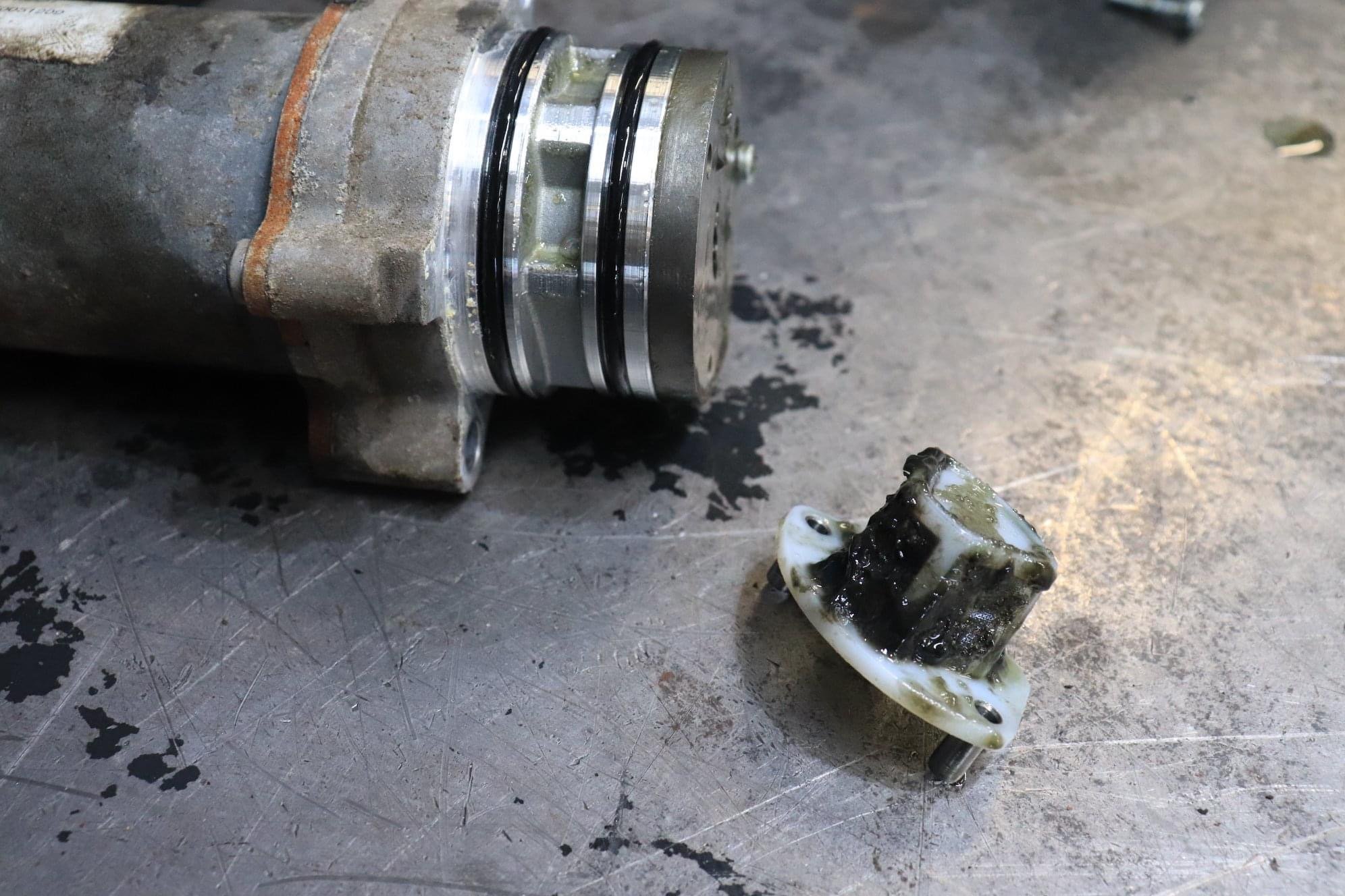

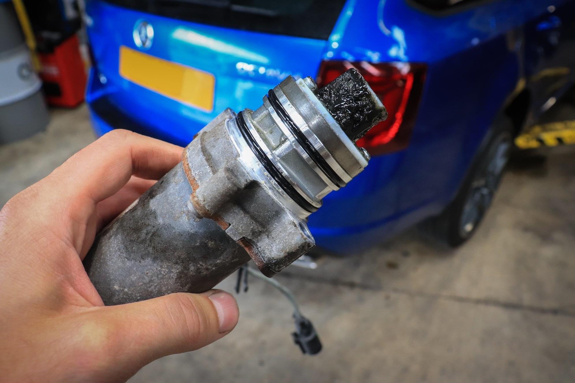

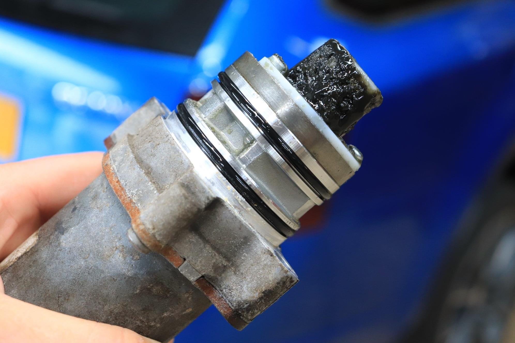

Haldex Pump filter blocked.
So glad I’m getting this cleaned.
According to Marshall Skoda Leicester these things don’t exist, and the simple oil change is enough.
Get yours checked people
How many miles is that at ?
Only 44k
unbelievable
Lots about this over in the Yeti section too. We just had a Haldex service on ours at 18K and 3 years old, but as the OP suggests that was probably just an oil change.  Will probably take it to an independent garage that will take the pump off and clean it next time.
Looking around, it’s suggested this is to be done every 10k miles. I’m certainly going to continue doing mine.

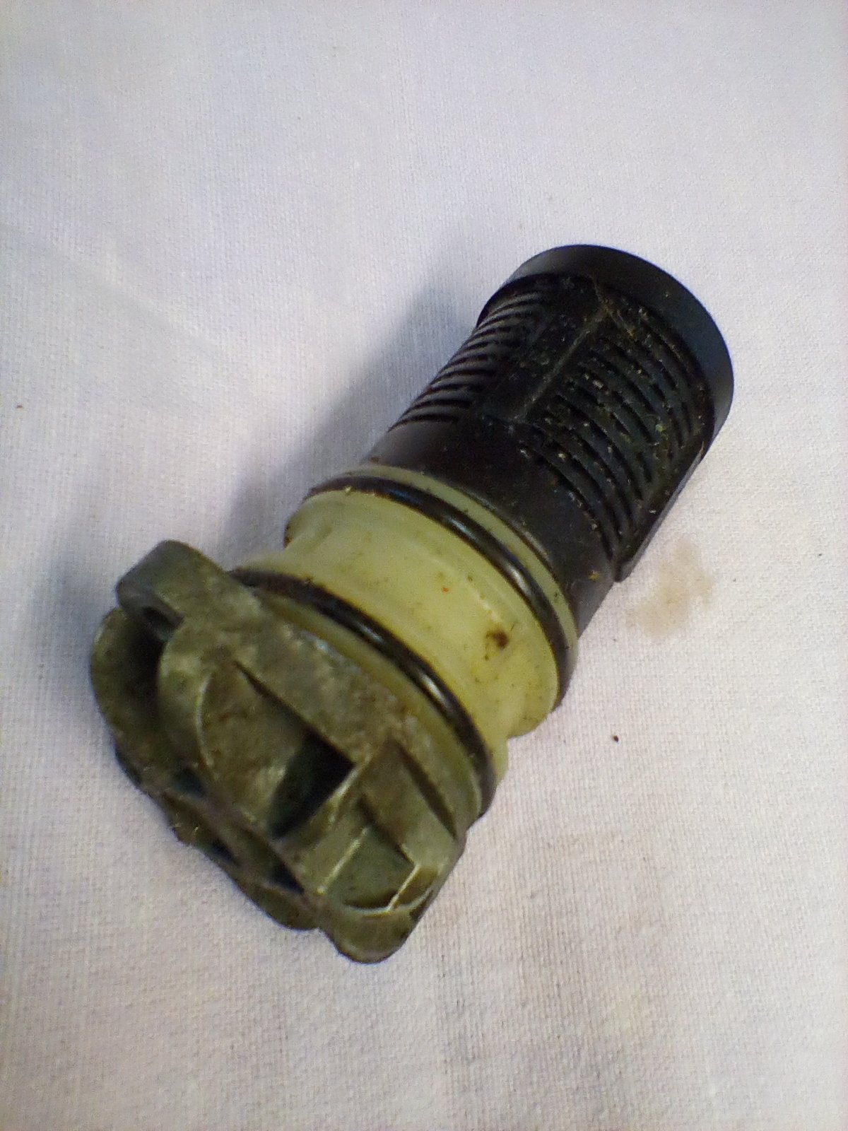

This is a picture of my MK7 Golf R filter at 4400 miles - so I suggest you get it done every 5k or so, no more.  Not single launch in this car and no mods of any kind just normal driving for a 71 year old, well normal for a 71 year old that drives an R.

All the filter photos show what appears to be thick and gloopy 'stuff' blocking the filters, what causes this to be formed?
Driving like a 71 year old :D
That is shocking Octavia5!
Maybe its not wear of the plate material but a degradation or breakdown caused by the oil?
Under normal operating conditions there will be little or no differential movement between the plates in the clutch pack and any wear is going to take part when the coupling is not engaged.

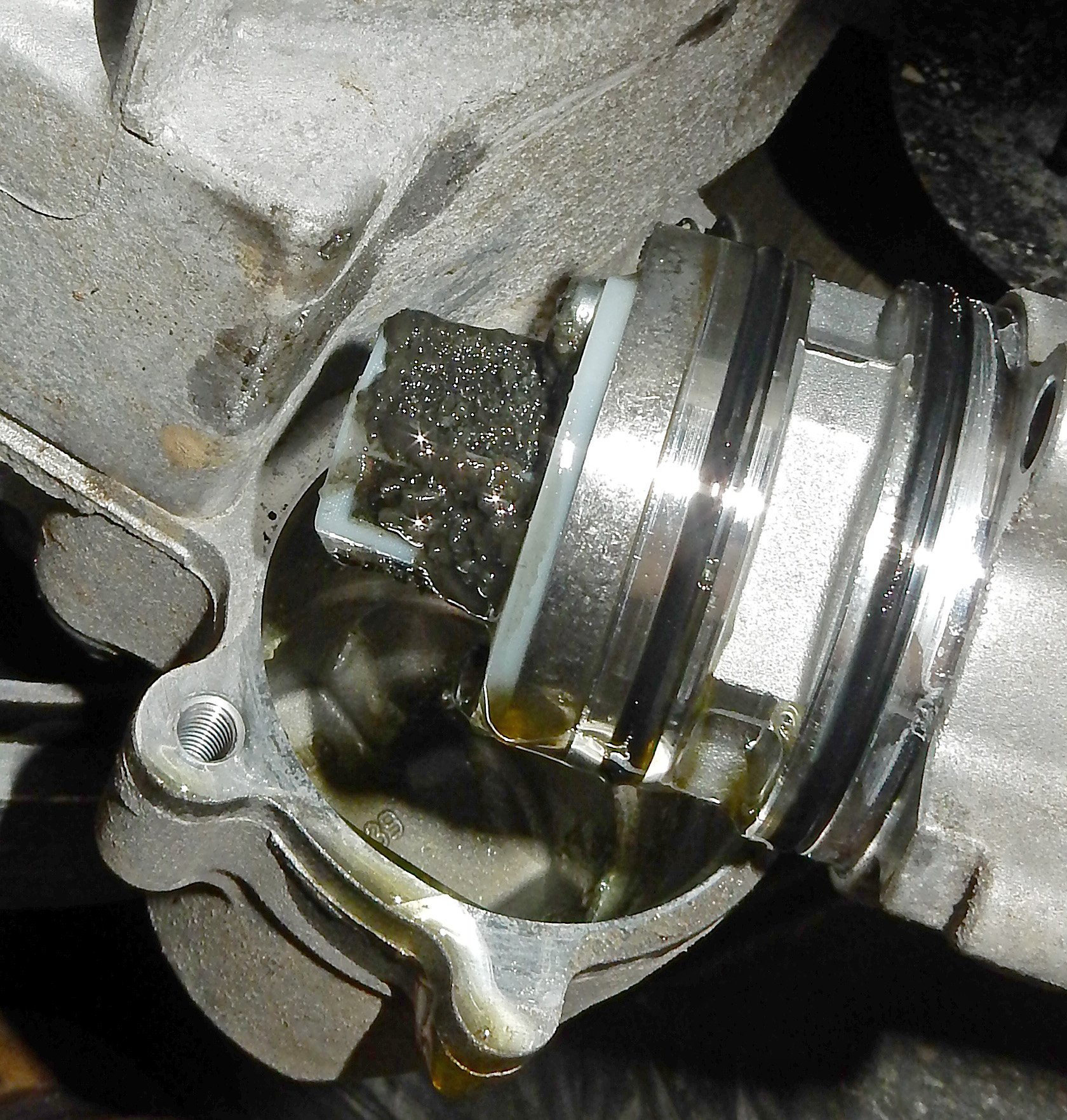

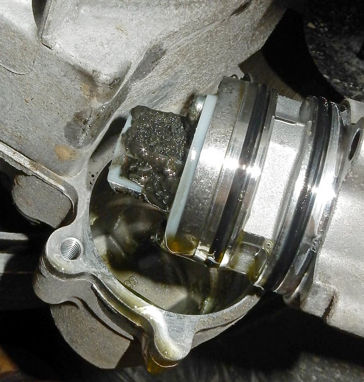

Here’s mine on exactly 20k (18 plate 4x4 Octavia vRS).
I will 100% be doing this every 10k miles, for the £100 its entirely worth it considering at 20k its completely clogged up!
My question, has anyone found the same contamination on a second service or is this a single contamination happening from new?
