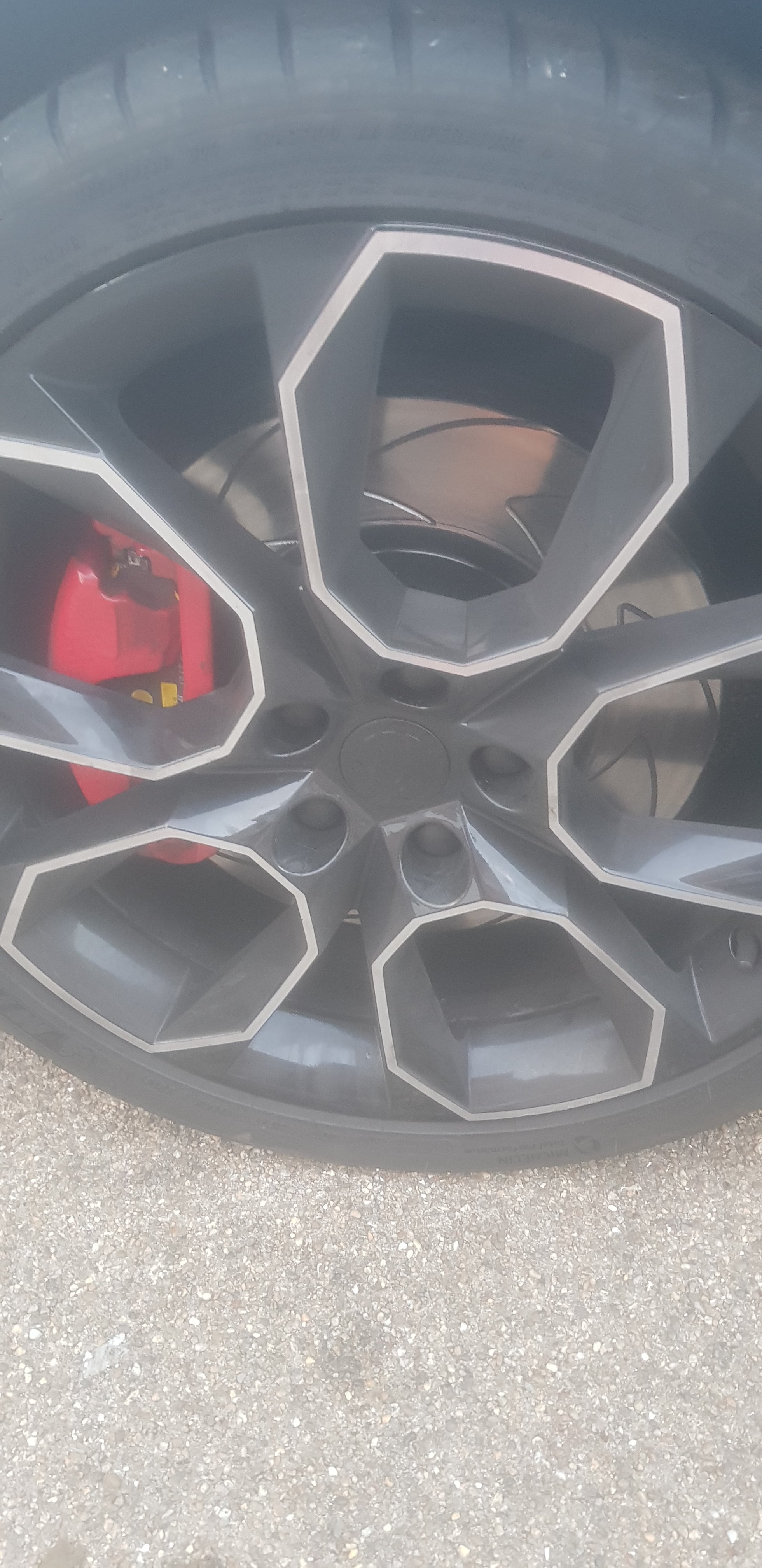

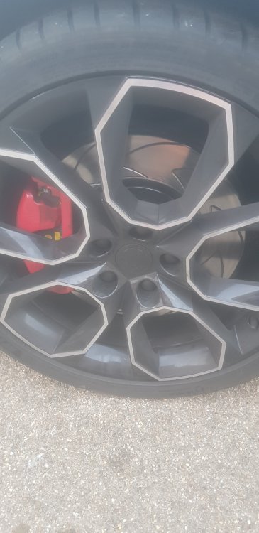

Heres a photo of my Turbo Grooved with Yellowstuff pads, I'm very tough on brakes so, these have been replaced now. They were a good upgrade in terms of stopping power but, they are dusty, might be better just running Redstuff as they are a low dust compound
