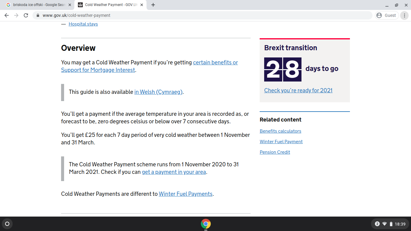

If the area you live, park and drive in is not one where 'Cold Weather payments' are made because of 7 consecutive days of at freezing or forecast to be then you might never experience such conditions.
The sun can melt snow and ice yet the ambient temp stays below freezing.
There are Postcode areas where 7 payments have been made over a winter period.
