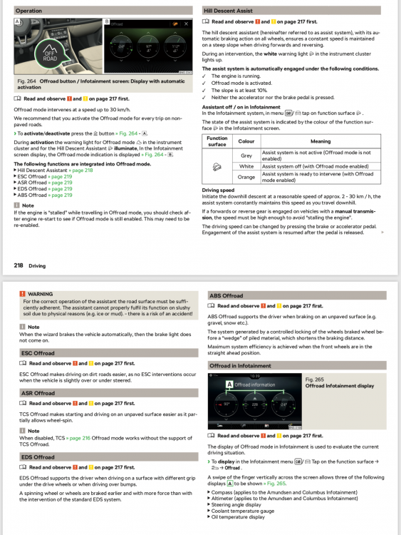

looks like from that manual, that it has an effect on ABS and other such things, you would think that would be included on all 4x4 models really

SE does not have the option at all.  I added Drive Mode Select, but that is for Eco/Normal/Sport/Snow drive modes.  No option to get Off-road switch.  This was a MY19 build.  Looking at the brochure I had when I bought my Kodiaq, the Off-road switch is not an option and only seems the Scout has it.
I wouldn't loose too much sleep - offroad mode doesn't do that much other than disable auto-stop/start.  If you have a scout - it does activate some of the hill-decent stuff internal to the gearbox, but other than this, its all the same as a standard SE spec.

It`s not.
Offroad mode not only activates hill descent assist if neccessary but it turns also all direct driving assists (ABS, ESC, ASR, EDS and I believe also Haldex) into off road mode.

It was also standard fit to the SEL when I bought mine - not just fitted to the Scout. It also changes the gearbox behaviour on DSG equipped cars.
Tried the hill decent on my SEL yesterday out of curiosity, peculiar as it keeps the same speed that you set with the throttle or brake, though nothing “to write home about”. Perhaps it’s more impressive when truly off-road and traction is sketchy, though it warns about this.

The owners manual does have a warning that “off road” mode is not designed to be used on normal roads.
It works only up to speed of 30 km/h and then switches to normal mode. No worries.
Have tried hill descent on very steep slope, works just fine.
Also worked fine, when got into swampy place with my trailer. Just like locking the differentials.
