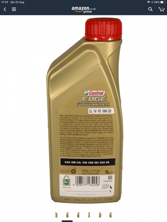

I have just topped my 1.5tsi up and the oil provided by the garage was Castrol edge professional ow-20 specifically the version that says compliant with vw508. I have been led to believe this is the oil being used when on the short service interval programme as it’s better for emissions. With no vw or similar dealer near I got it from amazon as it’s a bit of a sod to find. Hopefully somebody who knows for definite will respond
New 1.5 TSI come with the sump filled with VW 508spec oil. It appears normal for dealers to fill with VW 507 5W/ 30 oil at first service.
The 1.4 TSI will be VW 507 5W/30 spec oil.
