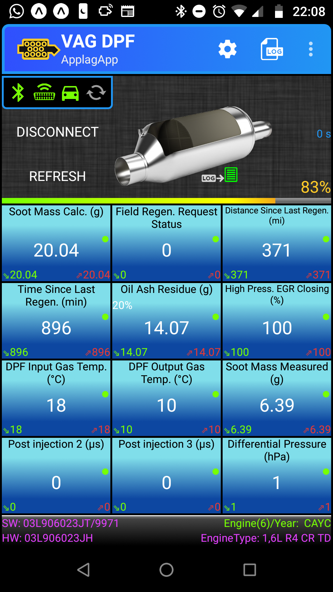

If you have an OBD11 reader and smartphone VAF DPF app gives you all information.
The screenshot here was with a cold engine, the DPF changes colour when it is regenerating.
