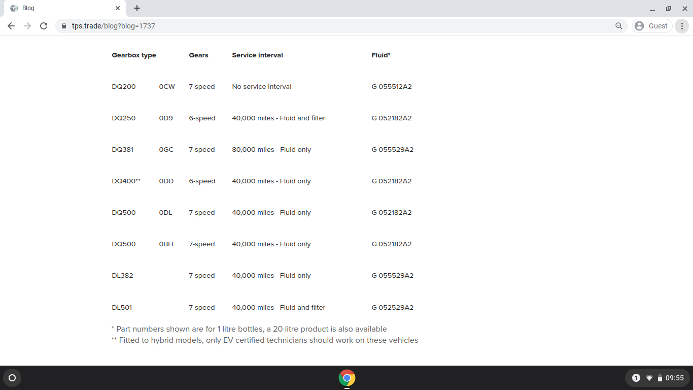

DQ200 is a dry clutch. Does this mean that there is no oil change in the service schedule cause i was also told (by the same technician) that it's  only required an oil change every 60000km
So they were talking rubbish.
The DQ200 has 2 oils, in the Box and in the MCU.   There is no Service Schedule / Guidelines for changing the Oil and never has been.
(There was a World Wide Recall 2012/13 and Service Campaign in Europe 2014 to change the Factory Synthetic Oil to Mineral.)
So no oil changes.
