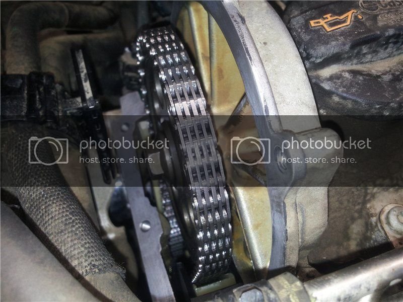

Have a look at these pics & you’ll clearly see the difference between the original fitment & the new one with the larger end section. Can this difference in length stop the rattling?

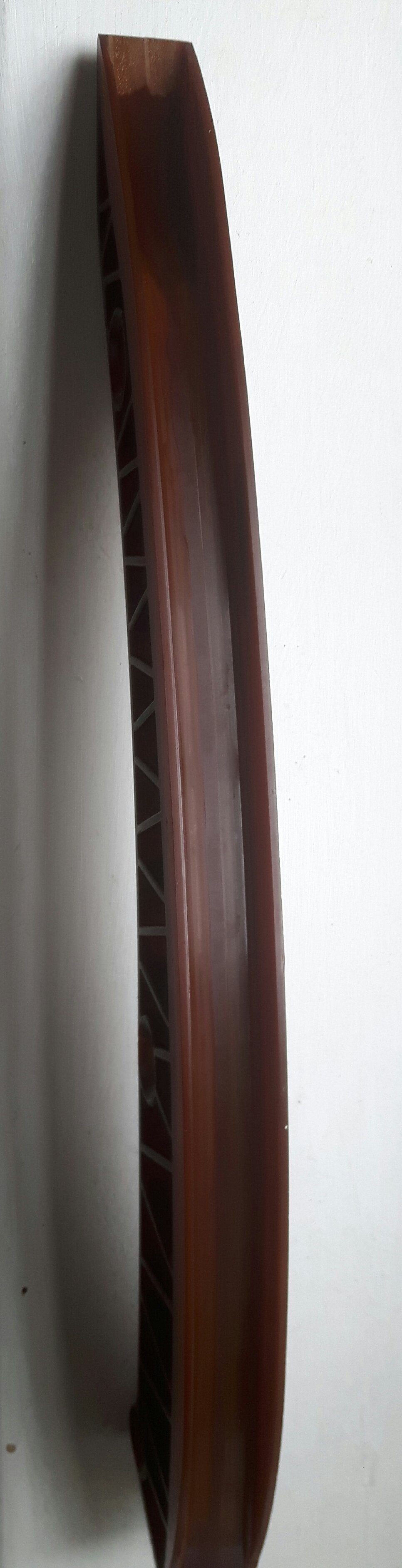

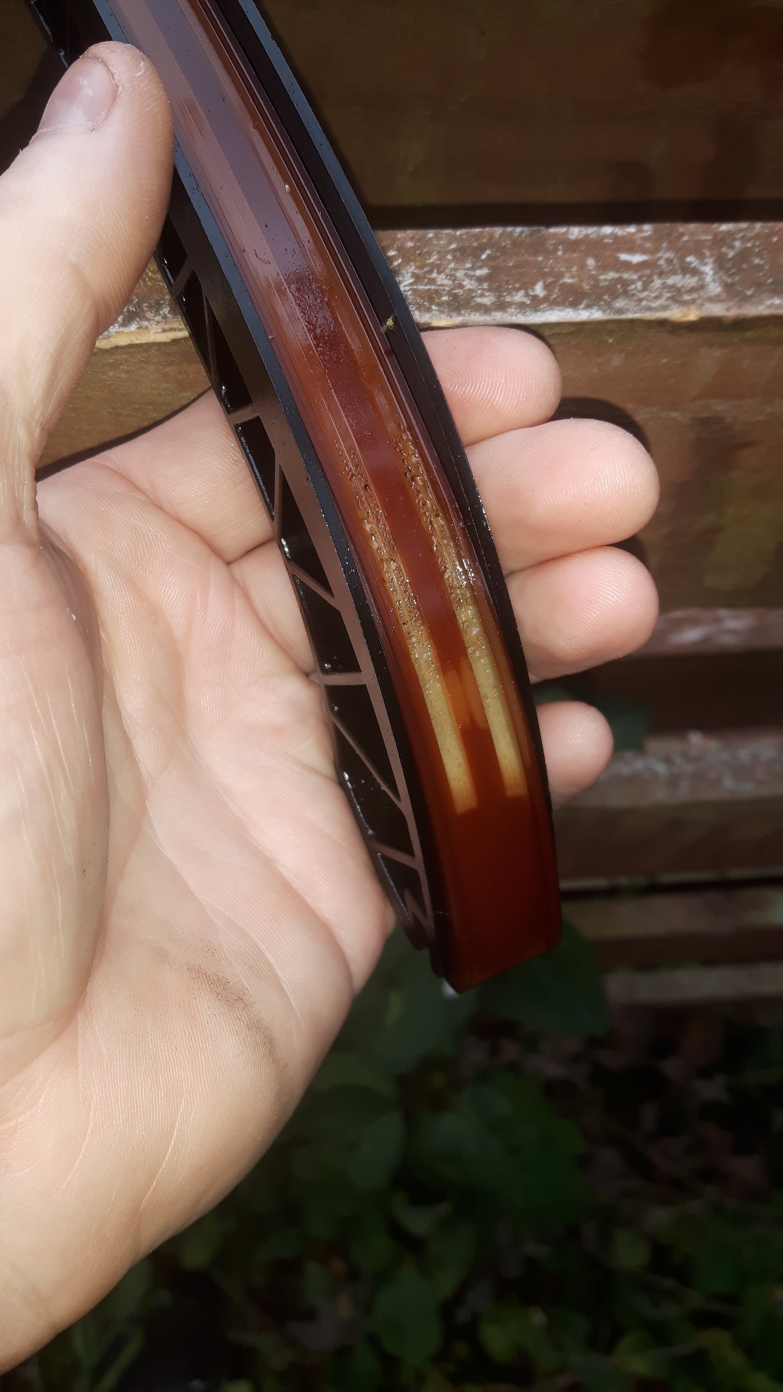

I expect the guide rails are indeed faced with a PTFE-like material.  They do still wear though, I changed the chain and associated hardware on our 1.2 HTP mk1 Fabia this summer, and there was wear on all of these plastics. Wear on the guide rail on the driven/taught side of the chain seems most relevant as that probably has more impact on the crank/cam timing correlation than the actual elongation of the chain.
Having said that, the simplex chain on our car seems much more likely to carve channels as there are only two contact points, compared with several on your 'fancier' chain which will load any given point/line on the plastic less.
I don't seem to have a photo of the wear on that rail to hand, but here are some channels carved at the point directly opposite the tensioner, on the other rail; probably the highest side loading point. Less significant for cam/crank timing I think

I have no idea what those numbers mean in real physical terms. The chain at 175000 miles had very, very little elongation compared with the new:
However, when trying to insert the crank locking pin with the cam locking ones already in, it wasn't possible with the chain on, and probing about with an Allen key instead of the locking tool suggested that the slot in the flywheel it's supposed to engage in was about 4 or 5mm advanced relative to where it needed to be for the tool to fit.  That's not necessarily much of an angular error though, as the crank sensor position is towards the outer edge of the flywheel (I've not done the sums on that).

Indeed, whatever the facing material is, it will wear. From your photos the facing material looks like a Phenolic resin-based material. Phenolic resin-based materials have been around for years. The best-known one is Bakelite. If it is Phenolic resin based it is most likely the cotton fabric-based version. Very tough & hard wearing. I came across this stuff years ago in bearings used in model plane/boat engines. Standard rivetted or folded cages tended to fall apart rapidly at high RPM. Phenolic caged bearings lasted 5 times plus longer.

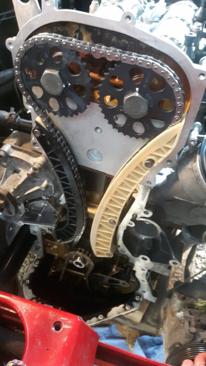

I’ve looked at the procedure to change the chain on my CBZB engine & it took me a while to fathom out that there were no timing marks on the crank/camshaft sprockets or keys to positively locate the sprockets. Then came the light bulb moment of realising with the camshaft locked in place & in the case of the CBZB engine a wedge to lock the crank, there’s no need for positive timing location marks. Actually, remarkably simple.  Sounds like your 1.2 HTP engine used the same basic idea.

When I checked the chain guides removed from our 2011 73,000mile CZBC engine, with (sometimes massively, ready to climb over sprockets) rattly starts, the guide faces looked like Nylon 66 material, very lightly marked, far far less than 1mm wear just detectable by finger and the inverted tooth chain not obviously sloppy or twistable by much. Removed top sprocket looked fine but I wasnt shown the bottom sprocket as I didnt see it in the box of removed bits or missed it. Apparently its the bottom sprocket that wears when the chain is loose and hangs down a bit. The tensioner appeared to be fully extended and I couldnt push it back (using thumb and forefinger)

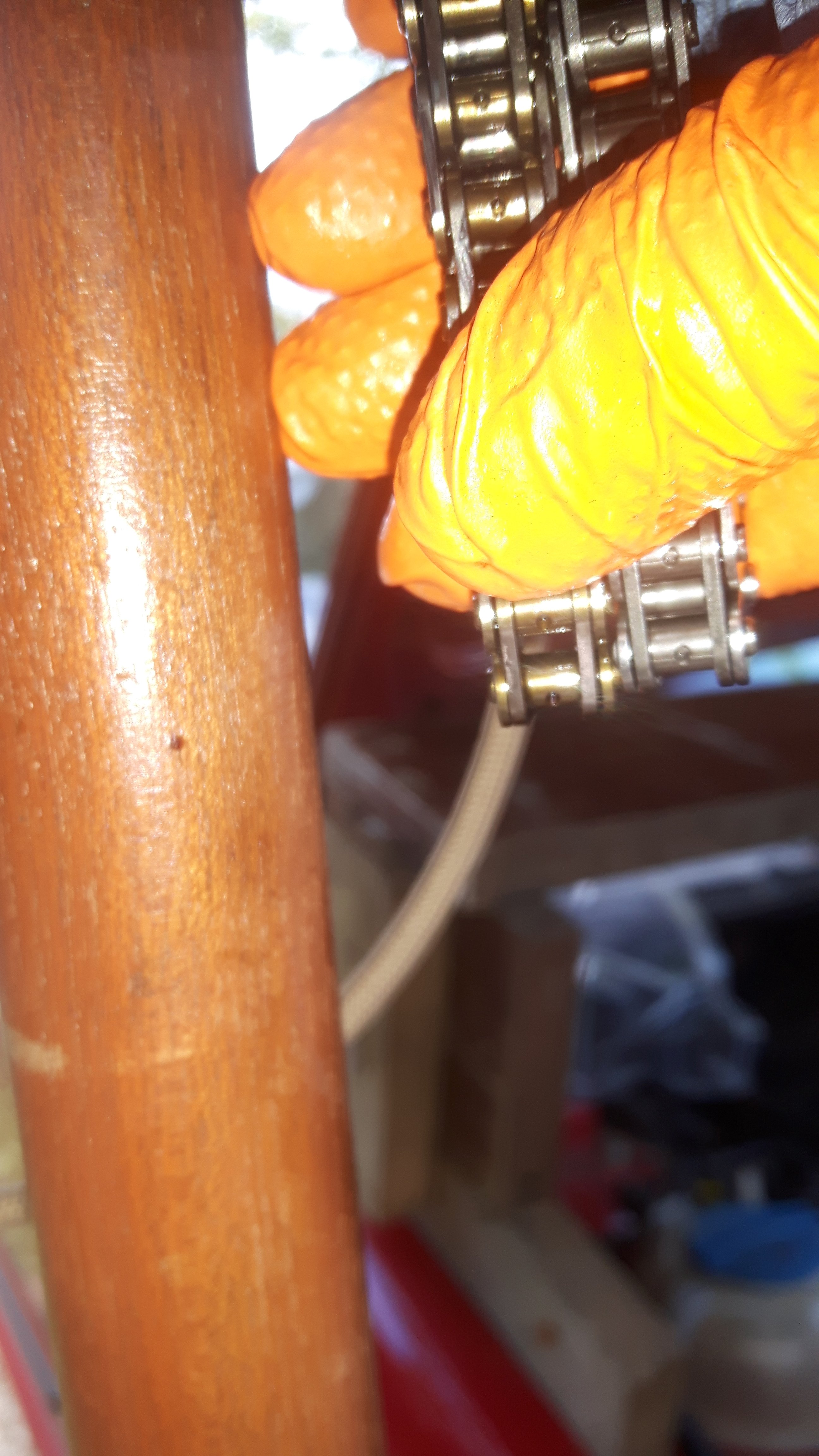

I've just dug out the other rail, the 'tight side' one and there's barely any wear at all on it, I guess because there's no equivalent single point where any side force is applied, unlike the tensioner rail. Just a little bit of wear right at the top.  The revised version, as fitted in the other photo is a shade longer, possibly to avoid this 'rattle zone'?
This rail looks to be the same material as the chain-touching insert in the other one, judging by the colour of the two new ones, and has a material ID of >PA 46< *
