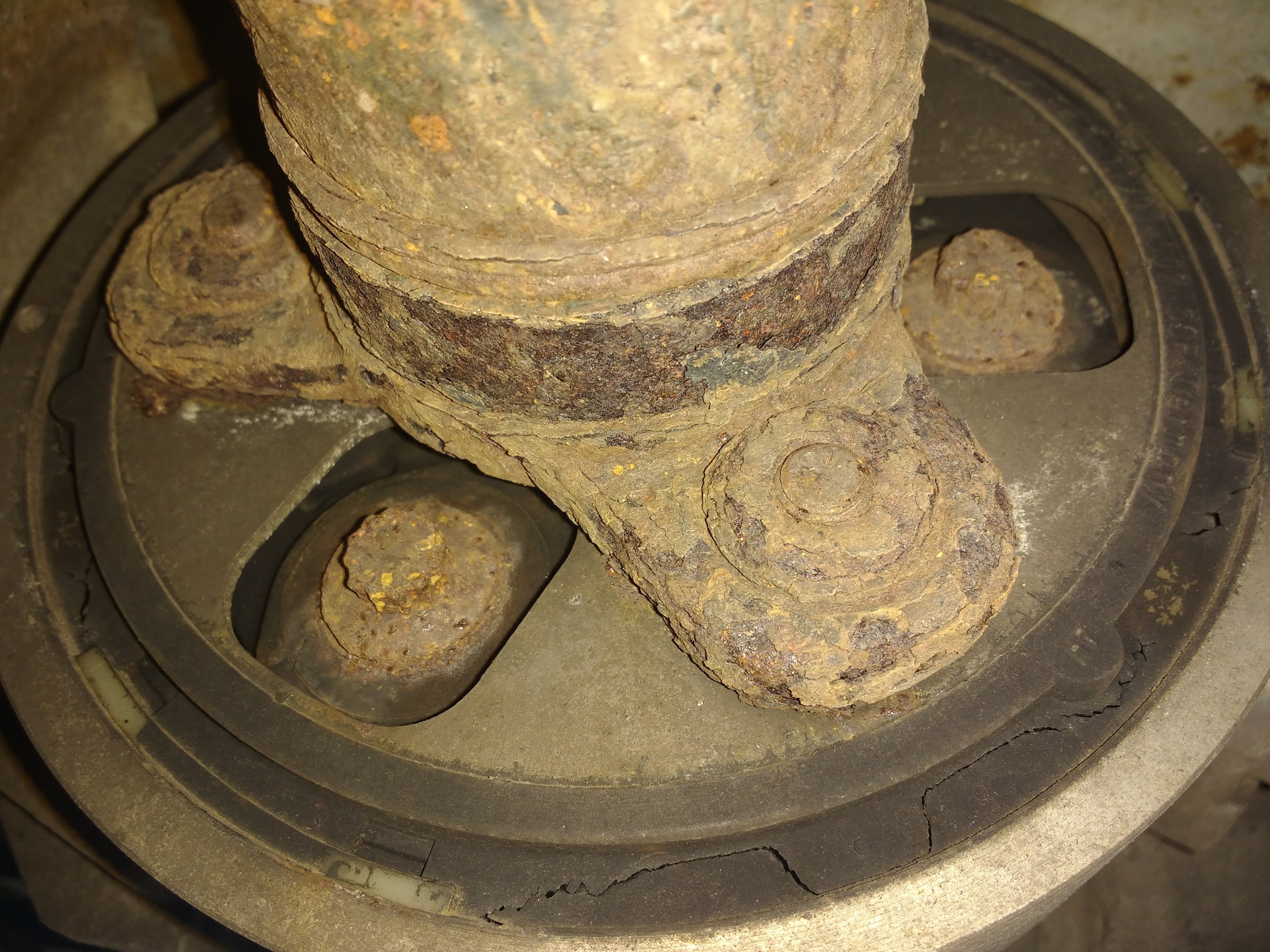

It might also be the rubber coupling between the driveshaft and the haldex.  I think it's called something like a Guibo (not sure if that's the right speeling) but it has rubber bits fixed into it (glued?) which can slowly separate from the metal casing over time.  There's a thread on here somewhere with photos of it and the signs to look for if it's failing.
I'd certainly follow up widdershins post above this.  I had something similar although I must admit it was sort of opposite as it came on when I applied power and went away when I backed off.  It was discovered when it went for its MOT by the excellent old school mechanic at the garage I use.  They are a poor components he said and fail on lots of VAG cars with four wheel drive.  Expensive part for what it is - nearly £200 as I recall.  Certainly worth a look.  Looks like this.

As for the big expensive round thing it does actually have some cracking in it but only slight, definitely worth keeping my eye on!
