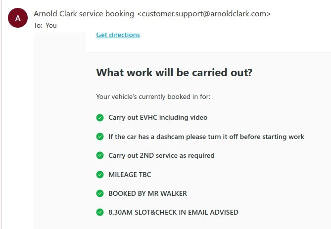

Finally after 18 months of trying i have my car booked in for Recall Actions to be carried out which were missed at what Arnold Clark / Vauxhall kept calling what the car first got as a Service,
and yet they never completed that or reset the Service Indicator.
(They still can not decide if it is supposed to be a EVHC @ 8,000 miles then next at 2 years, 16,000 miles later or at 16,000 miles.
That should have been an EVHC (Electric Vehicle Health Check) but it was their booking centre that kept talking about 'Oil changes' and probable why no EV Trained or Qualified Tech was available.
So eventually after Motability hassling me to get a Service as it is overdue i spent 2 hours on the phone with them, Arnold Clark, then the RAC who arranged an Automatic hire car from Europcar.

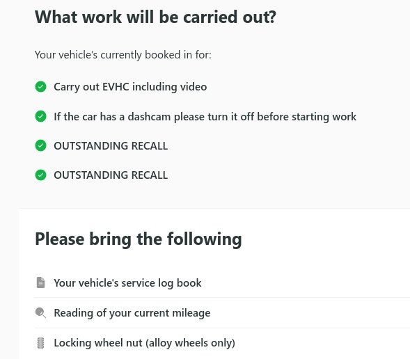

7 weeks yet before because it is a Recall Slot and not a Service even though it took Arnold Clark's Booking ages to understand a Corsa E is the old models and a Corsa Electric is a Corsa F. As in the Corsa's from 2019 on and this particular one has no engine as not a petrol.
So first confirmation was wrong as booked as a 'Service'  which would be the same crap happening as last time.
Eventually they got it right,  EVHC and Recall's, 2 of.
What is the worst they can do.
Hire car supposedly available at their gaff the night before and available for up to a week and can be extended if needed.
The job start to finish should be half a day max, time will tell.

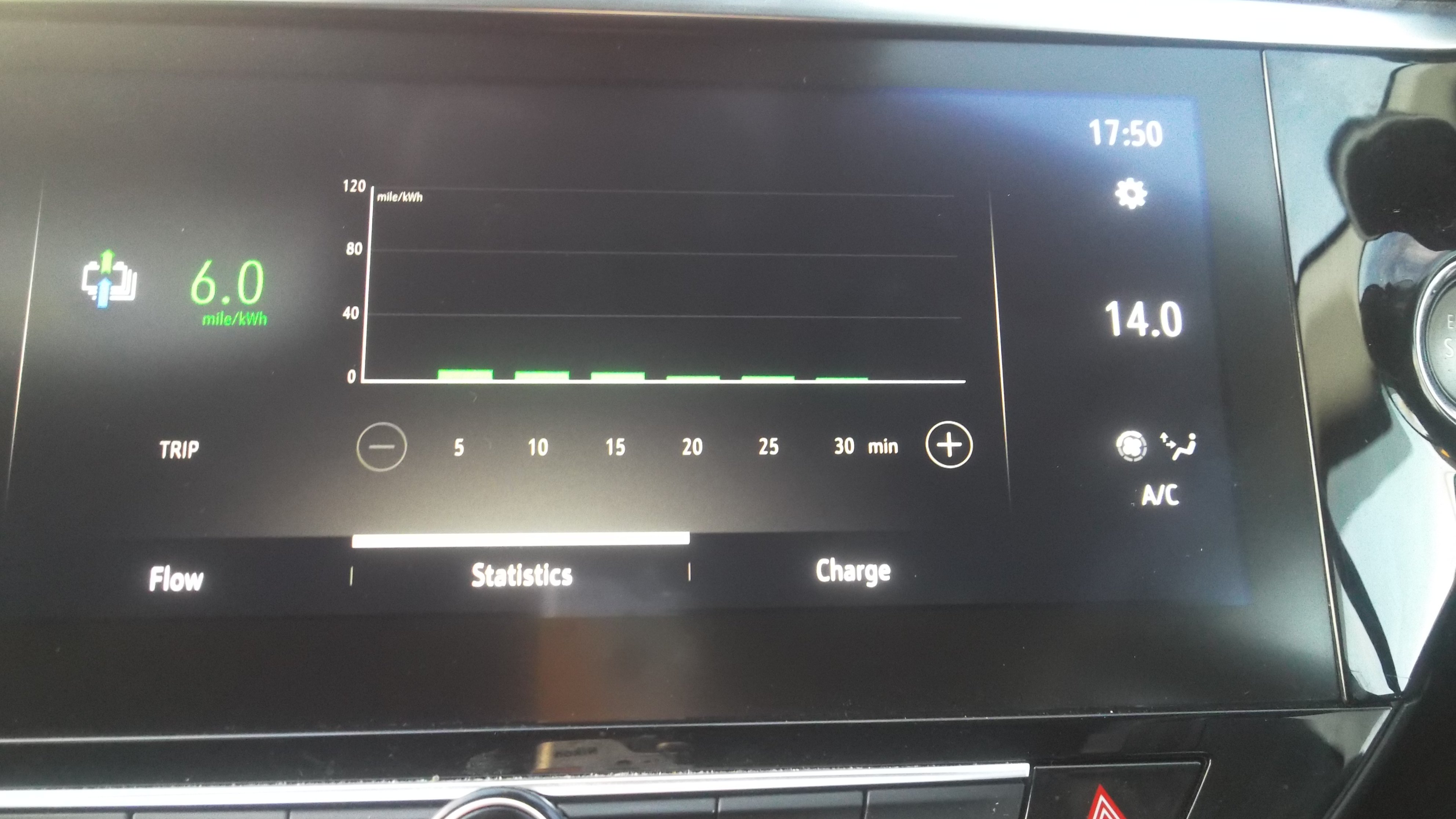

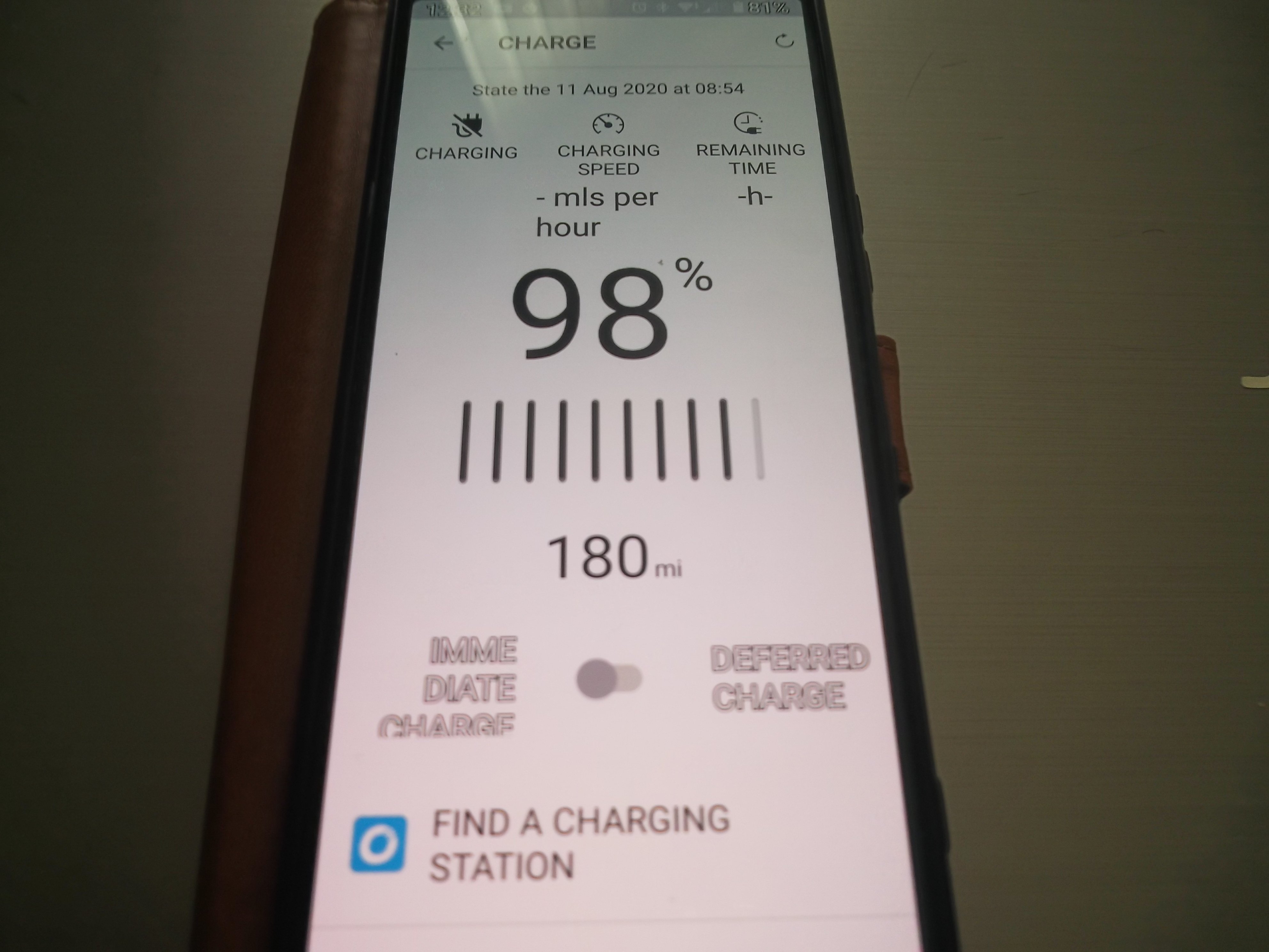

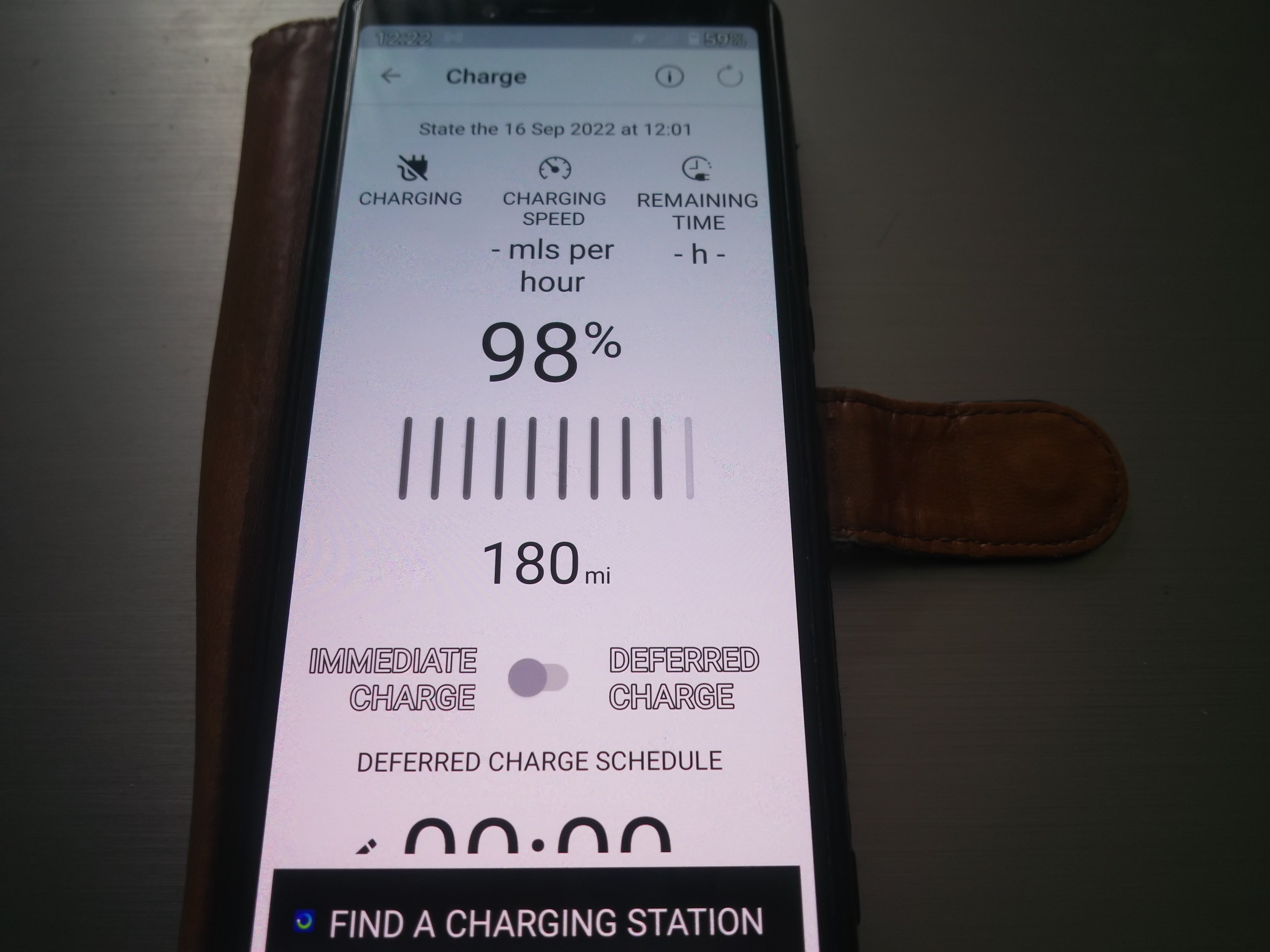

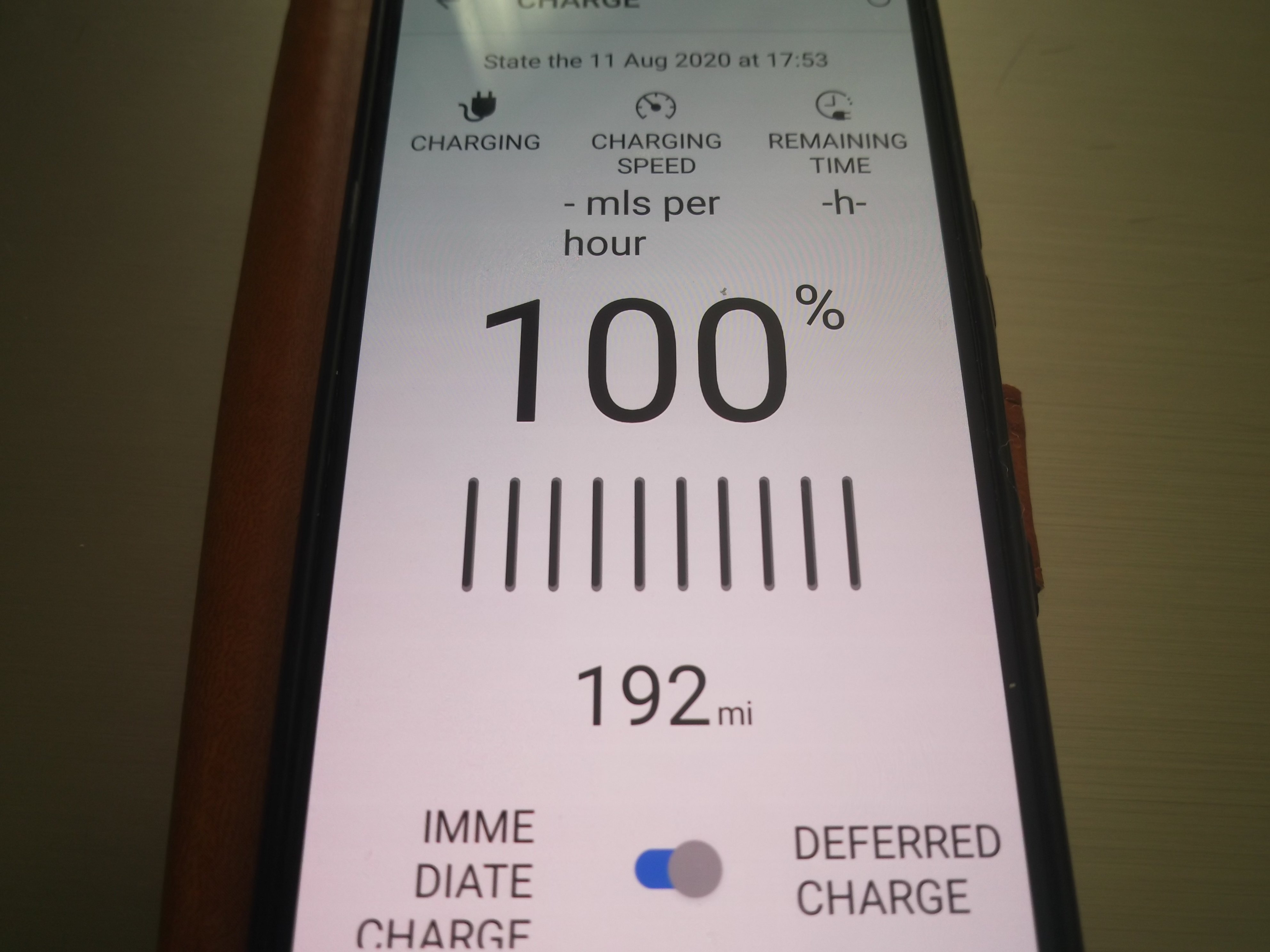

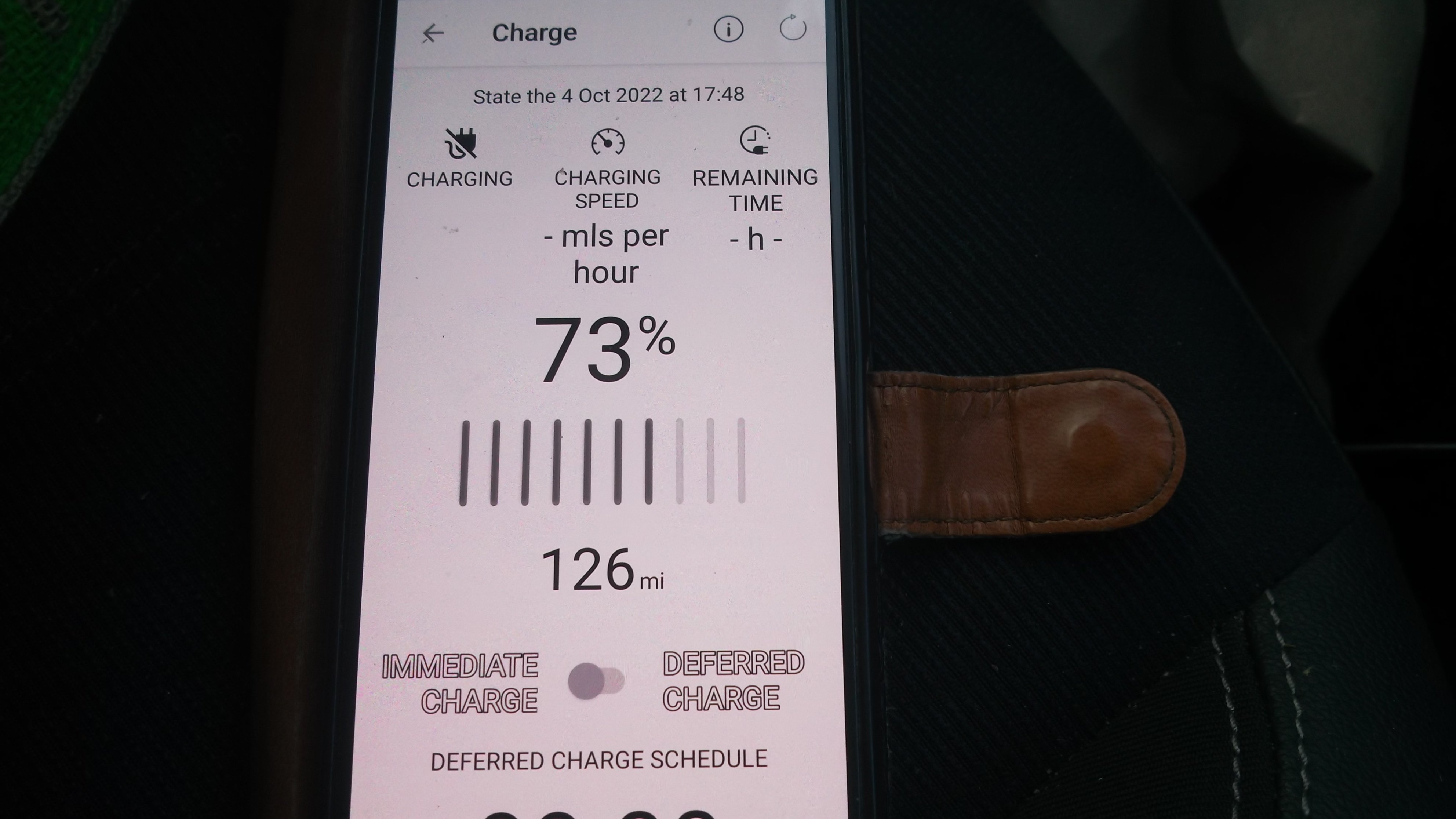

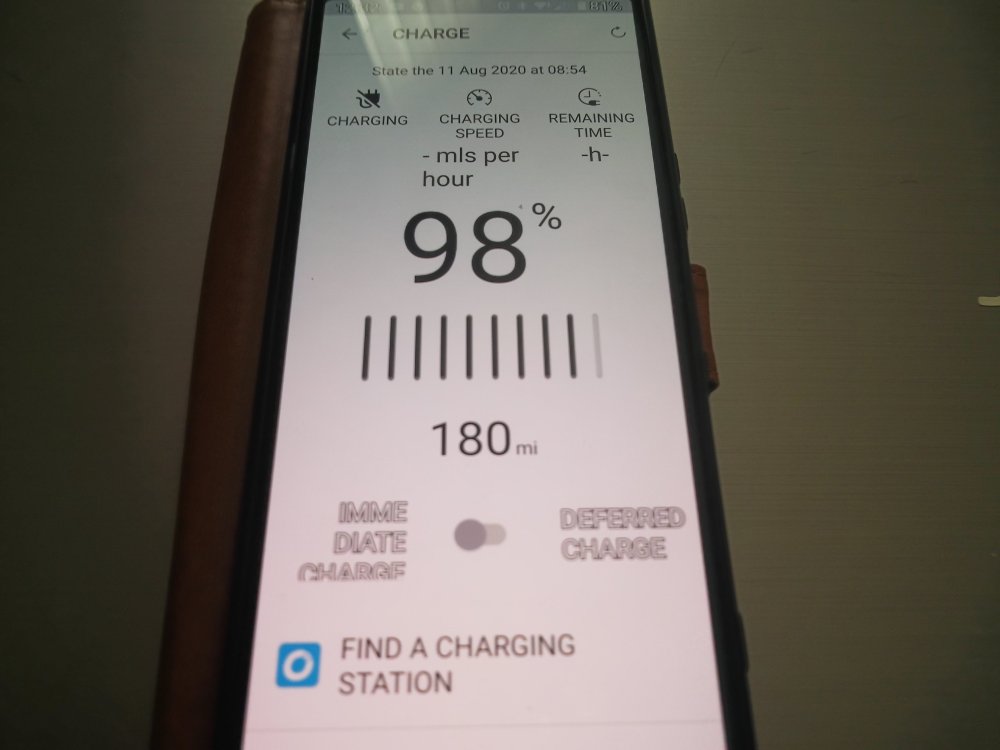

It is showing 180 miles range as it did when new and nearly full, and this i suspect is because something has happened to how much the battery is charging to and just now with weather temp at below 20*oC it is getting as good a kWh efficiency it can get without doing a trip with lots of regen possibility.
(the highest it ever has shown is 229 miles which is what the new Corsa-e supposedly is capable of. )

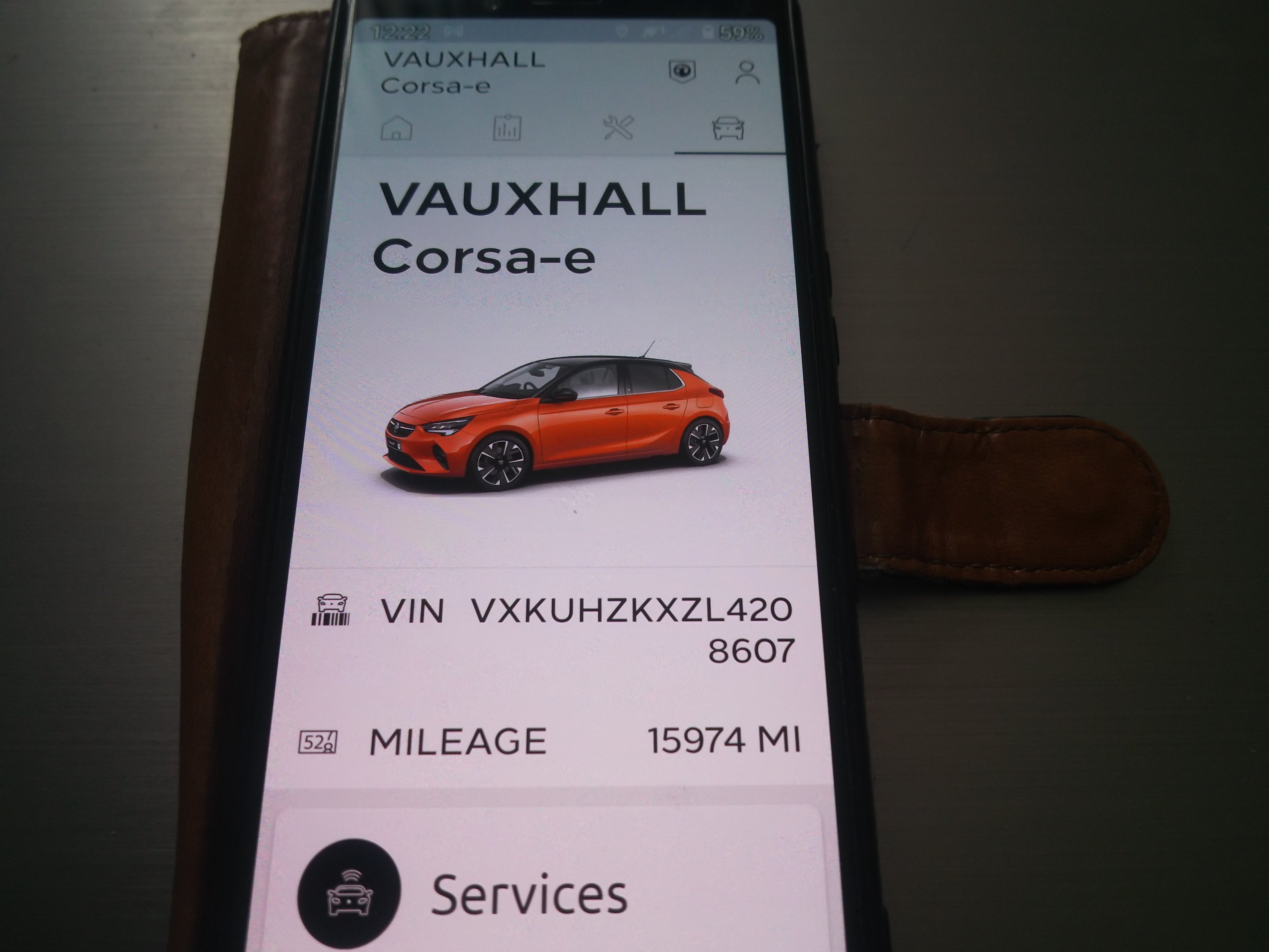

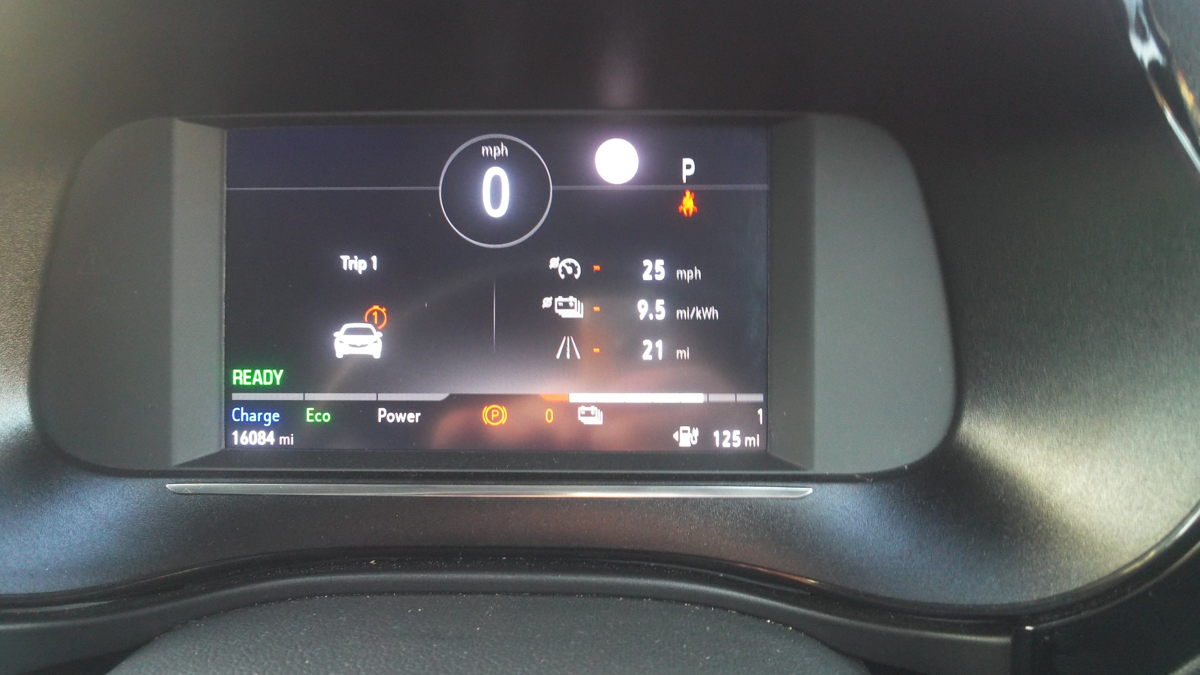

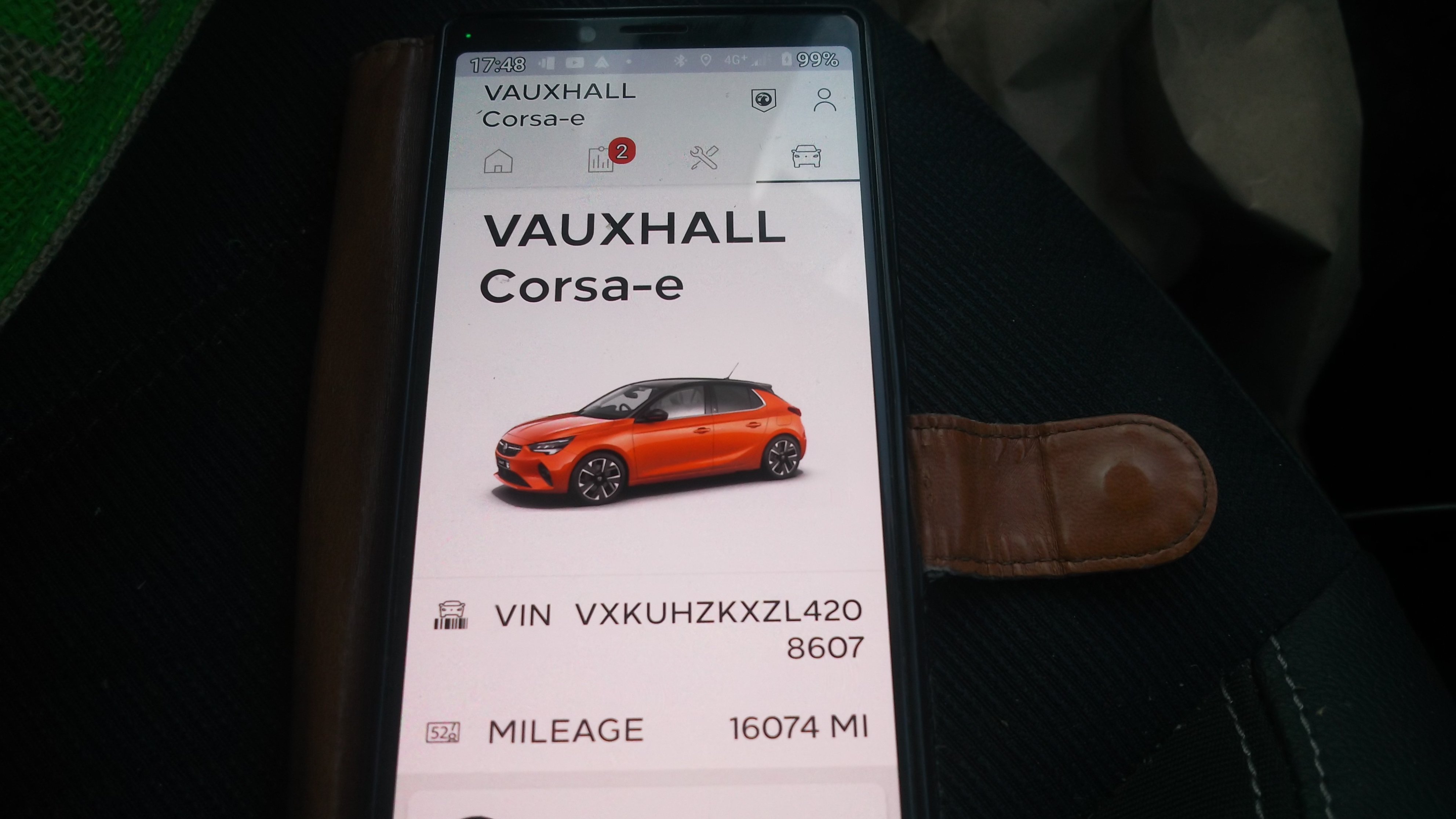

The car has lost 10,000 miles off the odometer and the app.   That might have something to do with the cars battery.
Even the App can not agree with what miles the car has covered.

I like the app with time and date printed on top. So a photo or screenshot is all you need to record the car's state.
The miles off odometer is very dodgy, it should never happen. Gotta be careful with second hand EV from PSA.

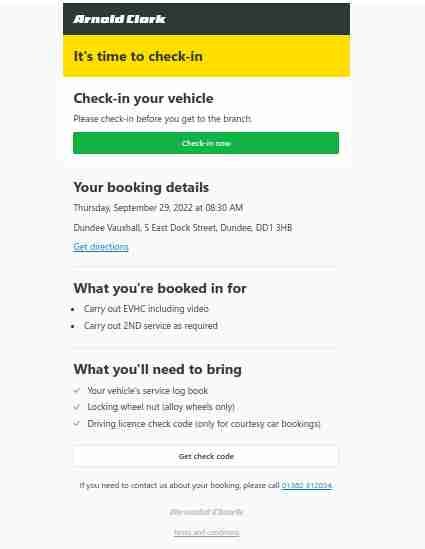

So waited all this time to get the car in this Week.

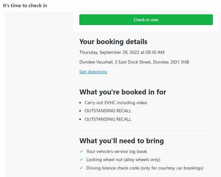

2 Recalls which were not done when in for the first EVHC which they called a Service and they never did.
So eventually the RAC are supposed to have a car there the night before from EUROPCAR, courtesy of Motability.
Tomorrow on the phone if i ever get through or a call back i might find out if the have an EV Technician in on Thursday to do the Recall Actions and a 2nd Service or EVHC or whatever.
If the car goes in and the Recall Actions are not done then the car will not be getting collected until they are.    Micky Muppet Road Show with this crowd.

So fingers crossed that all goes as it should 2, car dropped off, 2 different work shop actions done. 2nd service and Recall actions carried out and if any parts like brake pads or even discs are required Motability approve them.   Why would they not !

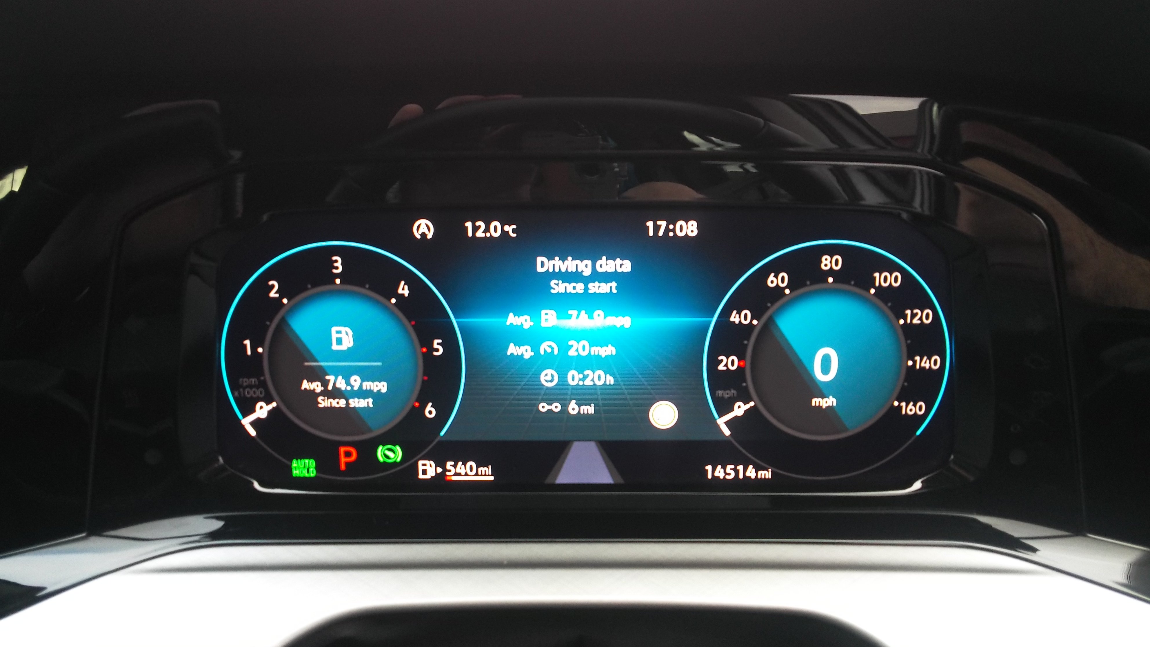

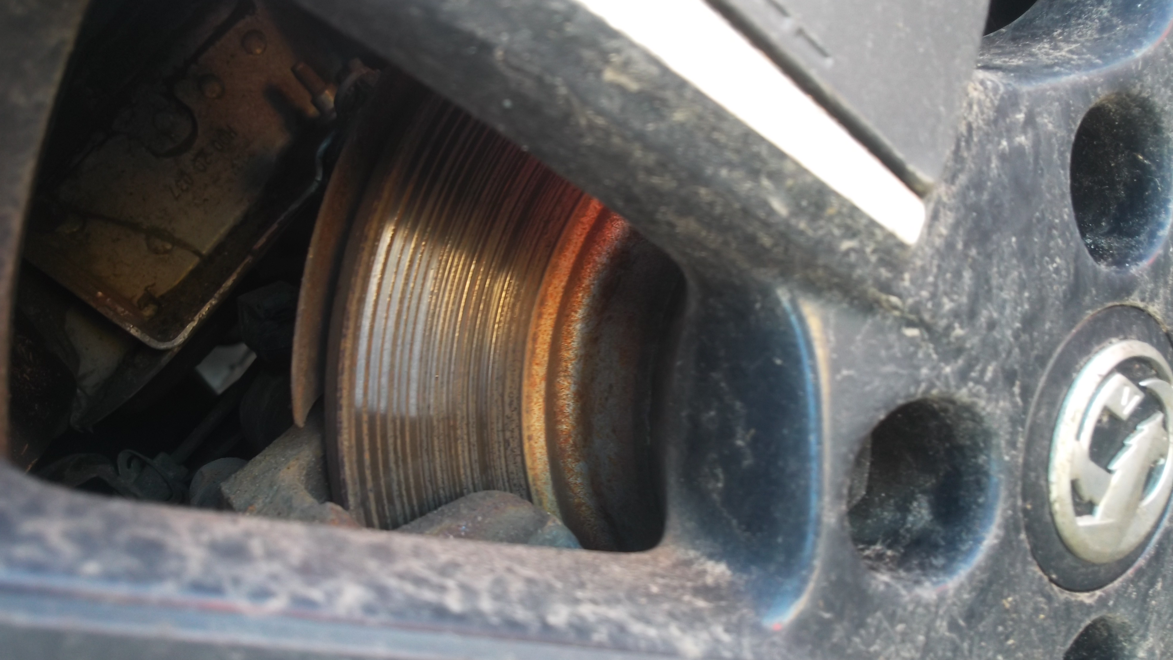

The Golf is rather good. oil service due in 900 miles. Tyre pressures were correct.
Just a 115ps TDI but shifts in S and the paddles are good but there is not much engine braking.
70 MPG will be easy on back roads 77 mpg average was when i stopped and reset things and tried to get a dash and gauges and radio station and AC and everything else.
There are buttons, far too many, and light touch stuff and touch screen.
Not for me, but comfy and handles well.

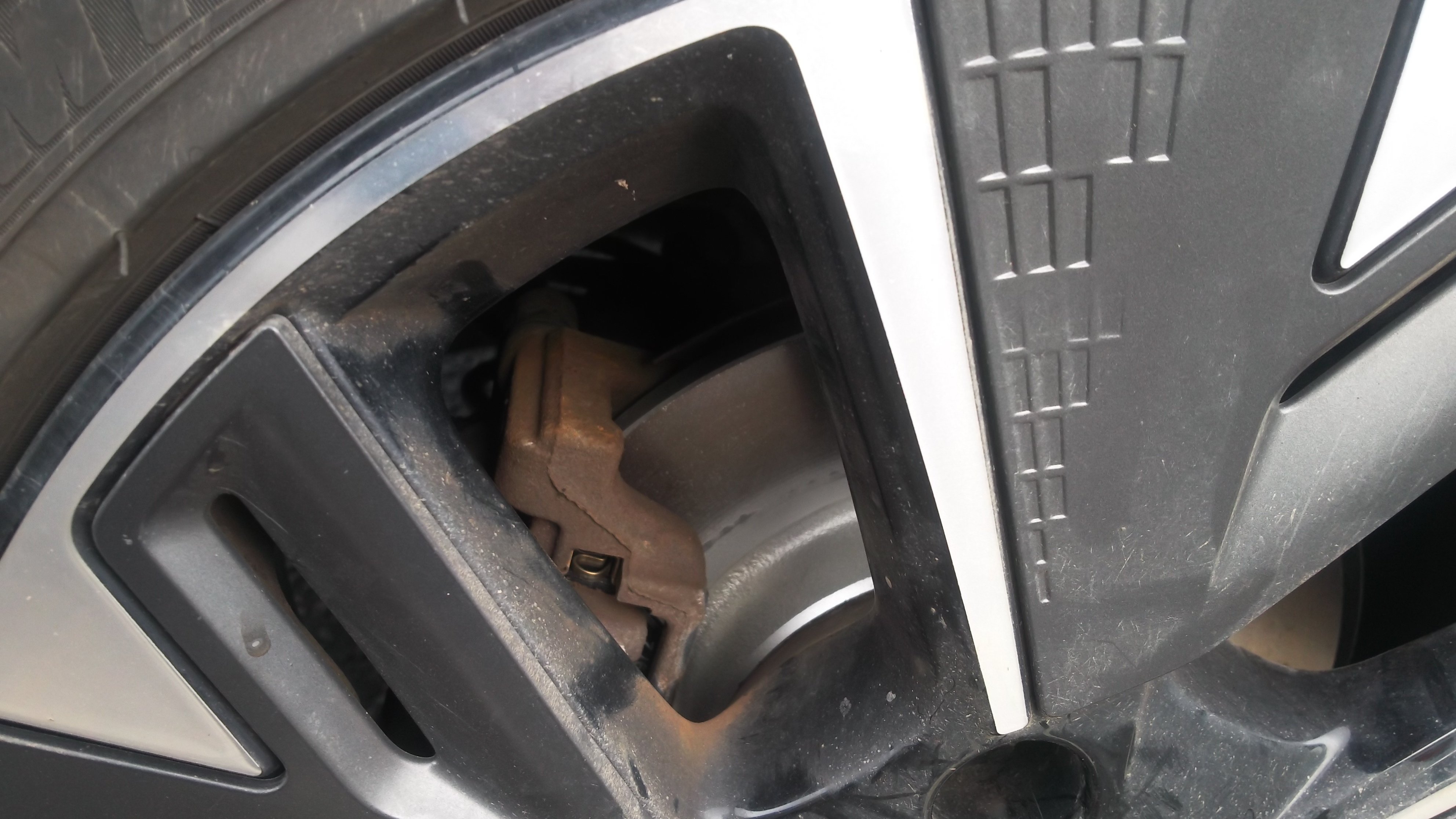

Health Check video arrived.

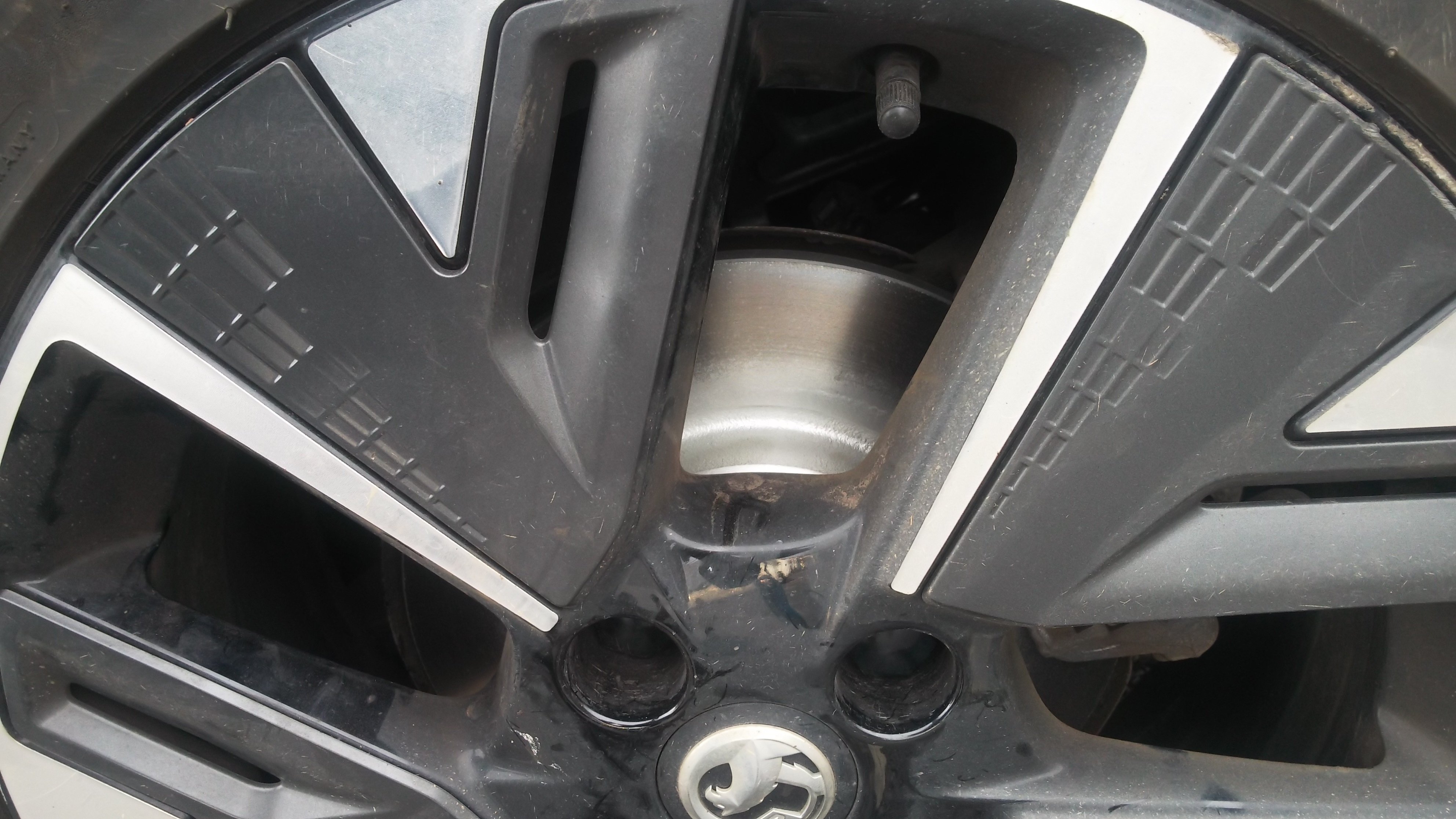

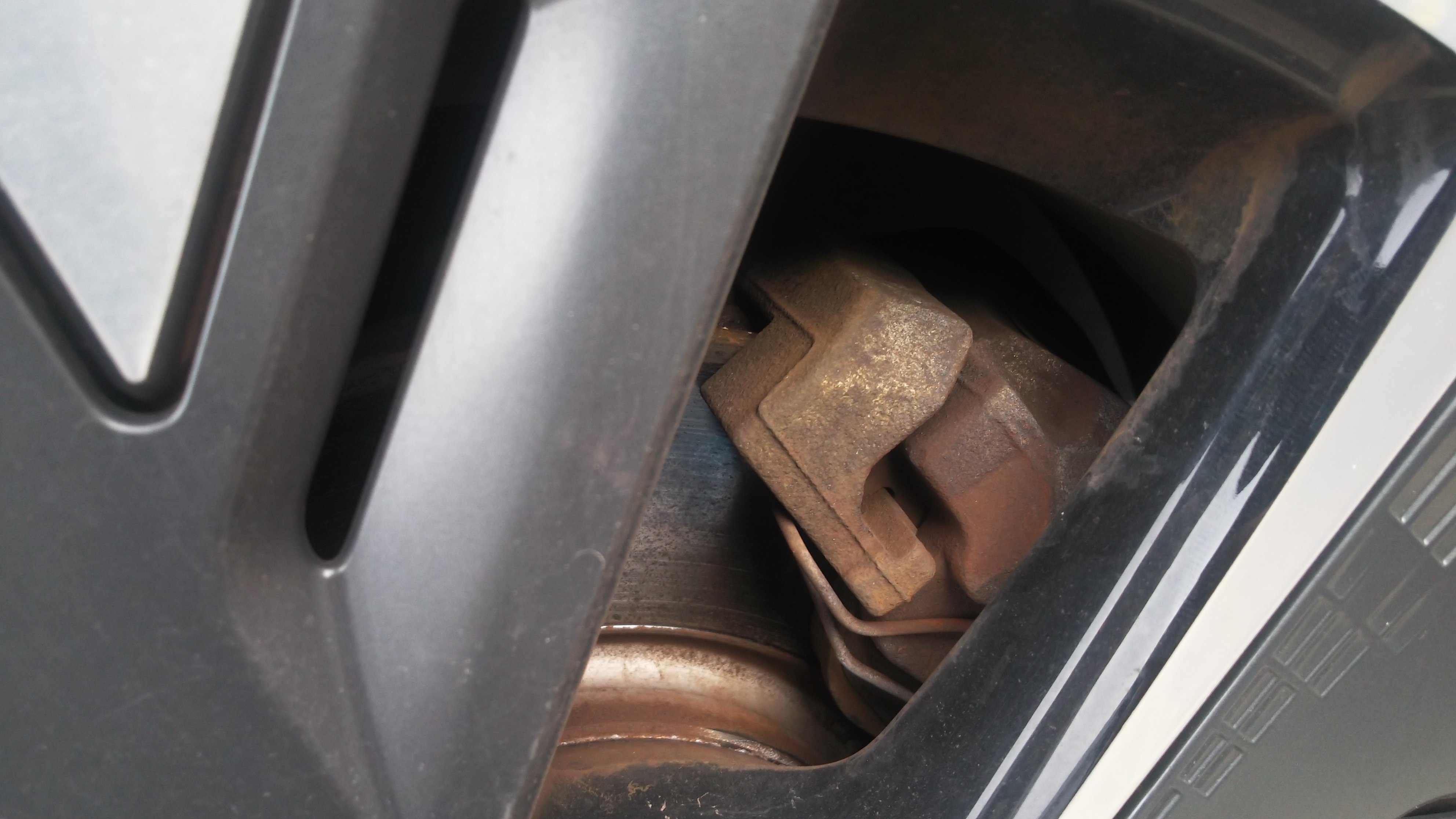

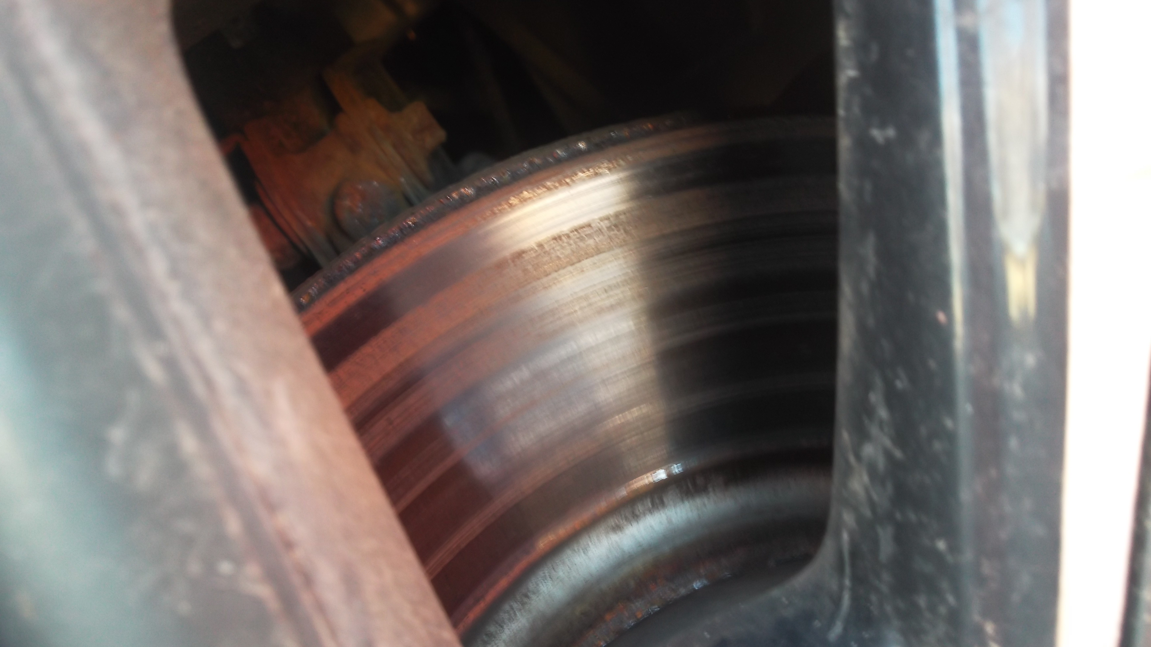

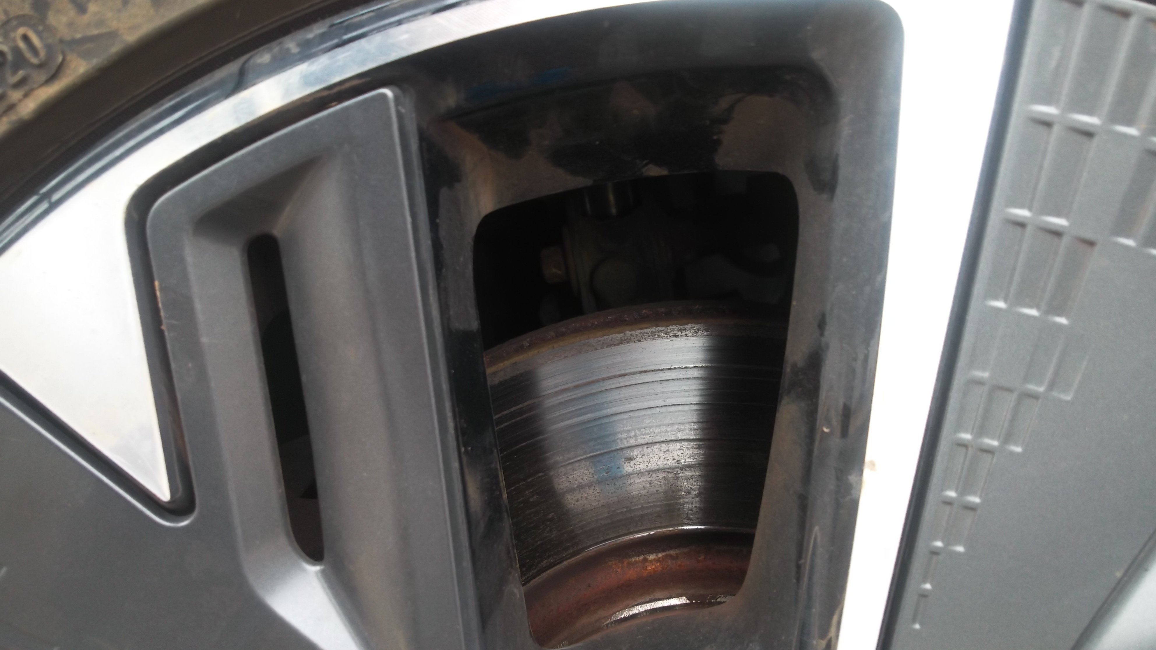

Rear Discs shagged, Pads OK.  They advise replacing.
Front OK need a clean up.  A bit of scoring.   *Actually crap and need more than an Italian Tune Up, or Skimming.*
That is for them To strip & clean.

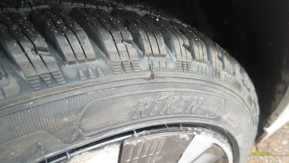

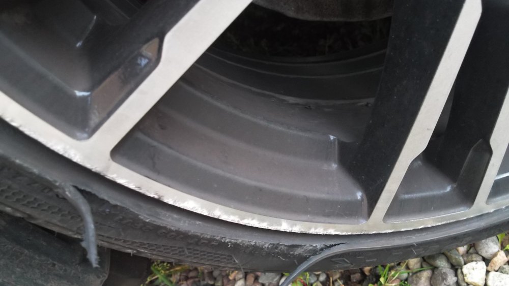

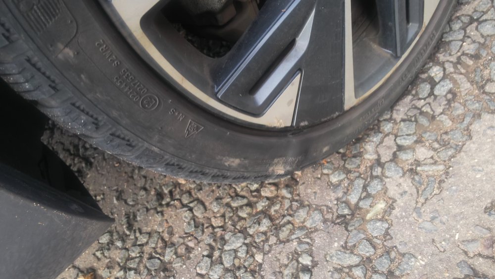

**Should be Michelin Alpin 6 fitted. ** (Not actually OK, there is a cut front drivers side wall which seems to have been missed.)
They are my tyres though and i will deal with.

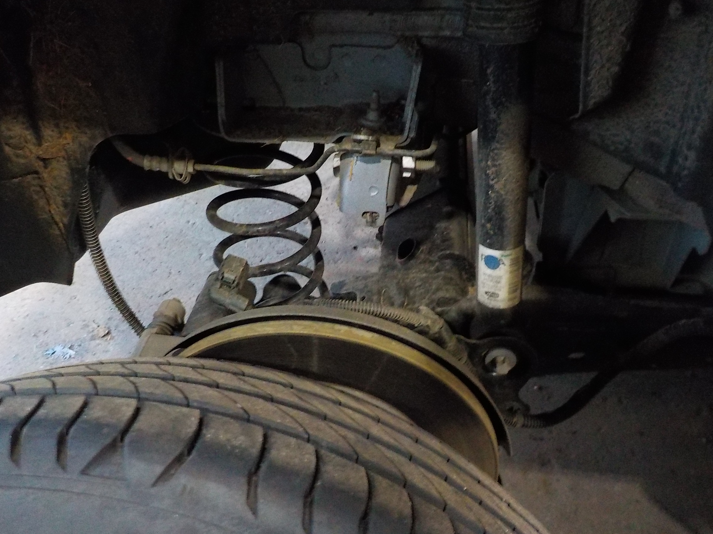

What a rusty mess of a car underneath, but then it is 2 years past August since First Registered and kept outside in Scotland & driven on salted and gritted roads.
It was build nearly a year before registered and then held up pre transit and during transit because of lockdown.
The brakes need serious servicing and replacing of discs and as for suspension parts they will be interesting to see in 10 months time when in for a MOT.
There is a lot to be said for rear drum brakes on an EV.

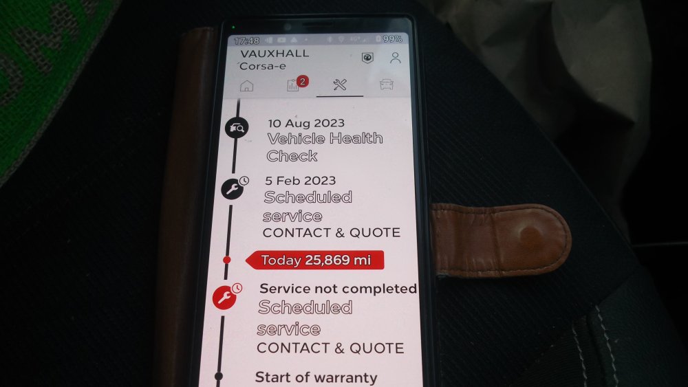

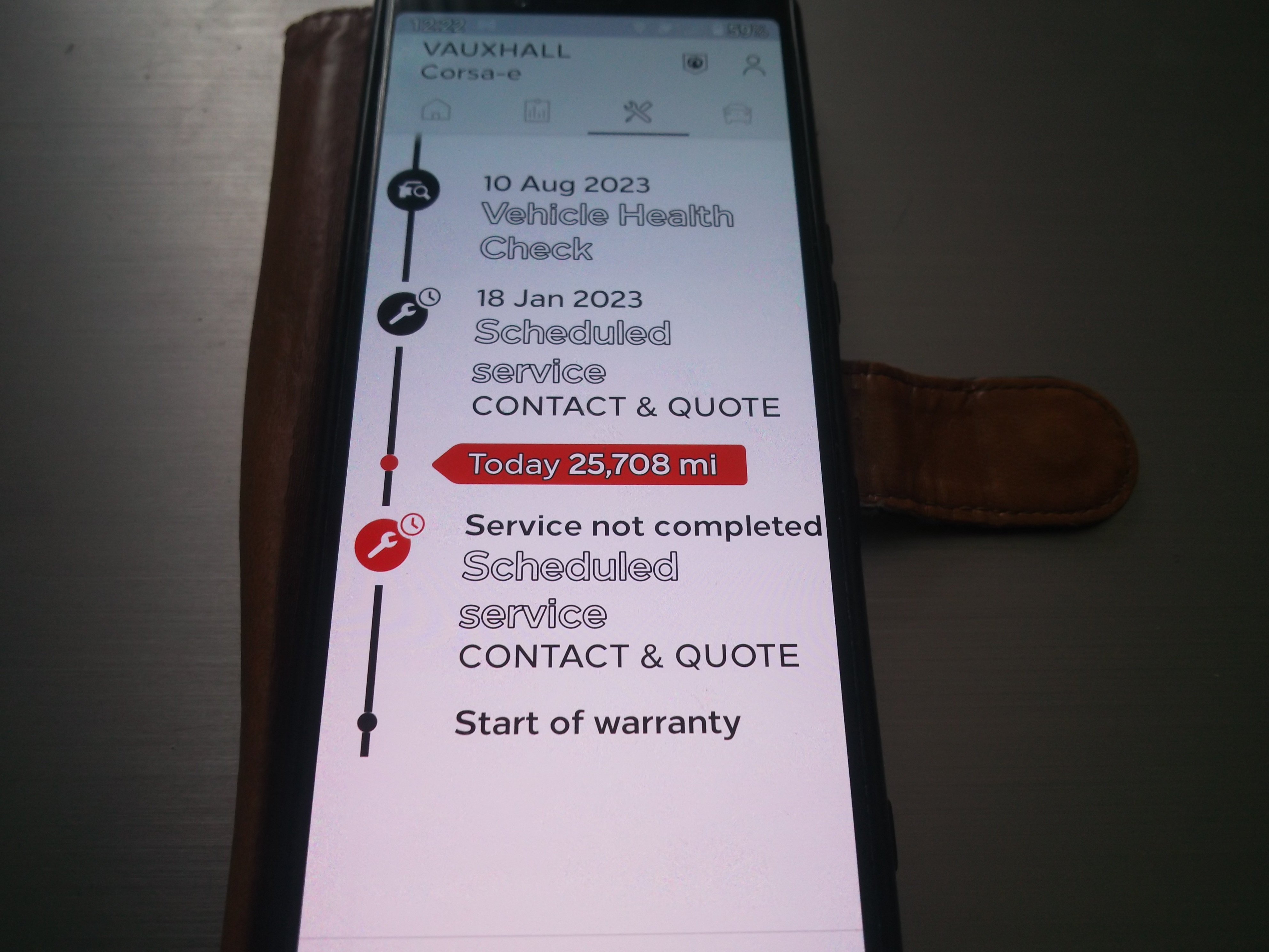

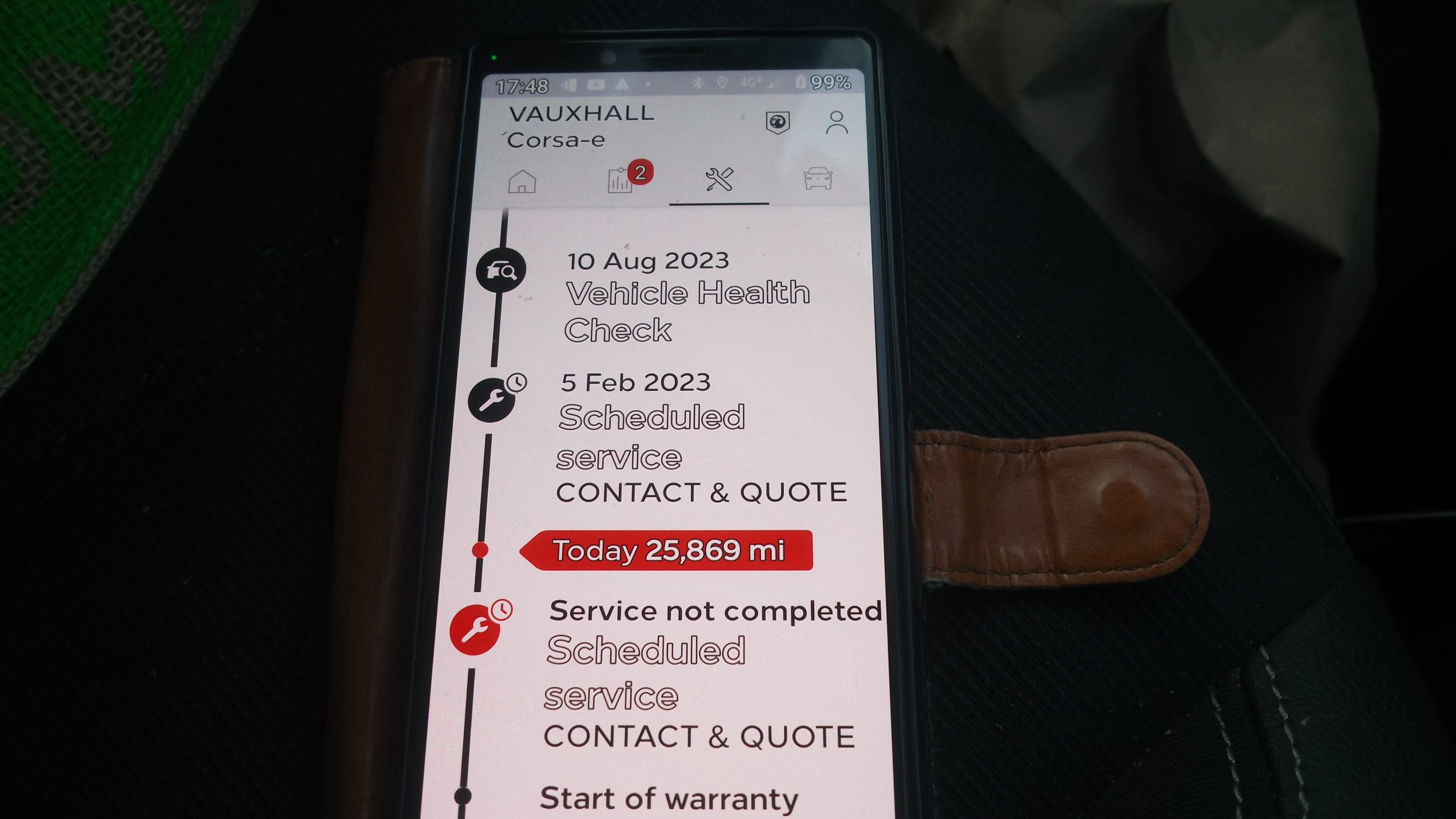

So the car has actually done 35,869 miles.
At 25,000 miles the milometer went back to 12,500 overnight with an update. Then another time near 10,000 just went after the screen blacking for hours.
I find it hard to believe any software update was done successfully.
Odd readings now on the power use.
**Service indicator not reset**  as far as showing on the App that has the wrong miles on the different pages and then the cars miles.

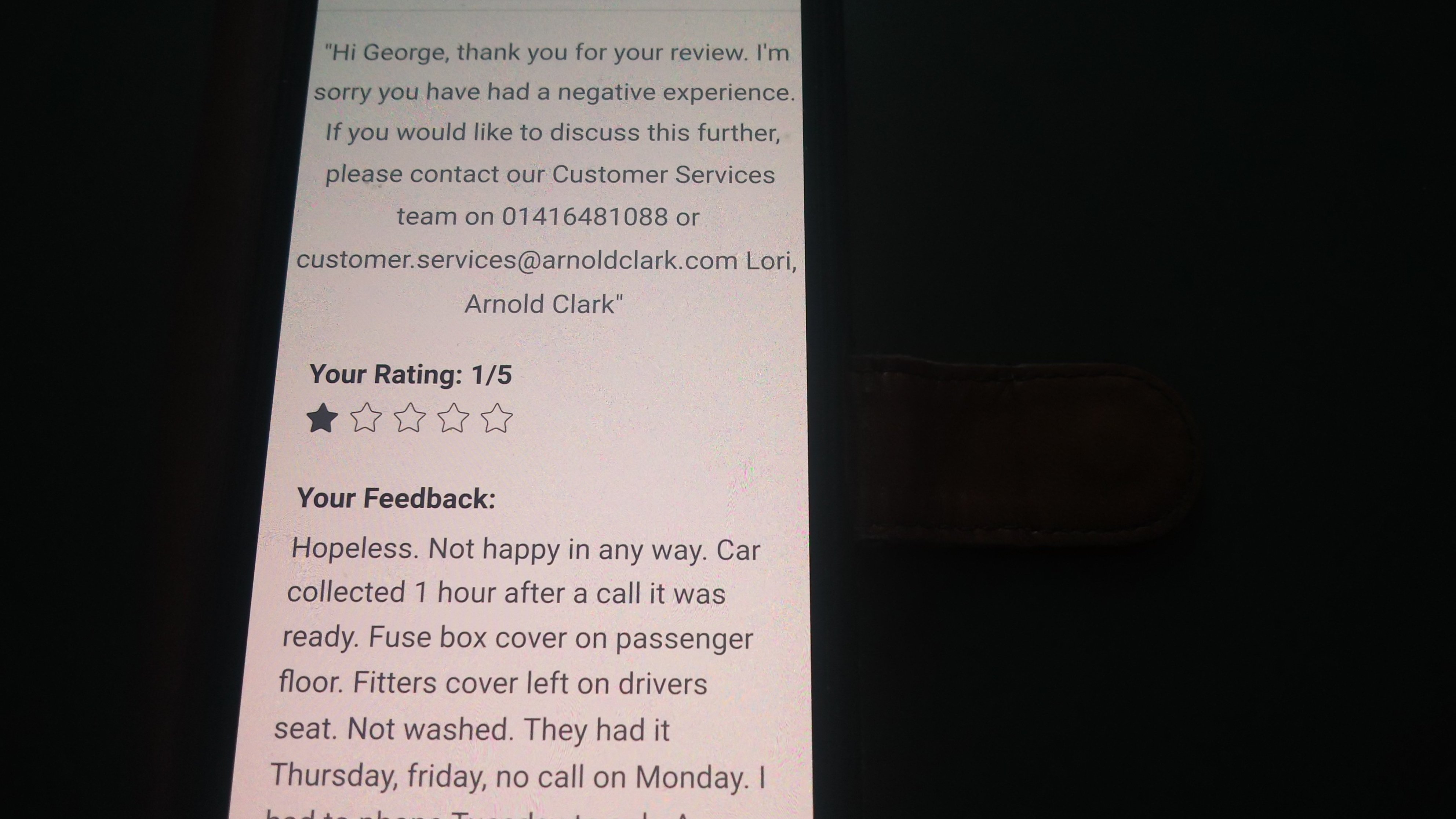

Car not washed even though i was there 1 hour after i was called to say car was ready.
Fuse Cover was on the passenger floor not put back on, glove compartment lid left open, plastic disposable cover left on seat, dirty paper floor cover left and drivers seat fully forward as some short arse had left it.
Waiting on the customer service survey.  I could not be bothered going in to talk with the morons.

So i got a call from the Branch Manager.
A nice call with him apologising for my disappointing experience with the Servicing at the branch.
Seemingly there has been discussions regarding what i put in the customer survey.
Things clearly went wrong at various stages from the booking to the collection of the dirty car which was not ready for collection really.
(I am to blame for the dirty car being handed over when it is going in for an inspection, but it was horrible weather and dirty country roads taking the car in.
that is my excuse, normally i hand in clean cars and say do not wash them.)
So someone might have had their ear chewed, and maybe really the staff have been told to get their act together.
Then there is the fact that they have Corsa Electrics as Courtesy Cars and there was no need for all the nonsense with Motability getting the RAC to arrange a Europcar Hire car for 7 days from Perth delivered to Dundee.   (Or RSA the insurers for Motability calling me to see what accident i was in that required them to provide a hire car.)
Now waiting or still waiting on Motability responding to the Survey they sent me & which i responded to, then there is the one that Vauxhall sent to me on the performance of their Dealers and the cars.
Maybe my language was a bit too explicit for them.

The new discs fitted back in September are as one might expect on salted roads and not used that much as the regen does the slowing down.
The e-brake sticks at every release / moving off, and the brakes do grind.  That will be the grit / salt causing the grooves.
EV's with Drums on the rear is Simply Clever...

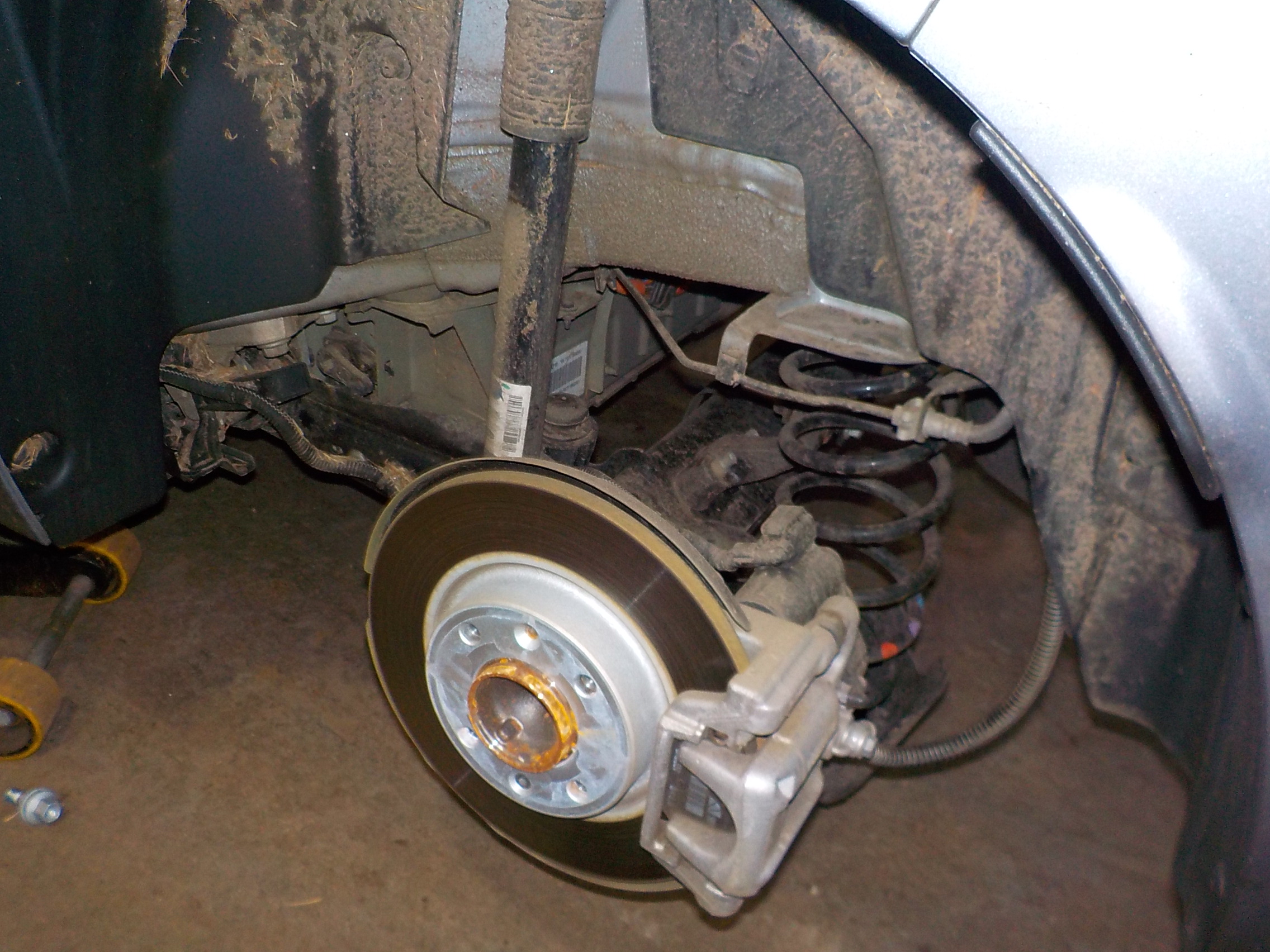

This is what the suspension was like when nearly new.
The springs are just like dead now.
I can't quite work out where the top mount is for the spring in the second picture - it's probably just the angle.
In the first picture one can clearly see the L shaped platform.
