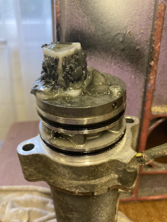

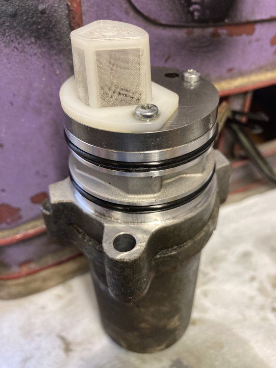

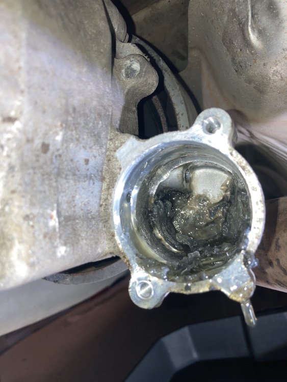

If he made the mistake that I and I believe many others have he will have drained the diff oil and tried to refill the Haldex only to find that it would take barely any oil, thus leaving the differential dry of oil except what was clinging to the CW&P.
Because I had removed the Haldex pump to clean the filter (which the main stealers dont do) then it had lost a quantity of oil by doing so, therefore when I went to refill I did get some fluid in, just not as much as the stated quantity, and as ever on t'internet various quantities were quoted, I did not twig to what was going on, in the past when I was regularly working on cars I would have recognised that what I had drained was diff oil but they smell very different now and are much thinner, in hindsight the big clue was that it was very very clean.
