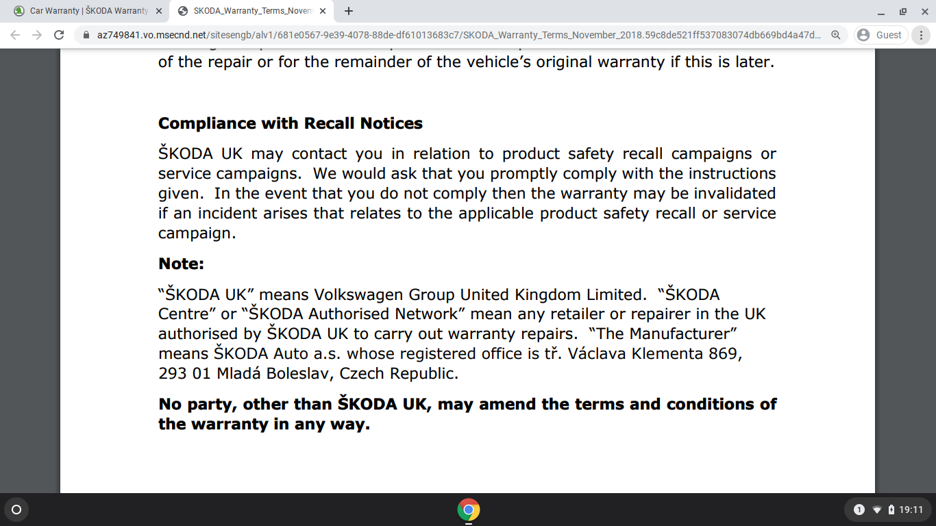

14 hours ago, e-Roottoot said:
A solicitor could make them weep.   This can not have them do faulty work on a customers car and then penalise the customer.
They have never compensated in the UK those that were mislead by Defeat Devices installed on their vehicles.
A 2014 car is not in Warranty so you are not making a warranty claim, just a claim against their employees error possibly.

3 minutes ago, J.R. said:
Then they have you by the balls. A shame as you started out so well.
Well yes, Skoda UK and Main dealer were my first port of call...Wishful thinking to my detriment and horror.
It's only a car, my health is more important...I have to consider diesel gate too.
Regards

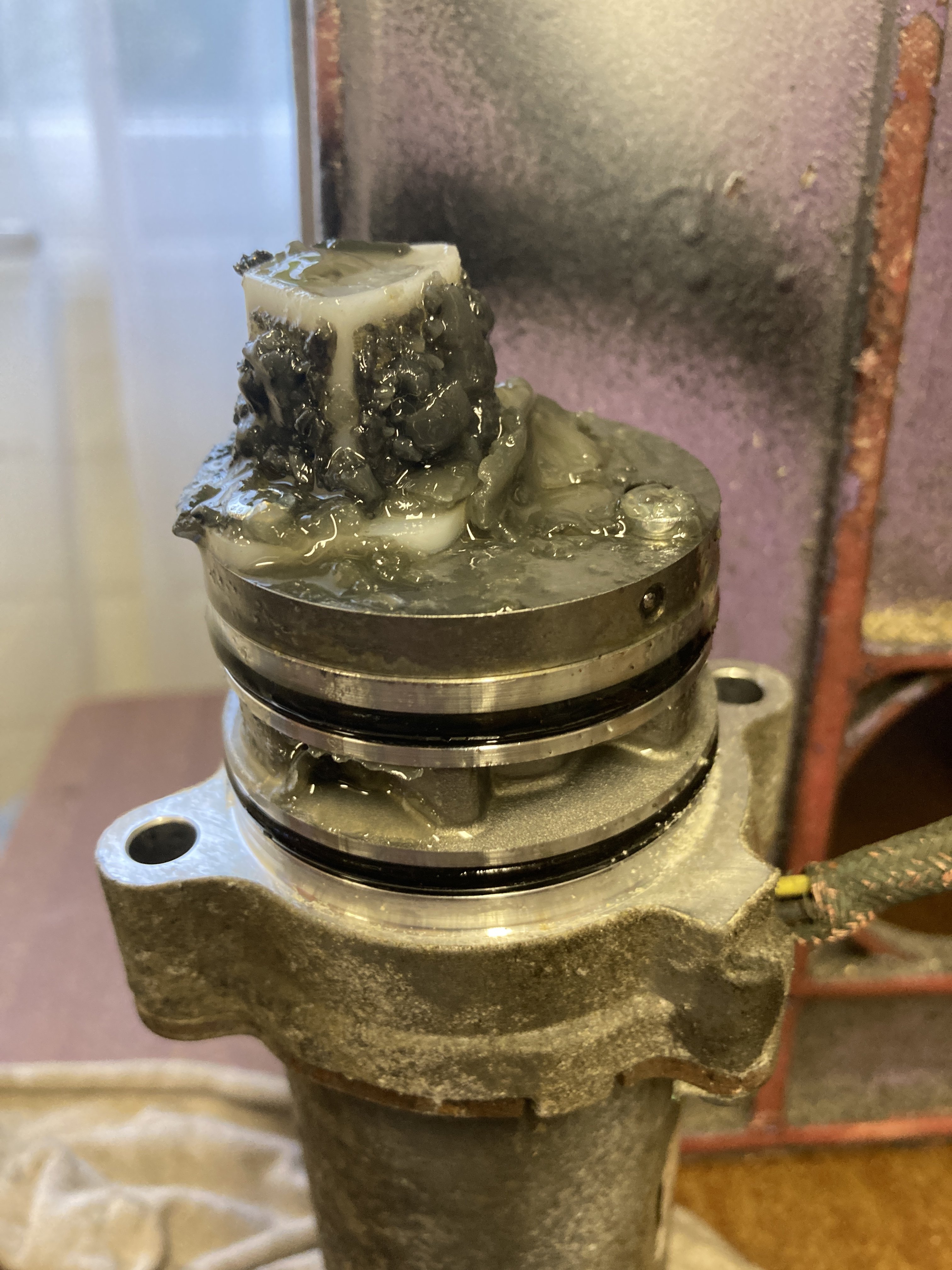

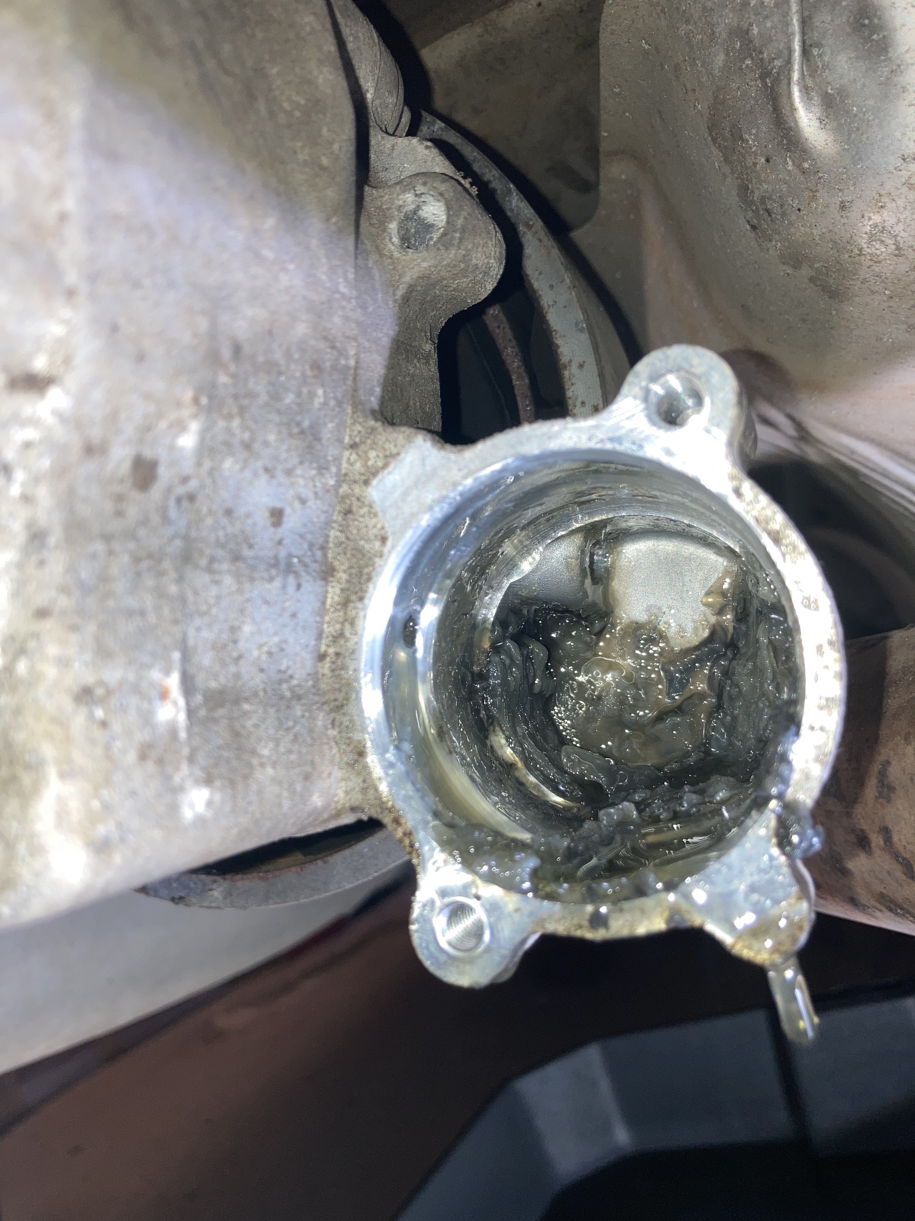

I’d just like to add my thanks to everyone who has posted on this Haldex thread and the other ones with all the helpful info and advice – and especially for the heads up on cleaning the pump filter on the Haldex 5 unit.
I asked Allams to do the oil change at 3 years (47k miles). It wasn’t on their to do list as standard service items. At 6 years I assumed the dealer at MK would do it (and I forgot to check beforehand) and it wasn’t done, so it was on my to do list.
Then I read the pump filer cleaning info and that became a high priority now being 6.5 years and 88k miles.
I bought the service kit from  haldexrepairs.co.uk and I’m well impressed with their service and the info on their website.
Yesterday, I jacked the Yeti up (many jacks and axles stands) and got on with the task. Probably the most difficult job is undoing the adult-proof pump harness plug from the controller… Yes, I watched all the videos but it’s still impossible! In the end, I unbolted the controller and that made it all possible.
The oil looked pretty clean as it drained out and I wasn’t expecting to see the pump filter (and pump housing) in the condition they were – a sort of congealed mess covering at least 80% of the filter.
How well it was working, who know. I ran a VCDS check before and after as well as the ‘pump learn’ program from VCDS.
I don’t blame the dealers – the manual doesn’t tell them to pull the pump and clean the filter but it certainly should. I am surprised the dealers don’t even have the oil change on their radar – but then, MK told me my Citigo cambelt change was due (it doesn’t get replaced according to the Skoda manual), failed the MOT on it for having the headlights too low (then they found the headlight adjuster on the dash) and told me the wheel bolts ‘won’t tighten, they just keep turning because there’s copper grease on them’…. I won’t be going back there.

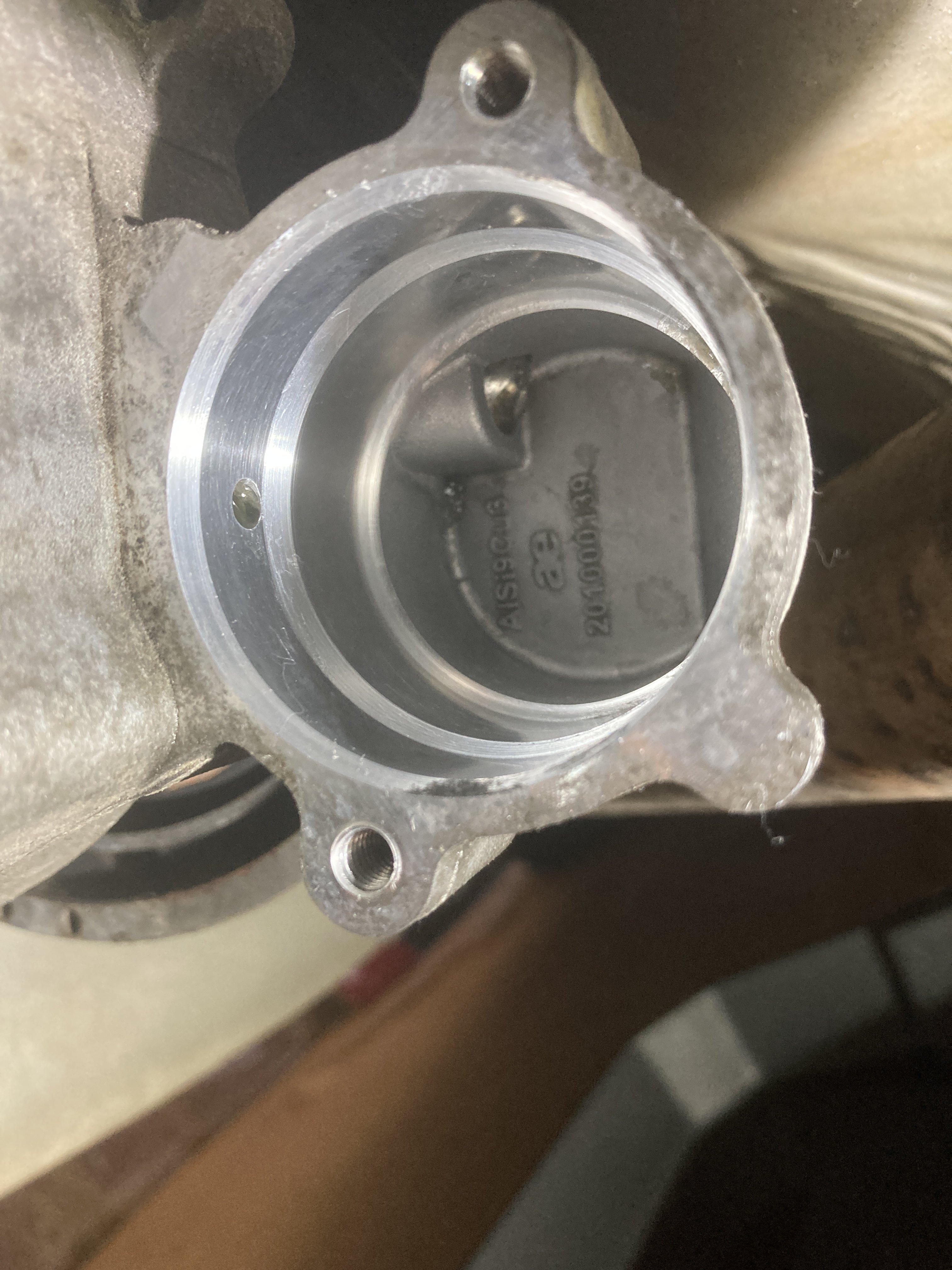

Anyway, thanks again for the wealth of good info once again on Briskoda. I took a load of pictures and will write up a bit on how I did it in case it’s of use to other Haldex V owners.
And after cleaning....
