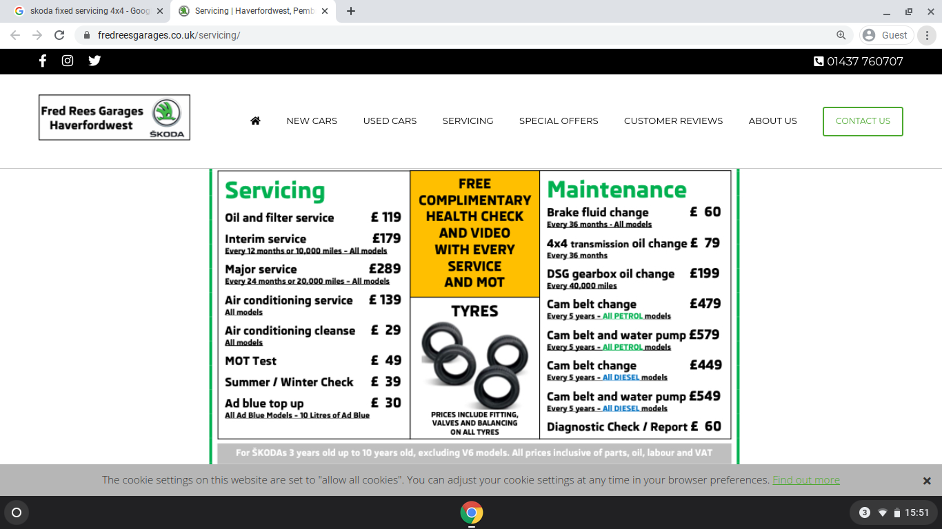

Not only is the Haldex Oil change due at 3 years.  You want to know it is not just the oil being changed.
It is not 30,000 miles, but some need doing before 3 years or 30,000 miles.
Especially if your car is a keeper.
The Brake Fluid is first due @ 3 years then each 2.
It can be checked for H2o content.
The A/C service is up to yourself if you want doing.
