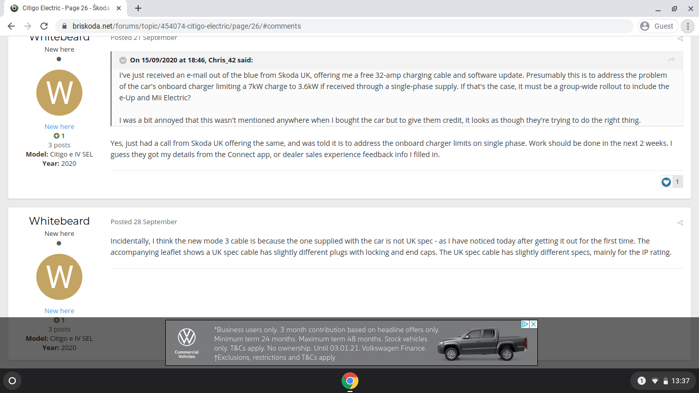

Just contact Skoda UK Customer Services and ask them to get an Adult that knows about it or even a young child to get back in touch with you.
http://skoda.co.uk/discover/contact-us
Your local Dealership or the one that supplied the car must have someone in the Service Department or the Workshop that can read the TPI they got from Skoda or if not can use a keyboard or telephone and talk to an appropriate person @ Skoda UK.
Edited by e-Roottoot

This is interesting, and explains why the cable is changed:
Edited by john999boy
Invalid link
Sorry, wrong link and I can't find the edit feature!
Correct link:
Thanks for posting this - they are making a real song and dance about it at the dealership and have said I won't get the car back until Tuesday at the earliest!
