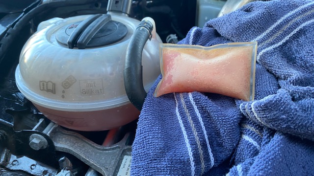

Thank you so much Gaz, your encouragement and advice helped me to remove the silica bag from the Coolant Reservoir.
I'm now thankfully clear of this 'ticking time bomb'.
Mit Silikat? - nicht jetzt!

I know I should have filmed the process! But remove your tank in case you split the bag and then you can be as rough as you like!
HTH, Nick

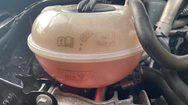

Does anyone know when the redesign was done. I have a 67 plate 1.4 TSI SEL DSG, will it have a silicate bag and is it likely to cause an issue.
Have a look under the bonnet, if it says "Mit Silikat" then it has the Silicate Bag, my 2015 TDI and the missus 2019 Petrol both have it.
My 2017 vRS 245 had the bag in.

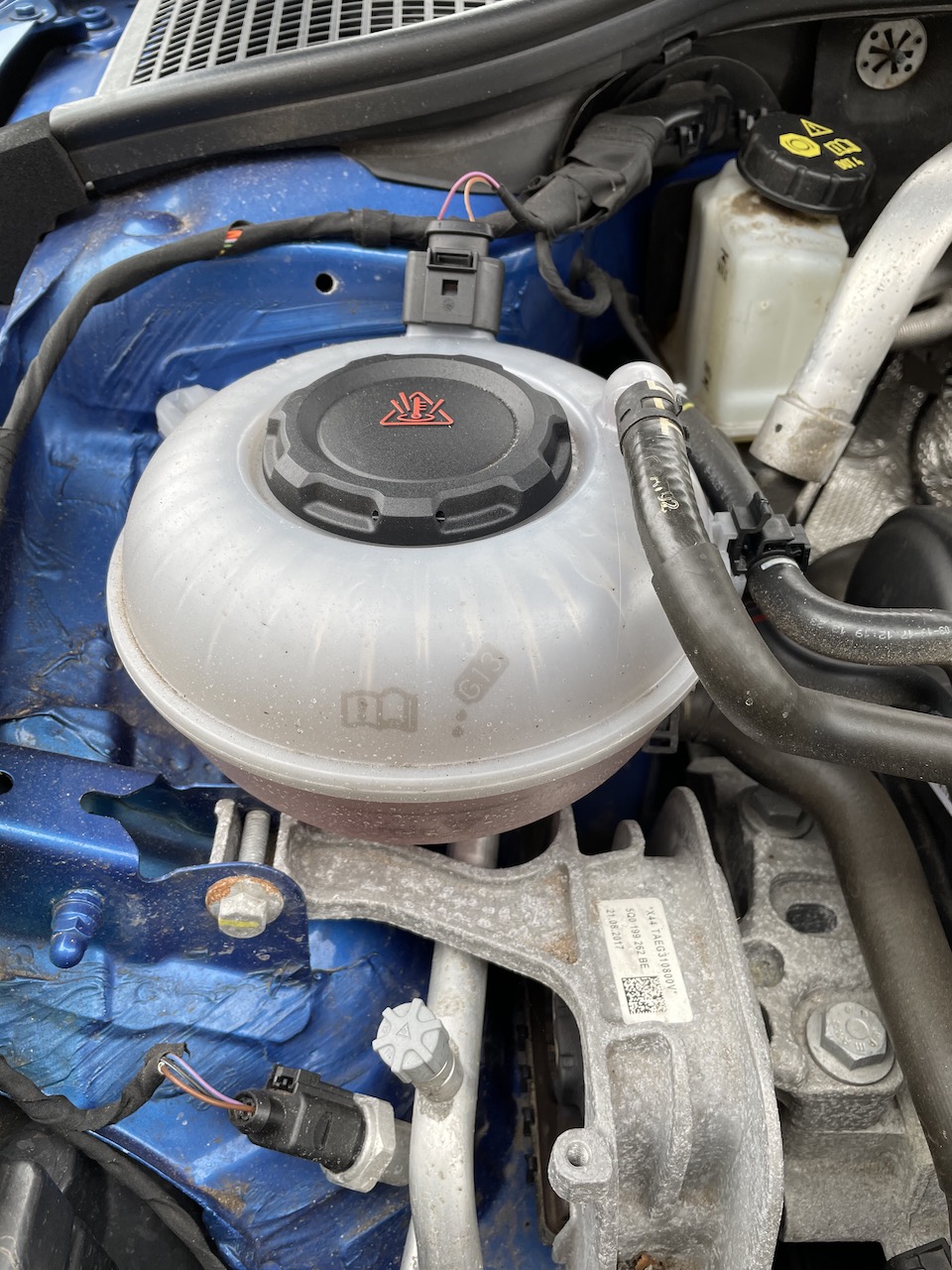

This is mine from a 67 plate 1.4TSI DSG. No mention of "Mit Silicate" on the body, so is this the new double walled unit.
I replaced the coolant tank on my vRS for the current, bagless version a month ago, the silica bag was intact in the old double walled one, but I did notice that there is only a single seam sealing the bag at each end, and the seam did look tired or perhaps not very well made at one corner.  The whole bag idea would probably have worked very well with double seam, but I bet this stood in the way of profit...
Another annoying tidbit is that the coolant cap costs as much as the coolant tank at Skoda, I guess I could have reused the old cap but why charge so much for it?
G12++  from now on... after I run out of G13 that is, until then 50% mix G12++ / G13  mixed with water 35:65 and partly flushed every couple years to keep water pump happy and the oil cool enough on autobahn runs.
This is the one you want to have, single or double walled doesn't matter if it doesn't say "Mit Silikat" then it doesn't have the silica bag.
There are single and double walled versions with Mit Silikat written on them and these aren't necessarily bad, just that the silica bag could potentially burst and empty the crystals into the cooling system leading to an expensive system flush and more than likely a blocked heater matrix.
