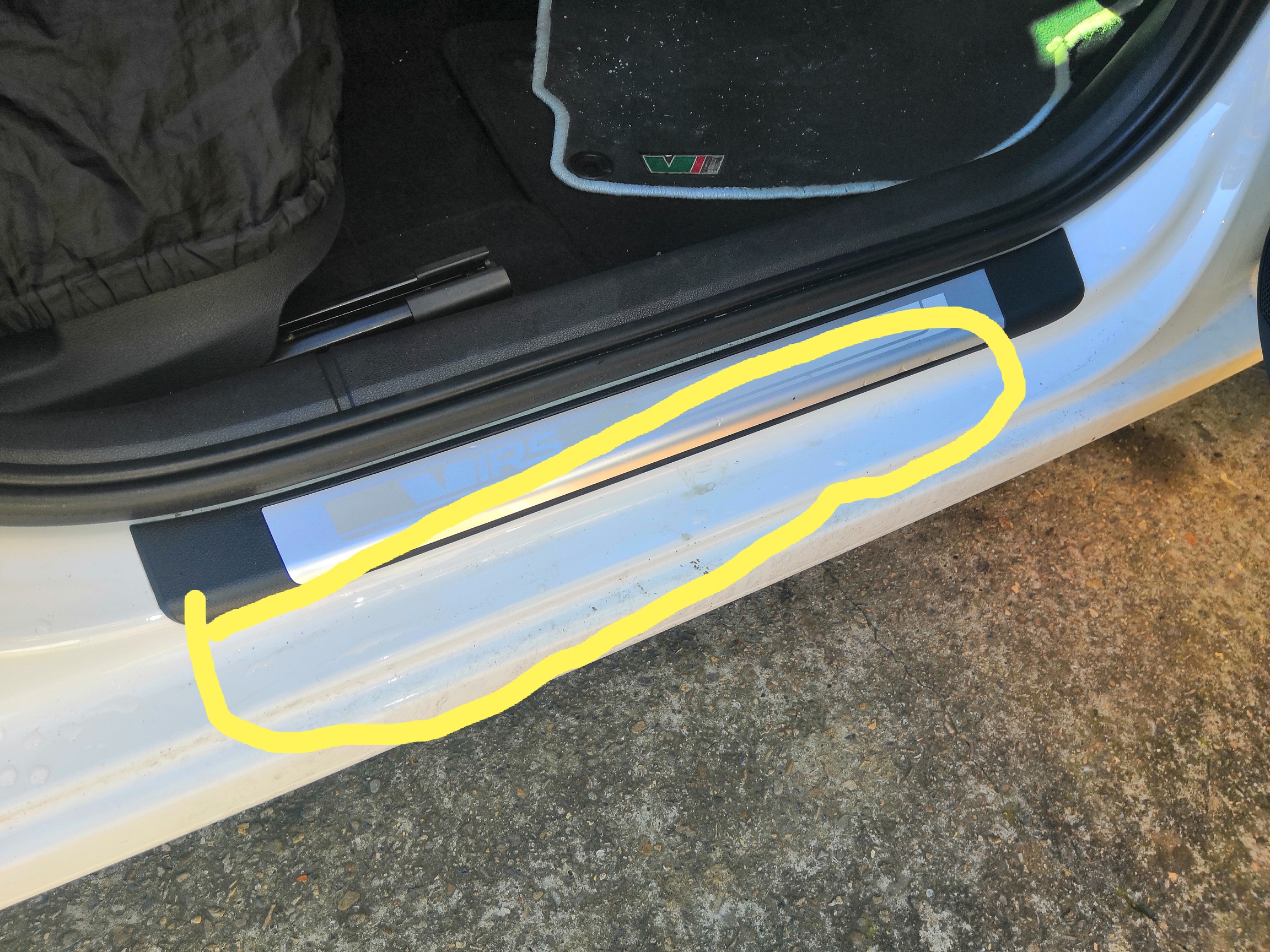

It's a 2014 car so relatively early production. I've been and had a look at the seals on the driver's door today and there is only one hole at the bottom of the seal towards the front of the door (parallel to the speaker grille). Just wondering ndering if some modifications to the seal - i.e. more holes might help?
there is obviously water trapping there as there was a thin sheet of ice around the sill last night at the area pictured (excuse photo editing on phone)
2014 is before the revised door seals were introduced so that may be a primary factor:
