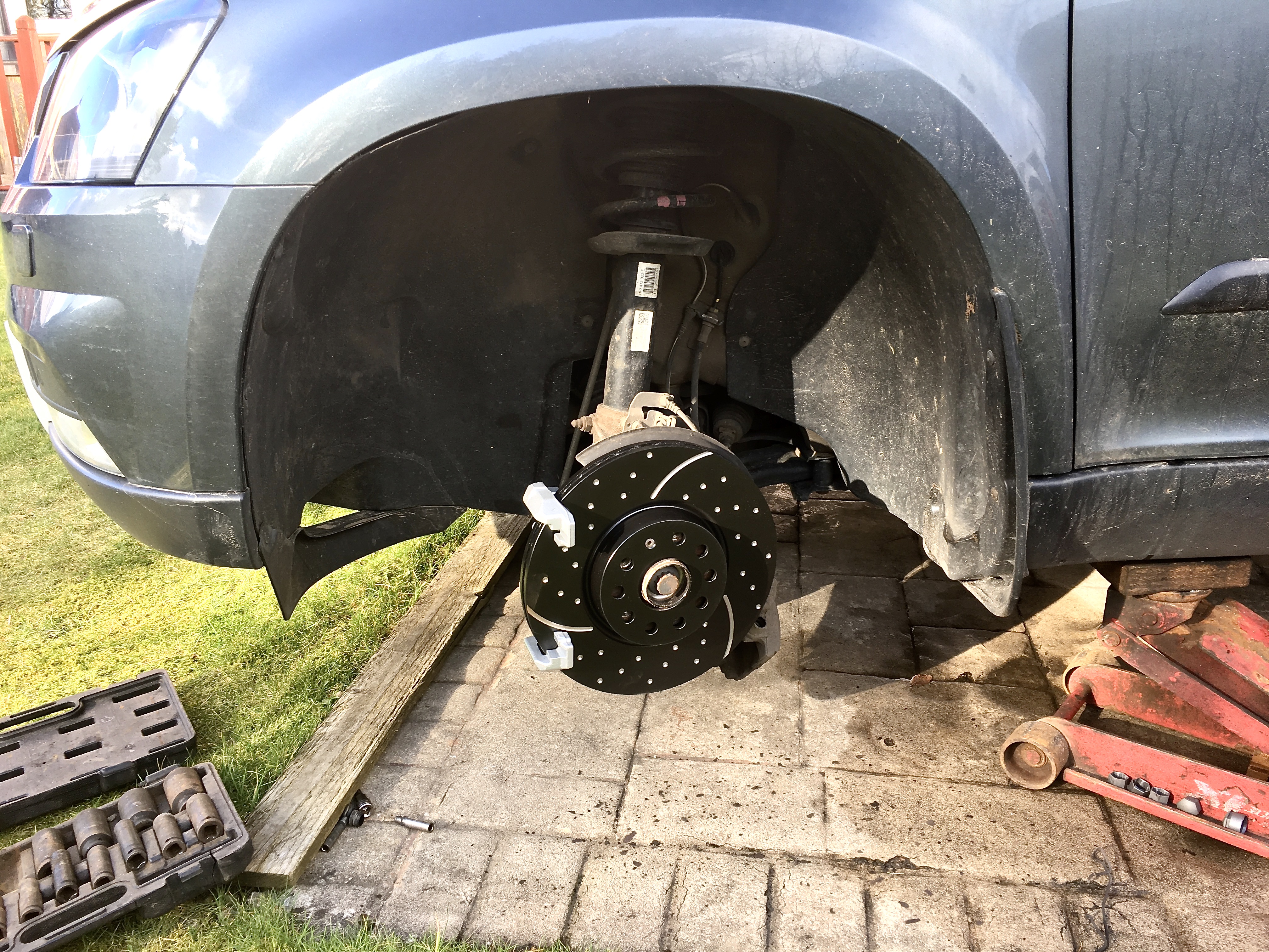

I felt the brakes were not up to much when I got the Yeti having come from an  Octavia vRs
So I swapped to the larger discs, and the problem went away.  Three years later all is still fine.
I have the smaller diameter suspension struts so they will also need changing or I will need spacers.
