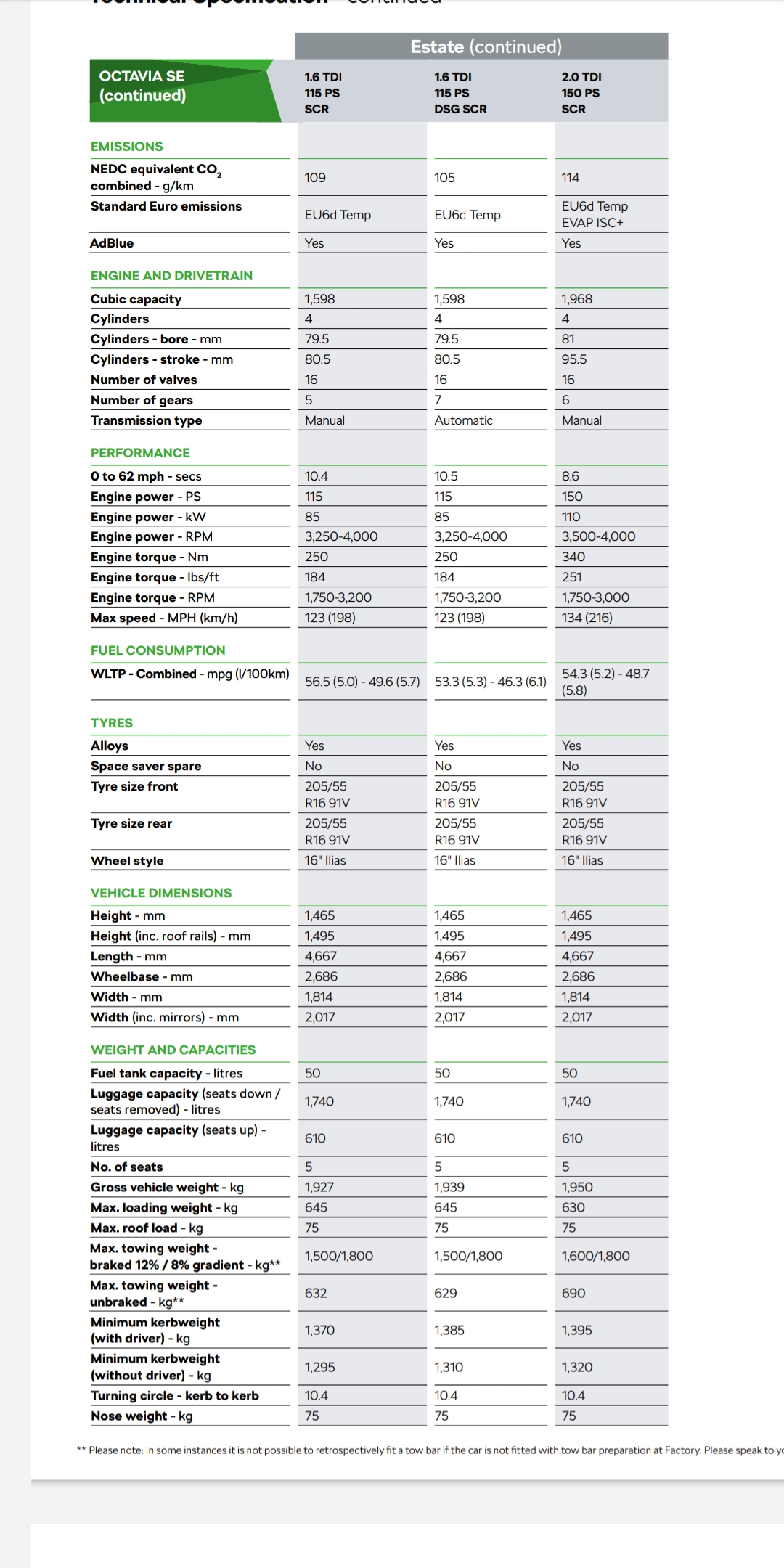

According to the attached the 1.6 TDI 5 speed manual has a 1500kg limit at 12% incline and a 1800kg limit at 8%.
You're 400kg off the lowest value at your caravans MTPLM.
Who else could validate the cooling and gearbox upgrades needed? An alternative, because you're way off the max weights, could be to change the gearbox oil more frequently.
And accept the fact the clutch will be wearing faster whilst towing. I do, as my van is 1420kg max laden. I've also had to start from a standstill on a 16% incline 😳

Thanks swirly182.
I do note the ** against towing weight of "Please note in some instances it is not possible to retrospectively fit a tow bar if is not fitted with towing prep at Factory"
That sounds like covering their backsides to me.
I guess I need to see the VIN plate / V5 of the actual vehicle and see what it says there. If it lists a suitable towing weight then I take it at face value and get a 3rd party tow bar fitted.
