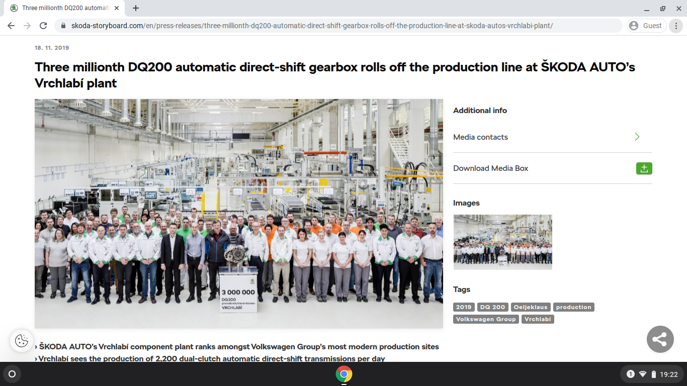

Skoda manufacture 2,200 or more DQ200's a day and that used to be for 48 applications.
If only 22 a day have premature failures, or failure in the warranty period than Skoda admitting to that would be good.
What a shame that Skoda /VW have not the faith in their engineering that these DQ200's which have no Service Schedule /Guidelines or recommendations for services do not get a 120,000 mile / 10 year warranty
& then wet clutch DSG's at least covered for 5 years / 60,000 miles and that being as a minimum of a warranty.
Skoda do 5 year warranties in Australia and i assume that is when serviced to the manufacturers recommendation, or maybe they call it 'schedules'.
3 million DQ200's produced just by Skoda by 2019.
