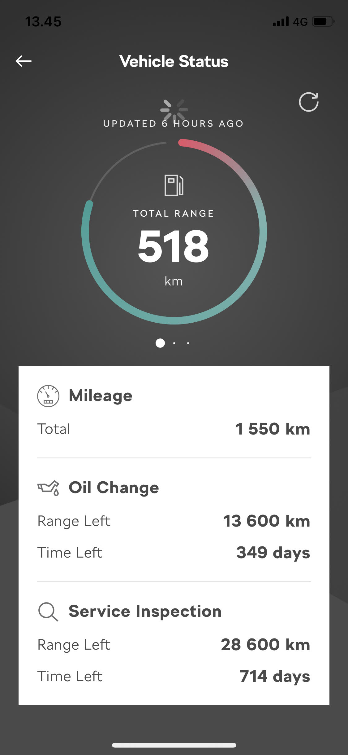

Just looking through the MySkoda app and it is showing an oil change is due in 12,700 miles/418 days and service is due in 19,499 miles/634 days.
When did Skoda start seperating oil changes and services like this?

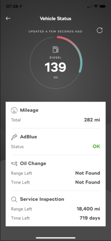

Mine is saying "not found" and I assumed it was was they displayed when on a variable service but it would not tie in with yours...
I think the vehicles are set to the variable' service/oil change interval, using long life oils and sensors to determine when work needs doing. IIRC its up to 2years or 20k miles but may be less based on driving style, loads etc.
Mine shows the same number of days, yet a slightly different mileage for the two items.
@Coume I reckon the Oil Change being 'Not Found' is because you haven't yet done much mileage. A few hundred more and it ought to show up.
@fossman I'm guessing the oil sensors are indicating an oil change ahead of other service items. Such a disparity after a low mileage seems a bit odd though. Perhaps a chat with the dealer to clarify is in order.

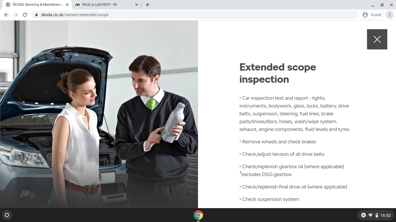

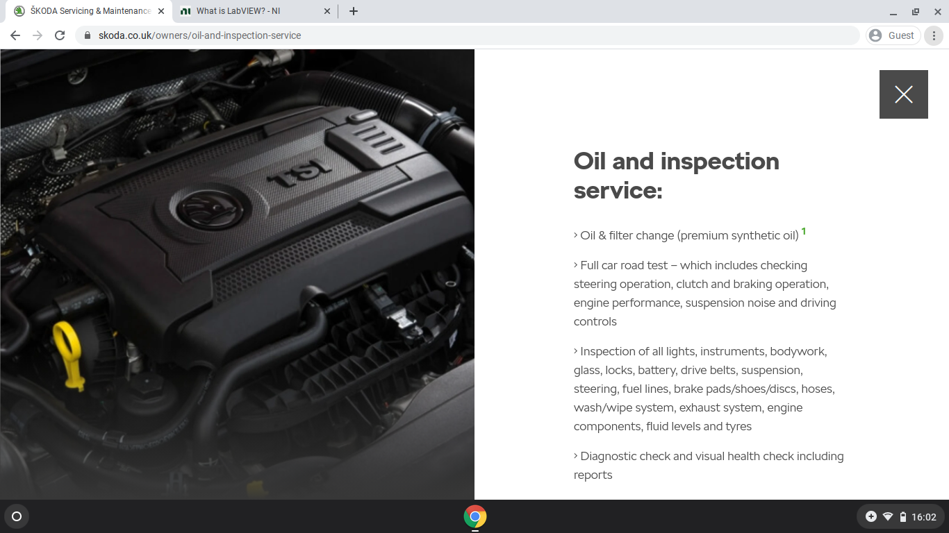

The brochure makes it clear (on page 31 of 33)
If you have variable servicing will be between 9000 and 20,000 miles, or upto 24 months, which comes first.
Looks to me that Op’s car is suggesting new oil at 13,200 miles or 24 months which (unless my maths is dreadful) is between 9000 and 20,000, and not far from midpoint of this range.
