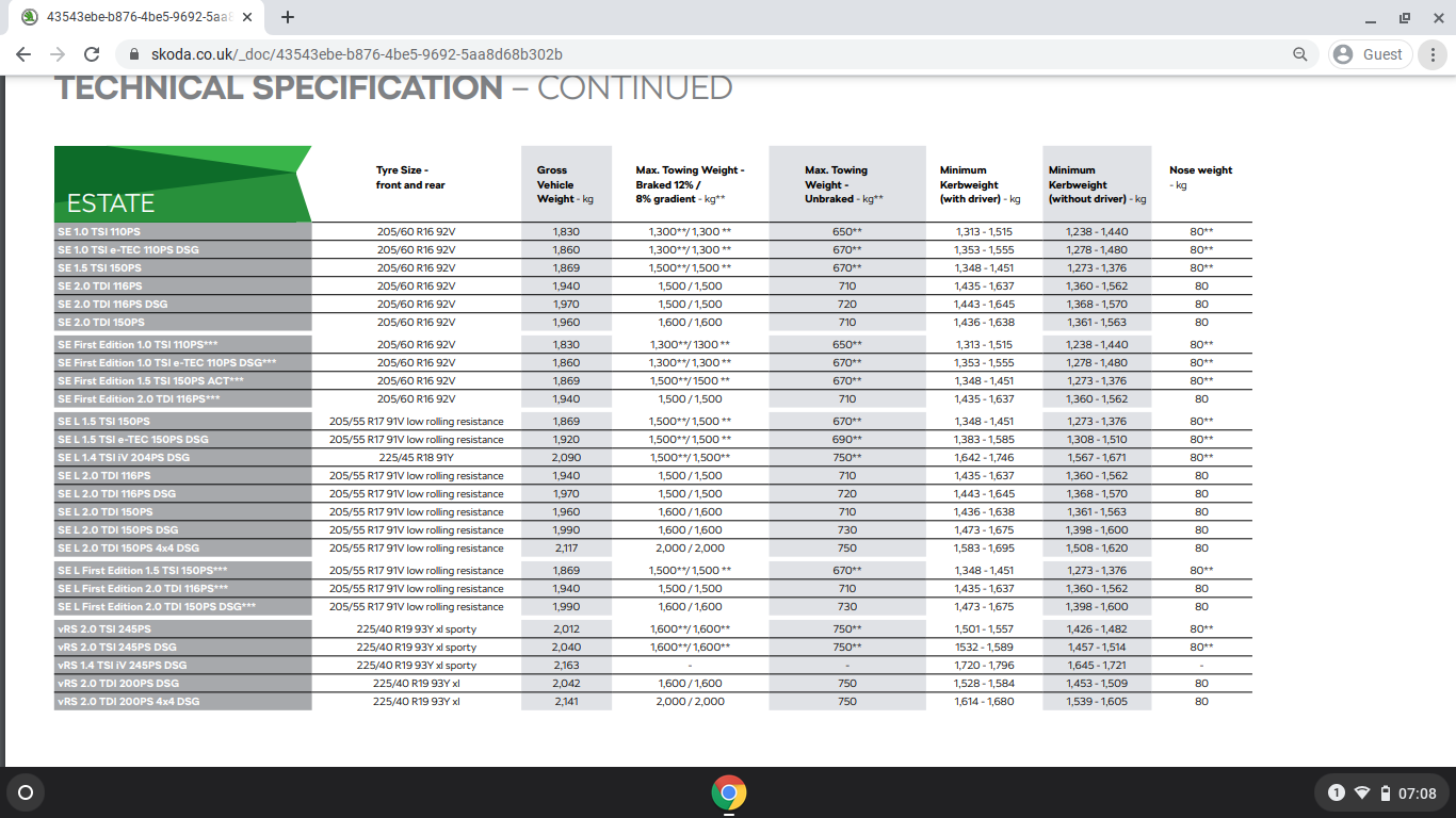

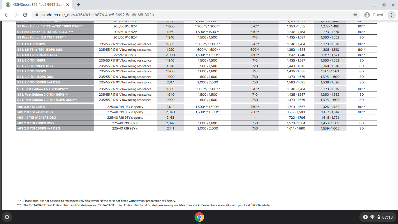

http://briskoda.net/forums/topic/429261-dont-buy-a-201718-150ps-4wd-man-7-seat-if-you-tow
Edited by e-Roottoot

I remember reading that a certain model and spec of the Kodiaq not being suitable for towing (was it the 7 seat with DSG or something). And the MK1 Fabia vRS never got towing approval and also the MK2 Fabia vRS I think.
7 seat manual box Kodiaq. As in a link a few posts up.  There is an example of a Karoq that also is not as approved for towing.  Tow bars / balls can be fitted for carrying cycle racks.
So is yours a iV aviationnut? All the rest say they can tow on the image above

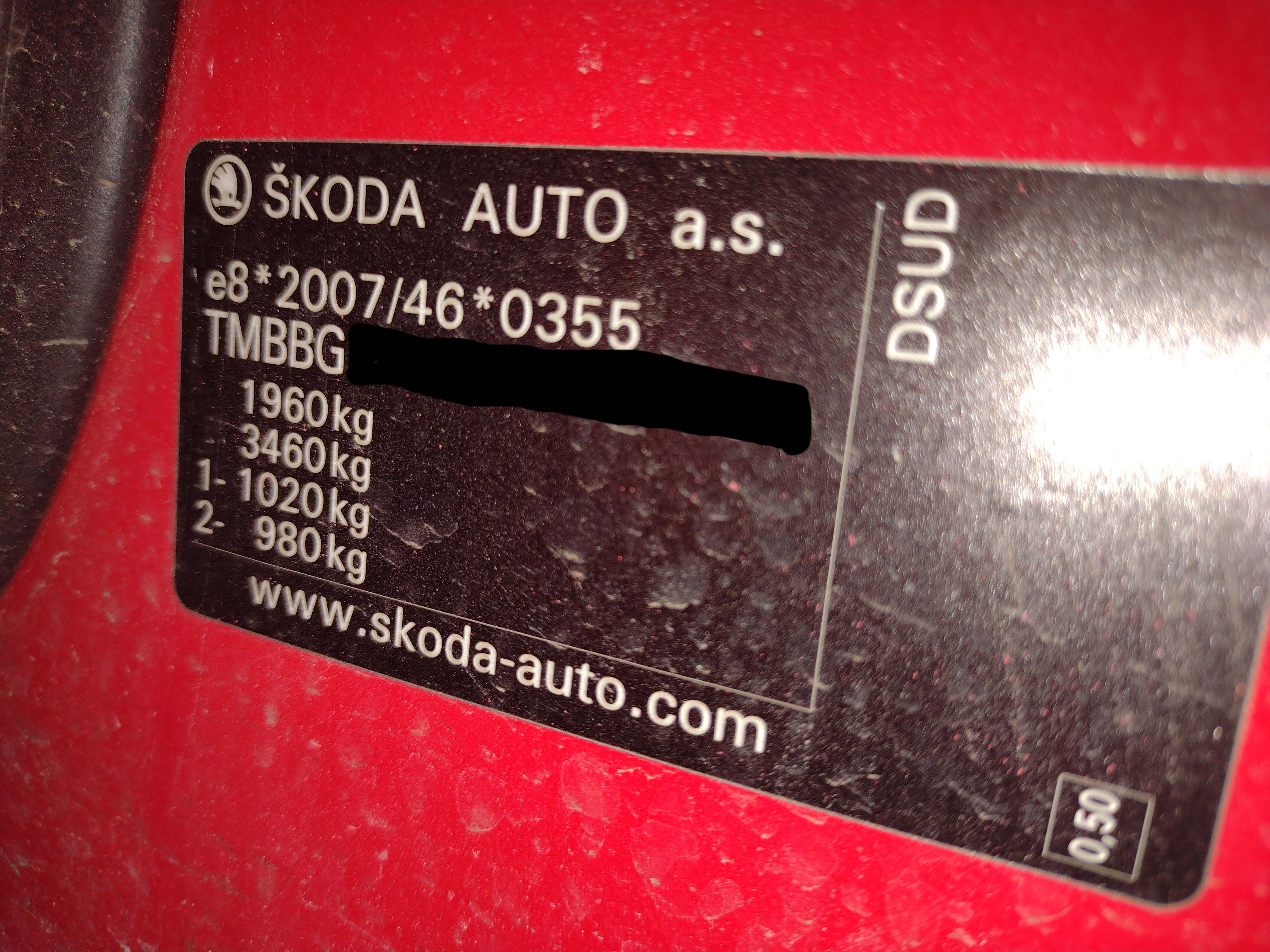

So based upon what I know.  Your plate looks fine.  The second number is the gross train weight and so the difference between that number and the first number is what you are allowed to tow upto (your trailer/ caravans plated weight).
The issue some of seem to have is that we have 0 as the second number.  So we are unsure if legally we are allowed to tow anything.
hopefully I’ve got my understanding correct.

What does your VIN plate state?
Great, many thanks for clarifying that - so I can tow up to 1,500kg which if I apply the 85% rule I heard somewhere gives 1,275kg.  Seems OK as I don't think we'd be getting a massive caravan!
