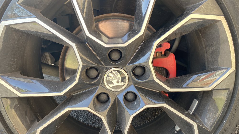

I'm sure the alloy wheels on my VRS must have a locking wheel nut, however, when I look at them, they all look the same (see pic).
There is a wheel nut key in the boot, so where does this fit in?
You are looking at the plastic wheelnut covers and not the wheelnuts, one of them will have a larger diameter, possibly the top one looking at the photo, that will have the locking wheelnut beneath it.

That makes a lot of sense; thank you.

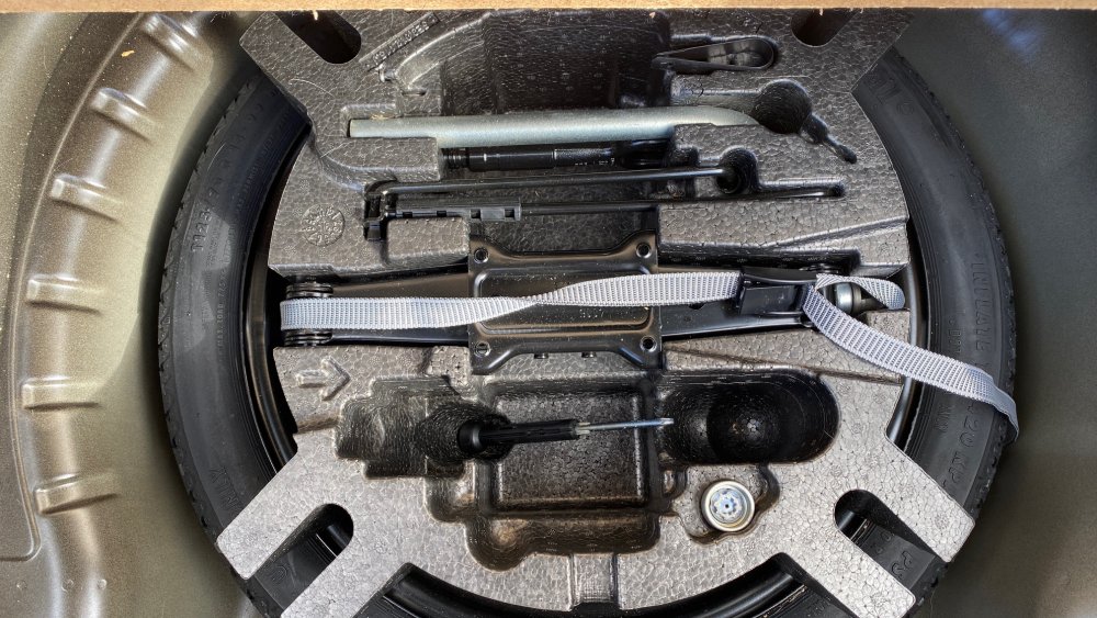

Does it look like I have everything?
Hi Noms, looks like everything is there, including a Torx screwdriver,
Hi N, yes yes, you've got everything, but have you located the locking wheel nut on the wheels?
The cover for the locking wheel nut is easy to spot, its round, they were on mine.
